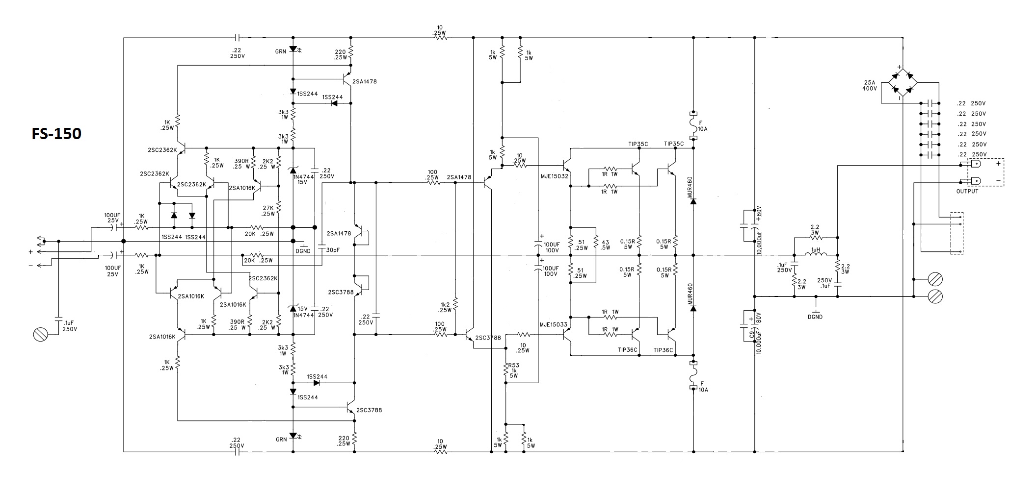

Diamond Differential Amplifier
FS150

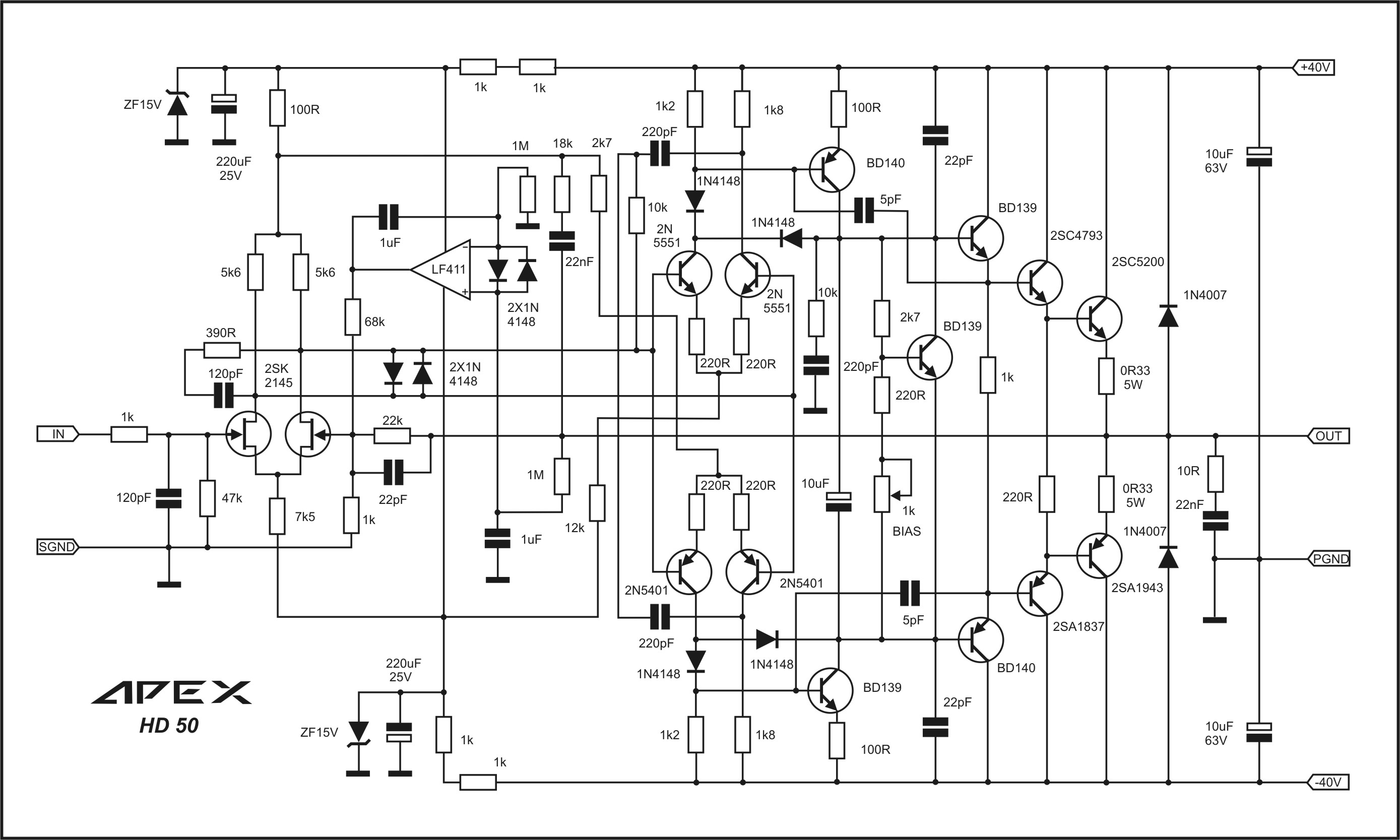

This is new concept? or tested design?
Trying to put Sansui out of Business :) Old Sanyo transistor, diode part numbers, MJE1503x, TIP35 o/p's, different combo :)
Once simulated the AU-X11 design in ltspice, it can have stability issues.
Worked on a AU-X901, last year, it was balanced drive to a floating speaker, nice control over driving a speaker. good sound quality. A few offset/gain adjustments, used a transformer for headphones :) Good luck
