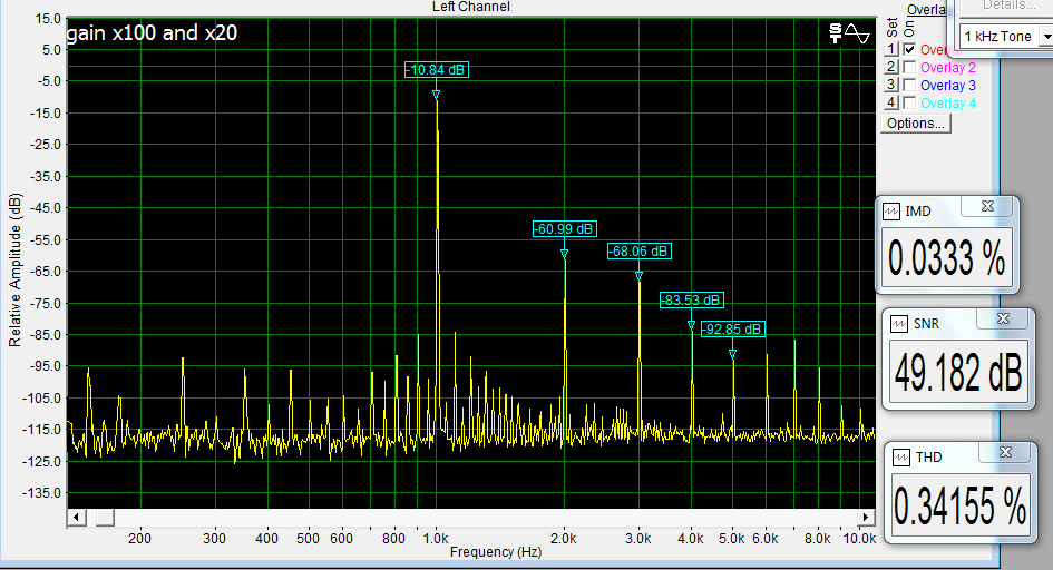

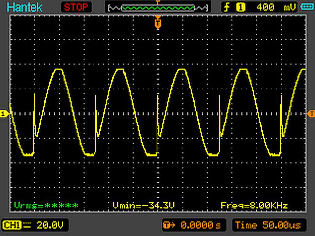

I have changed gain to x100 and x20 but I am getting very bad results (somethink I am doing wrong). Basicly with high gain at front stage there is very difficult to stabilise the circuit.
Another think is - clipping at higher than 4k frequencies, there are spikes present on sine and very high current spikes. Thats a pitty cause amp is playing really nice.
What is interesting, the spikes are present on symulation too. But version with cascaded vas hasnt got that problem. So I will prepare board with cascaded vas.

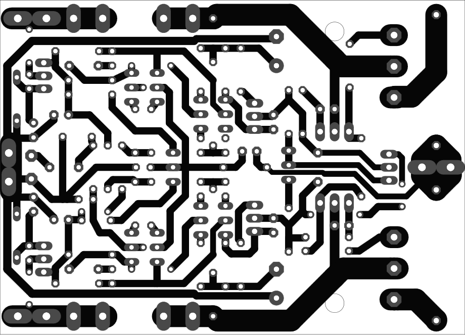

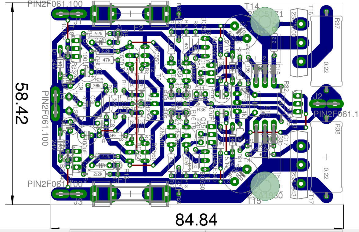

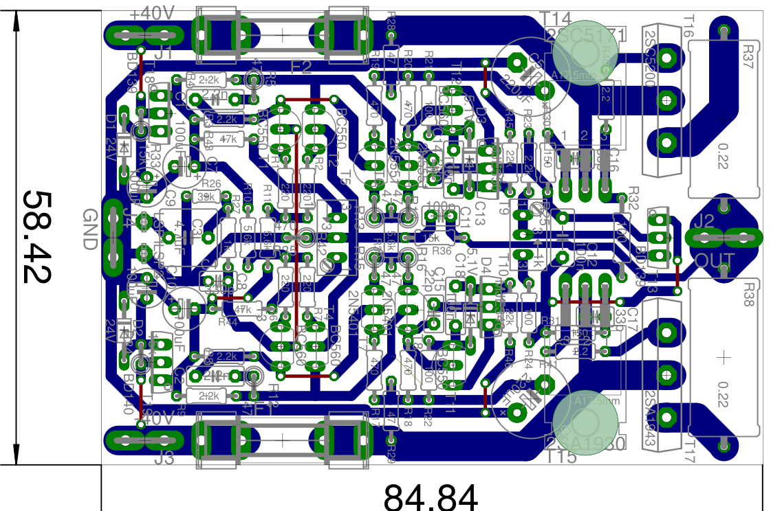

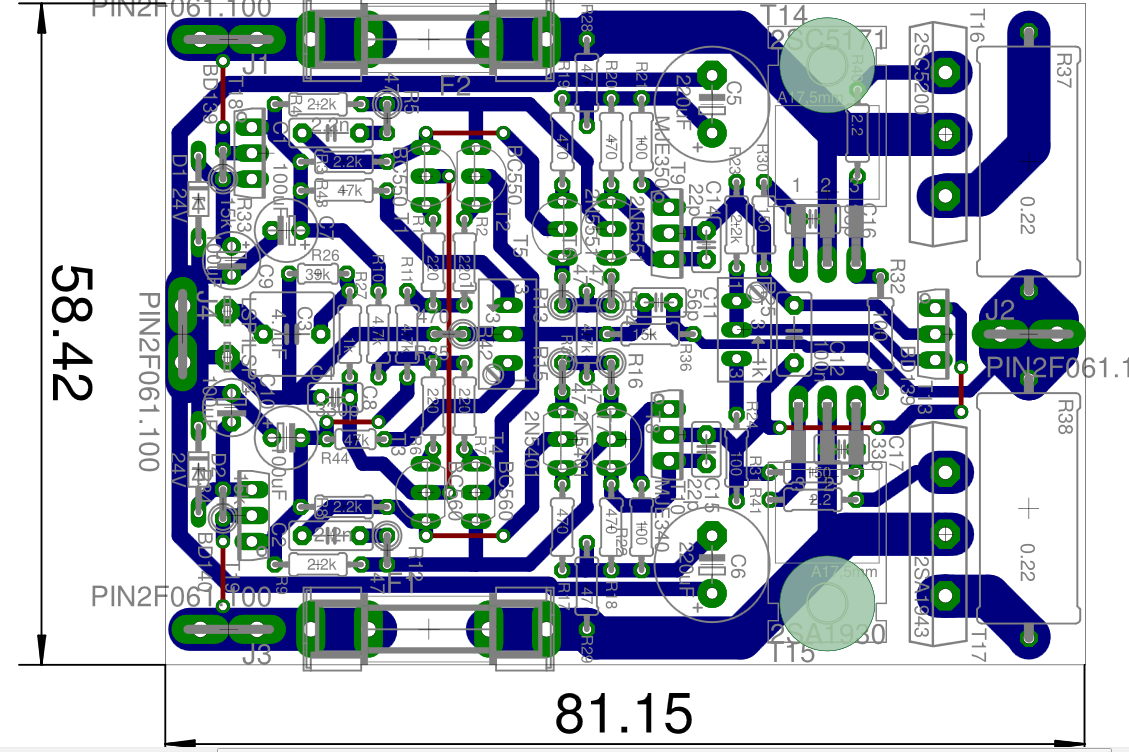

The new layout is ready, but I had to make a board bigger.
Nice pcb design, thanks.
nice pcb ! would it make sense to move the power transistors to the edge of the pcb to make them easily mountable to a heatsink ?
Borys you're so fast 🙂 & very nice PCB design this amp is look so simple with your PCB.

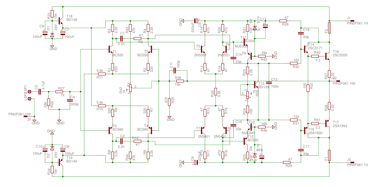

I have putted standard hawksword cascode. The schematic is bellow, but I have to test it further to match correct ''real life'' values of resistors. The first measy prototype was made with exacly same schematic as bellow (very good thd imd measurements and neutral sound). With too much gain in first two stages there is very hard (for me) to get the amp 100% stable in all aspects.Without rc network in first stage there is 3,4MHz small amplitude oscyllation on output etc etc .

borys,
T11/12 are up-side down in eagle sch...you may try to connect (after correction) 5V1 zeners at the junction of T11 emitter and lower end of R21 (T12 emitter and higher end of R22). Adjust value of R21/R22 so you have say 10mA for Tr and 2-5mA for zeners (or two green leds in series and bypass both with one 100nF film cap).

Ofcourse there is mystake there thanks!! I will correct that later on.

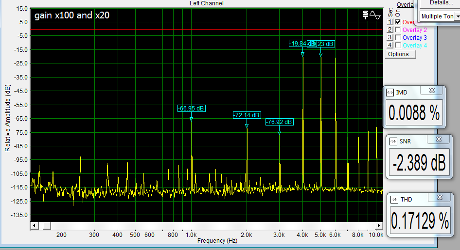

I have checked:
x50 - front stage
x20 - second stage
- VAS - single transistor
Above configuration was stable, no oscilations but clipping above 4k with sine (with square was ok) was very bad.

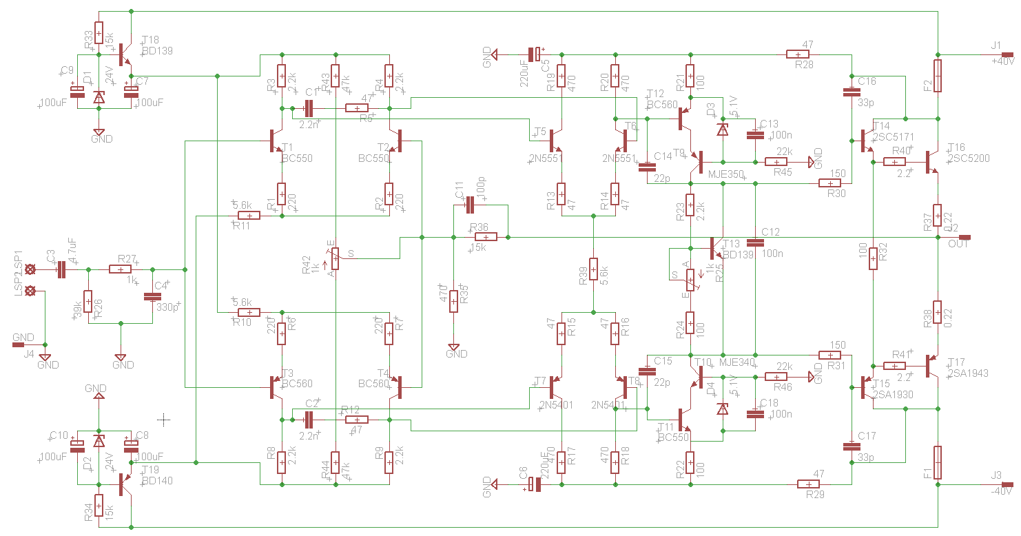

The enhanced cascode has had better performance on measurements so I am going to test it on monday. Bellow corrected test board an schematic (gains will be checked at real amp to get best performance).

borys,
An 5V1 zener has a much larger noise compared to 2 x green LEDs in series...if you choose to keep zeners as voltage references you have to filter noise with an electrolytic cap say >10uf and up. You may also try to discard C17/18 and lower value of R29/30 base stoppers to something like 22-68R if you exchange R36=39k, R39=1k2 C11=22-33p...sim it see what's happening. Also, your DC offset correction is not good, see link for inspiration http://www.solaris.no/electronics/power_amp/ampzilla/ampzilla2b.gif

Thank You very much. I do not have green leds in stock, I have only 4,7V and 5.1V zeners, but I will try 1n4148 too. I will try the modyfications and report back tomorrow.

For best results you need few volts for proper operation of an cascode, so stick to zeners or LEDs in series.
