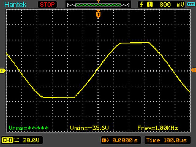

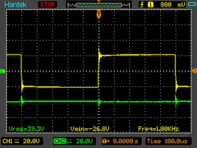

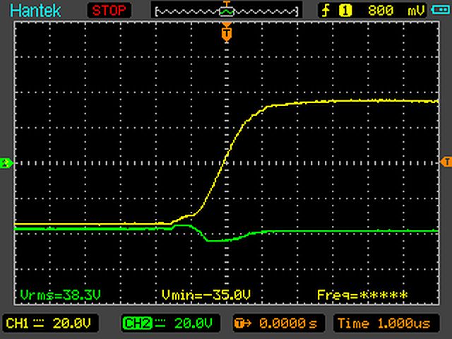

I putted the cascade (added bc546/556 for now) and it looks ok so far. I have some work left to do anyway. Amp will be playing whole day at work.

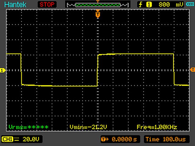

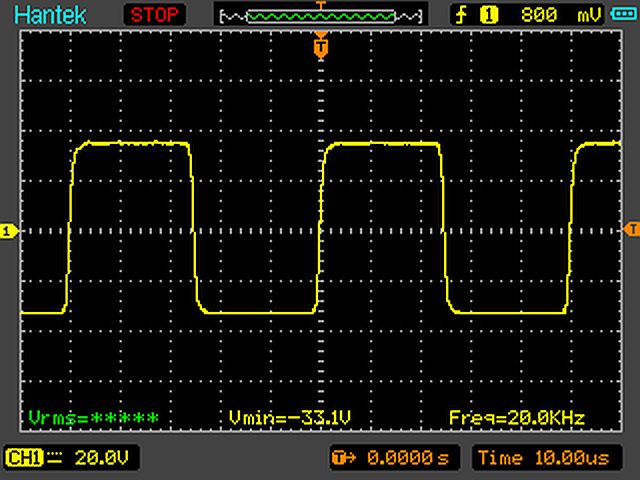

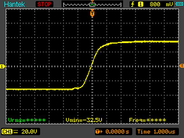

I have putte 470R resistors in front 2 amplifiers (mayby bit too big value). Amp is bit slower but stable.
The overshoot at 1kHz at one of scope reading is with 0,47uF parallel with 8R.

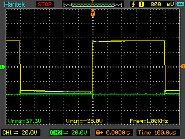

Is the green trace the negative supply voltage? If it is, where is the scope connected, close to the output transistors, close to the power supply...?...
PMI
The green supply voltage is connected after fuse and thin wire (maybe here is the bug). I have to prepare nice board and test again.
Those excursions on the green trace that I see are huge. They look like 10V pk-to-pk...😱 If those are real, whether on the ground bus or on the rails, it will affect the rest of your readings.PMI
With respect, I don't think so. I repeated one of my tests with a 6ft extra wire in the connection from the amplifier board to the positive supply terminal. Note the vertical scale of the second trace. That oscilloscope channel is set to 2V/division.PMI
What you can see is the effect of a bit of added resistance from the wire, about 100~150 millivolts when power is drawn from that rail. No spikes or ringing on the supply at all, and I am not known for neatness when it comes to arranging test leads... 😀

I have both scope earths connected on the test resistor, I will connect them on the psu and test again. I have to prepare pcb.
I added 2*24V psu to the test board and resoldered a cap, now I toolks a bit better.

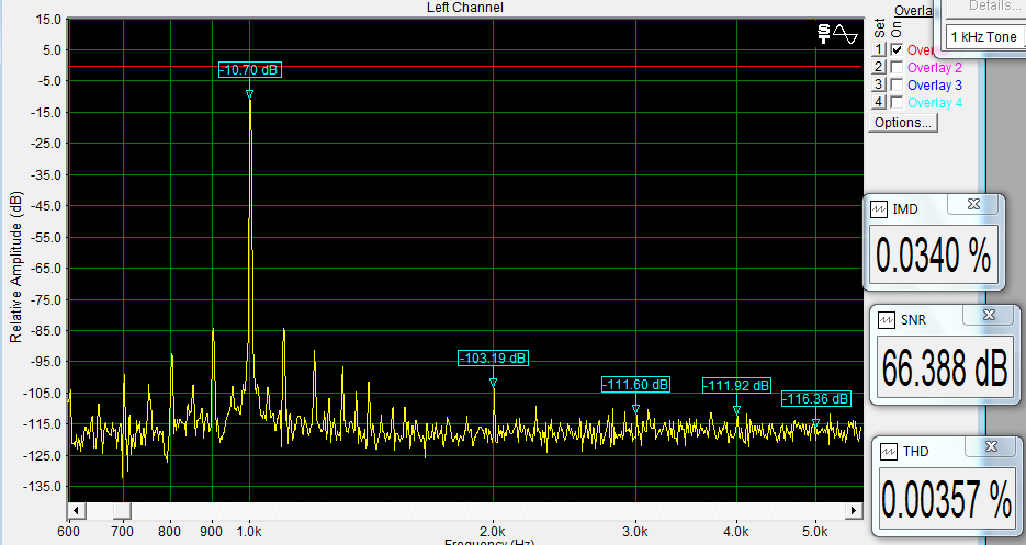

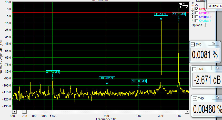

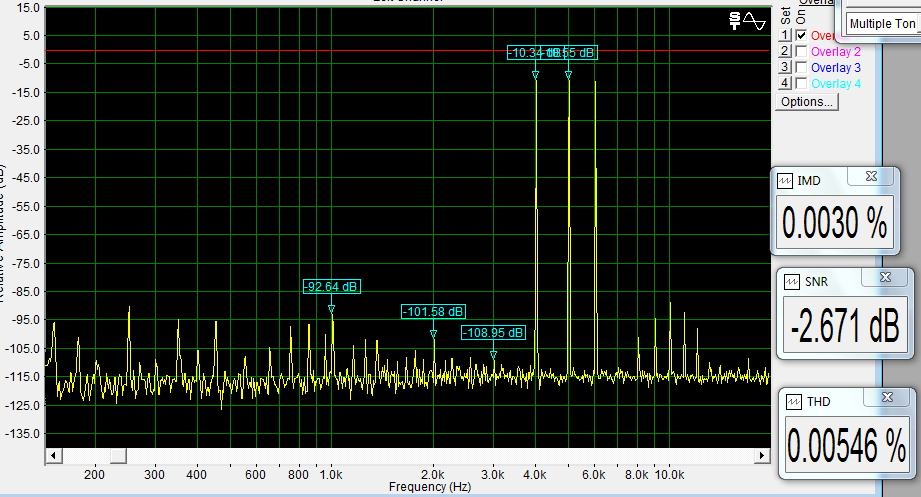

The amp is alive and was playing whole day (version with no VAS cascade).
It sounds a bit differed to cascade one and has bit higher thd levels. There is measurable difference in intermodulation products levels and there is audiable difference in amp character.
The one with cascaded vas is very neutral in sound, very accurate hights, like sound just is flowing threw without any change.
The one with no cascade - it has its signature, there is more background sounds, the amount of details is bit higher (maybe only cause higher levels of harmonics products it can be heard like this).

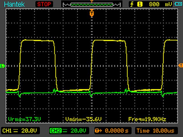

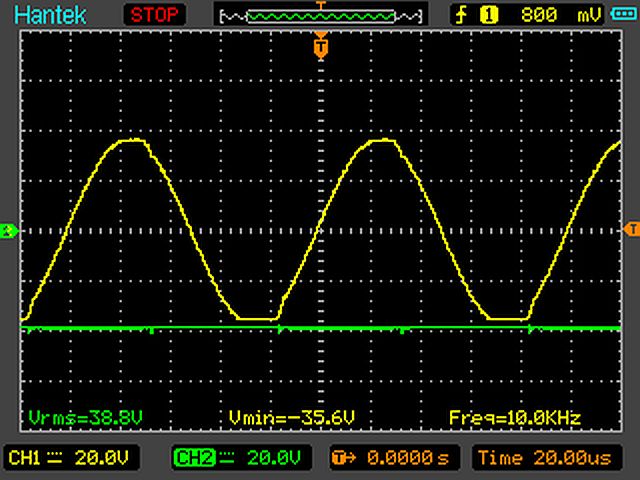

Can someone advise me what about the spikes on psu rail ??

I can't open pictures... can you post schematic of your psu, is there any 100nF caps in parallel with elkos?

The resistors between the big caps are 6x 1R each rail to separate charge currents of both caps sets.
My psu is ok I think (other amps are behaving ok on square full load), the voltage on the spikes is bootstrapped over the psu rail - the question is why ? (or my measure setup fault).
Under same condidtion different amp measured - psu voltage looks correct. I will measure current on emiter resistors tomorrow. The good think about amp is that with input grounded amp is dead silent.
