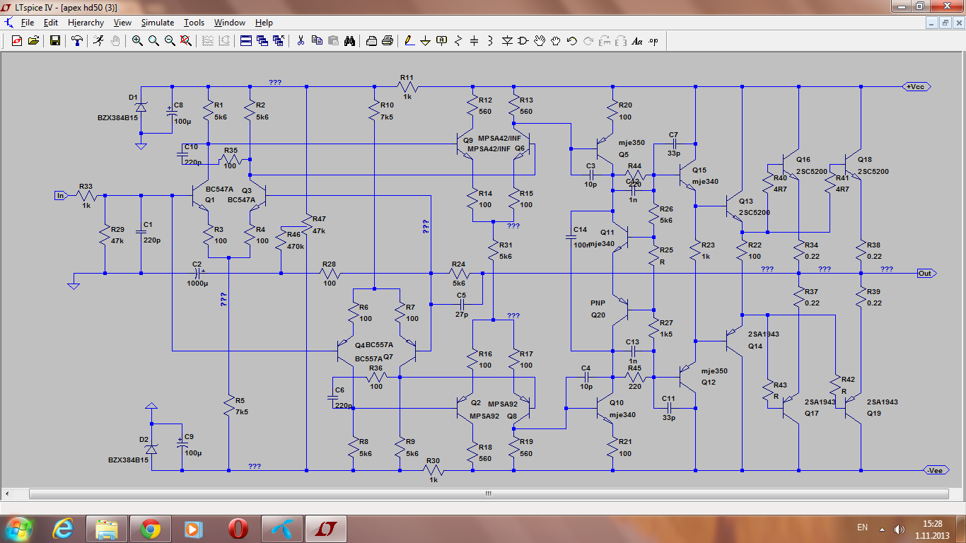

The input stage is supplied with + /-15V stabilized by zeners, which also determines the constant current of input differential pairs and diamond differential to which it is connected. There is no cascade connection and there is no direct connection to the VAS like in Marshall Leach ckt and other ckt with simple symmetric front and.

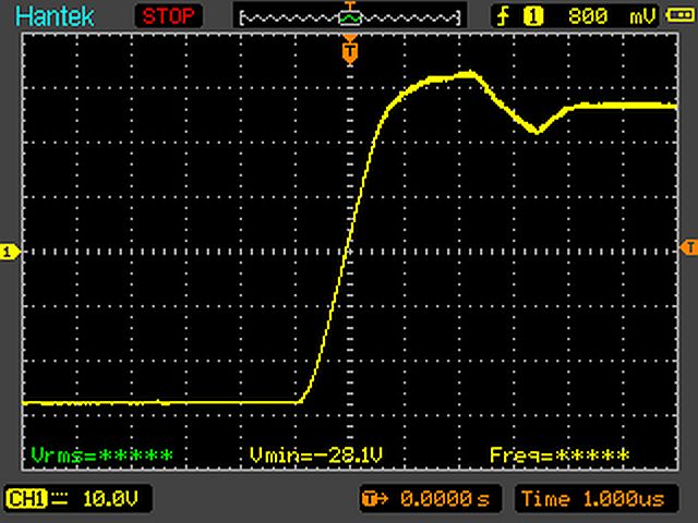

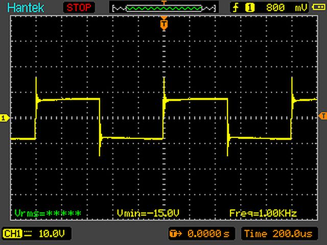

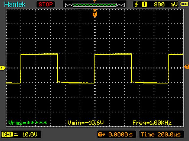

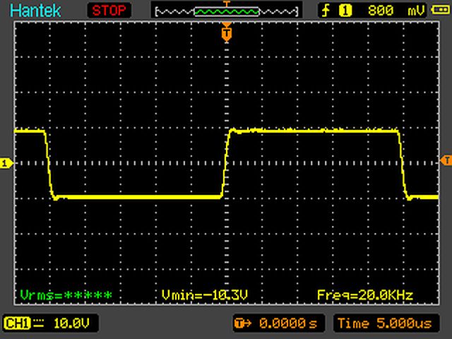

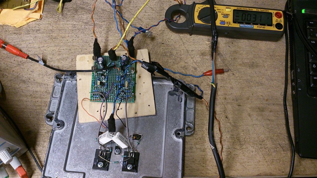

Yes that meas on my desk is hd amp (bit different schematic).
It is working and playing right now. There is some work left to do but most important is that is working.

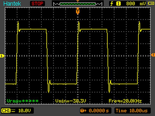

I didnt putted zeners at front end, I putted 2x2n5xx1 CCS instead.
With big amplitude I am gettin overshoot and bias is under compensated (I have to check this case too).
1st stage - 4mA
2nd stage - 5mA
VAS - 20mA
Driver - 13mA
There is some brumming issue but prapobly due my shitty board.
Amp is playing nice anyway - this is good promissing sign.

Nice work, zeners must be used, DD need stabilized voltage on input for constant current, this topology promissing. DC offset circuit must be add as next circuit upgrade.
Regards
I do not have 15v zeners, can i use 24v ones and change two resistors for correct bias? Another think is if i can use 10k pot instead of two 5.6k resistors for first stage ? Differential amp on legs 1 and 3 and zener psu on leg 2? Or better do standart offset adjustment
Use zeners with voltage under 15V (8v2, 9v1...) or separate +/-15V psu (LM7815/7915...) and remove 1k/2W resistors.
For dc offset you can use any circuit or dc servo with op amp.
Keep on going this project.

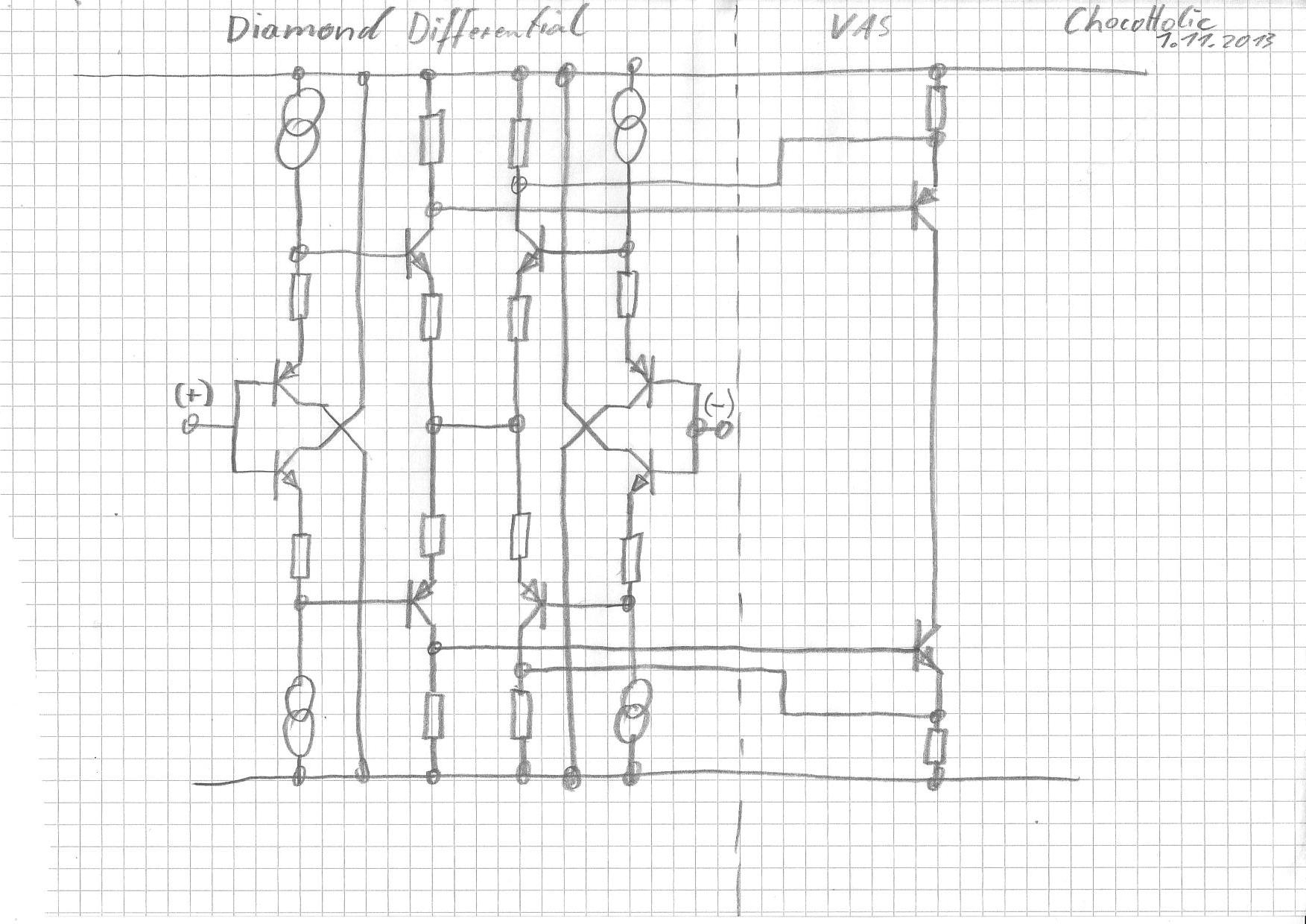

My comment is just about the naming.
From my perspective this thread is showing only one schematic with a diamond topology and this was the Non Differential Elektor Diamond.
Attached a principal sketch of an input configuration which I would link to the title of thread.

Exactly. So far the naming 'diamond' typically is used for this PNP-NPN/NPN-PNP combination, which often used for buffers.
Some amps use this diamond approach also an input stage.
By combining two diamonds like in my sketch you can easily settle a very linear differential input stage with high input impedance and need nothing but cheap small signal BJTs.
