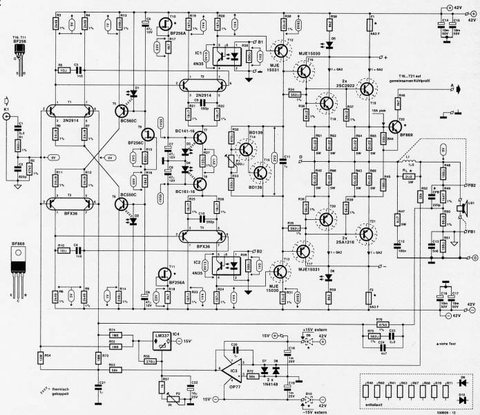

Hai Rieds,
can you make it Triple Darlington output?
with symmetric VBE, MJE340+350 or BD139+140...

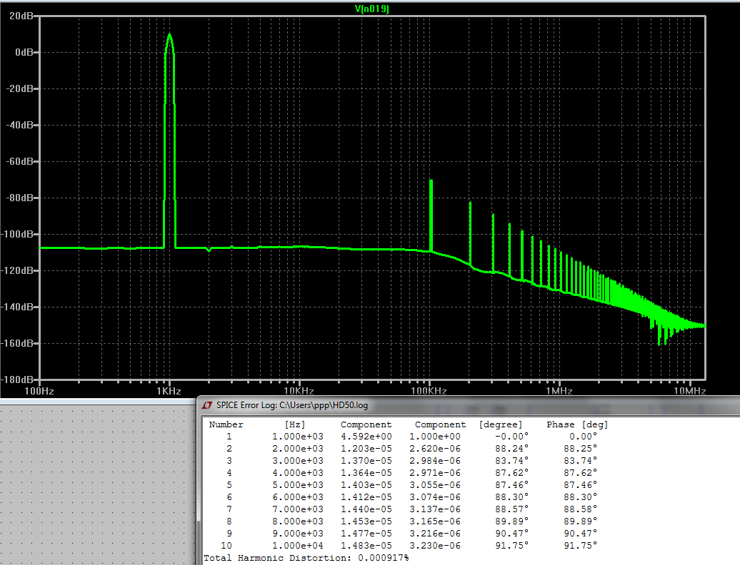

I just was wondering if there is anythink special in diamond topology, diamond buffers are all over the net, so I just added 2 current sources and tef stage into it and it worked just fine and is simple. The results are there SR around 60u/us and thd nearly not mesurable:

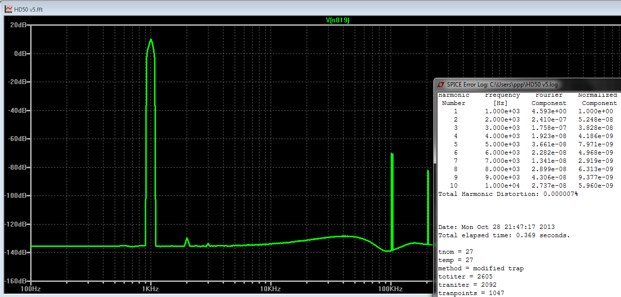

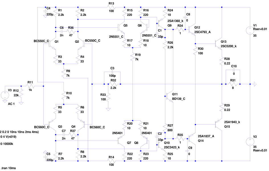

I tried the schematic on ltspice.
I replaced R10K with 1K8 & added some capacitors for amp stability.
Nice work, thanks for correction, I revert 10k and 2k2 on my schematic. I will use some different compensation for stability.
Regards
If you put big compensation caps the amp will be slower.
Just replace in first stage amplifiers 5.6k resistors with 2.2k, than 1.8k with 3.3k in second stage and amp will remain stable with only one pair 33pF caps, and will be much faster.
FFt looks nice.
Mile

I think You don't need 'Triple Darlington' or triple emitter folower, if you need high power you can replace the driver with the bigger transistor like MJE15034/35 or 2sc5200&2SA1943.Hai Rieds,

No, I don't think so... I thought TD or TEF just like you now(for more power),I think You don't need 'Triple Darlington' or triple emitter folower, if you need high power you can replace the driver with the bigger transistor like MJE15034/35 or 2sc5200&2SA1943.
Regards.
but
more gain there at output stage mean less stress to VAS stage &
lower the distortion 🙂
I have build one, it is from apex too (AX-17 or 20)
MJE340+350 ---> 2SA1837+C4793 ---> 2SA1493+2SC5200
They are quite stable this arrangements, I've also changed to
MJE340+350--->MJE15032+15033--->2SA1216+2SC2922
and I prefer this one, more rugged (the heat is not so hot when biased 100mA)
The above is more warmer in the sound & hotter the heat sink with same bias.
I thing it might be the same here, try to build one & you know what I mean 🙂

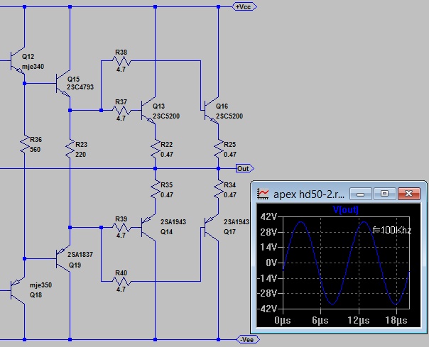

do you mind to try to simulate it now? TEF or TD...?

I have one question:
Can I make rail resistors in frot diff amps not symetric? For eg. 1k and 2.2k (if I will replace R1 and R7 with 1k)
Mile
Mile
Resistors in front diff amps must be symmetric, where is 15V zeners on your schematic? Your typical compensation scheme is ok, try to change gain and currents in amp stages...
in simulation we can use tef from ax-17 or ax-20 without any stability problem. but most important for this time is the stable prototype 😉No, I don't think so... I thought TD or TEF just like you now(for more power),
but
ps: I can't simulate like you do, but I think should try sometime 🙄

I lefted frot stage at full rail at the symulation.
Can U advice me what advantage is to use 15V supply at frot stage ??

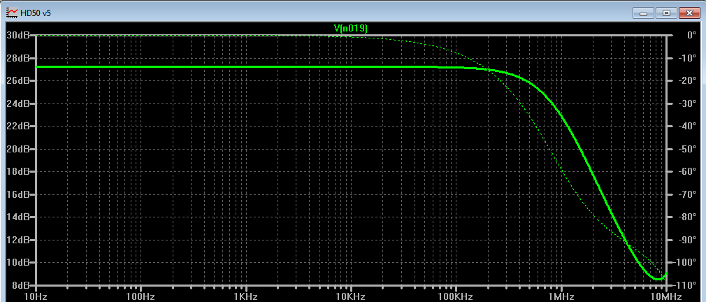

Interesting harmonic distribution. Ensure that as the phase closes 180 degrees that your gain has fallen to 0 and below

With 15V zeners LTP, DD and VAS have constant currents with different rail voltages...
Regards.
I want to test new topology with simple basic circuit, and add CCS, TEF, cascodes... in high power versions. With TEF output stage VAS can work with 6mA instead 20mA and DD with 3mA instead 9mA... prototype must be made.
