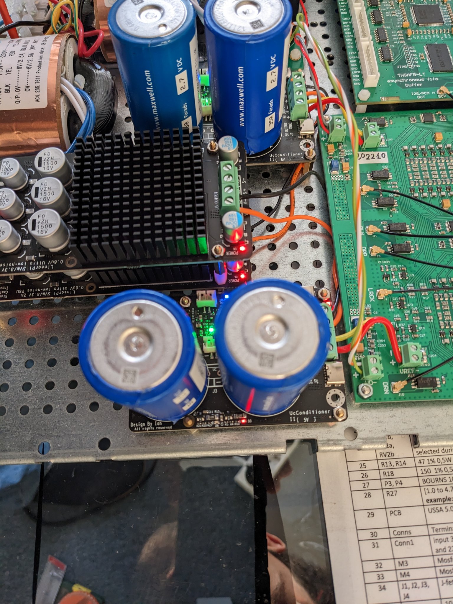

The overvoltage indicator LED lights up on one of my two 5v UCConditioners.
They are both fed by a 5v LinearPi.
Funny, the overvoltage is detected on the one with the lower voltage (5.06, 5.08 on the other one).
Anything to check?

I had the same problem couple years ago. I wrote about this here about imbalance, and uneven charging / discharging.
unfortunately, I was unable to overcome this problem. I tried to add different resistors to speed up the discharge. but in the end, I decide not to risk, because if you don’t pay attention, the voltage on one of the supercaps easily goes beyond 3v with a maximum allowable 2.8v🙁
