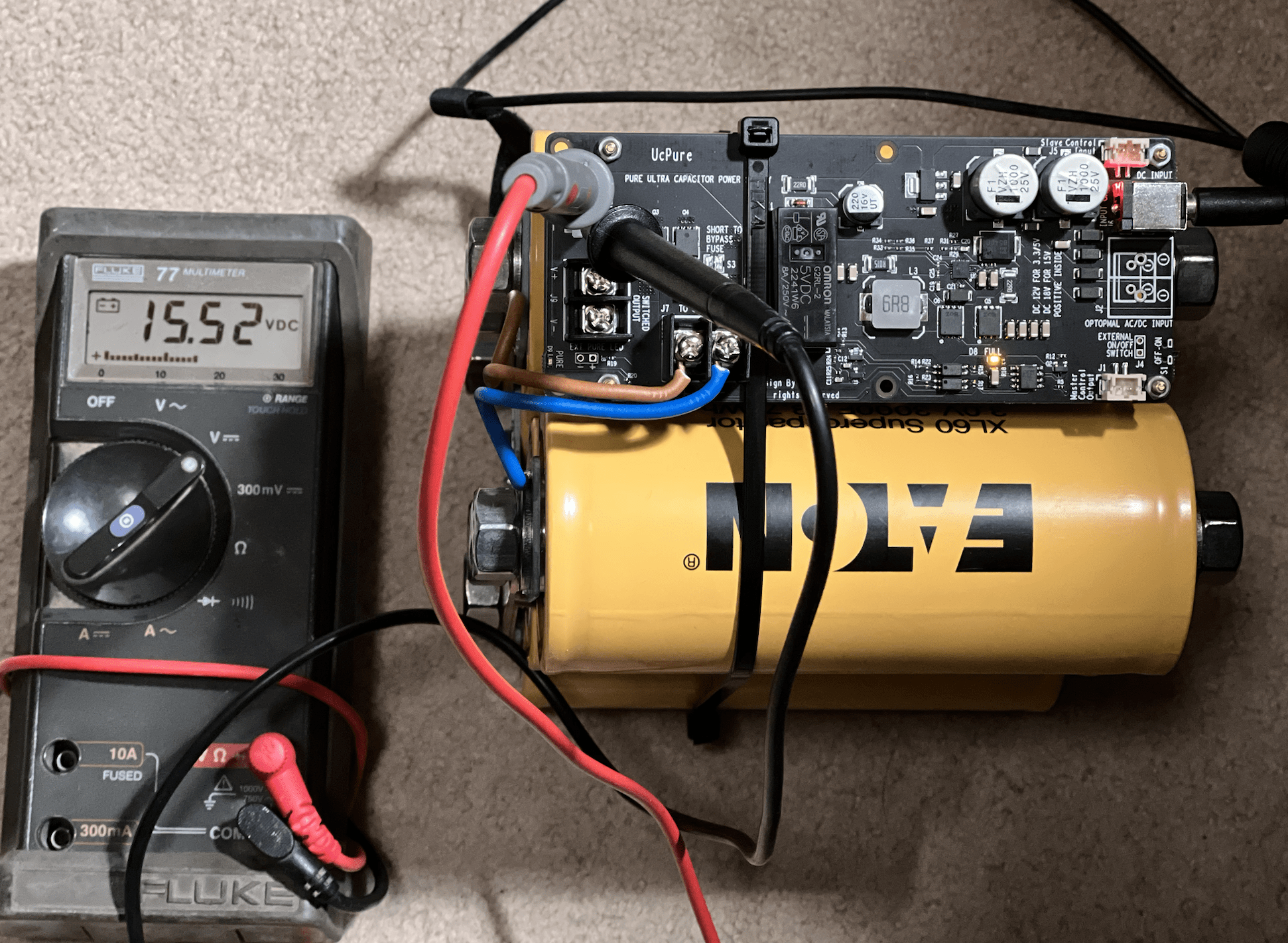

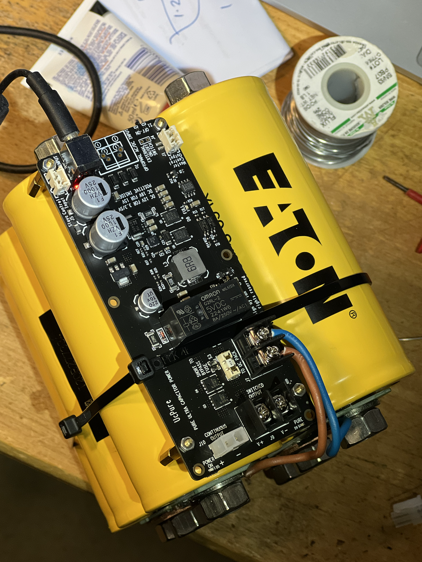

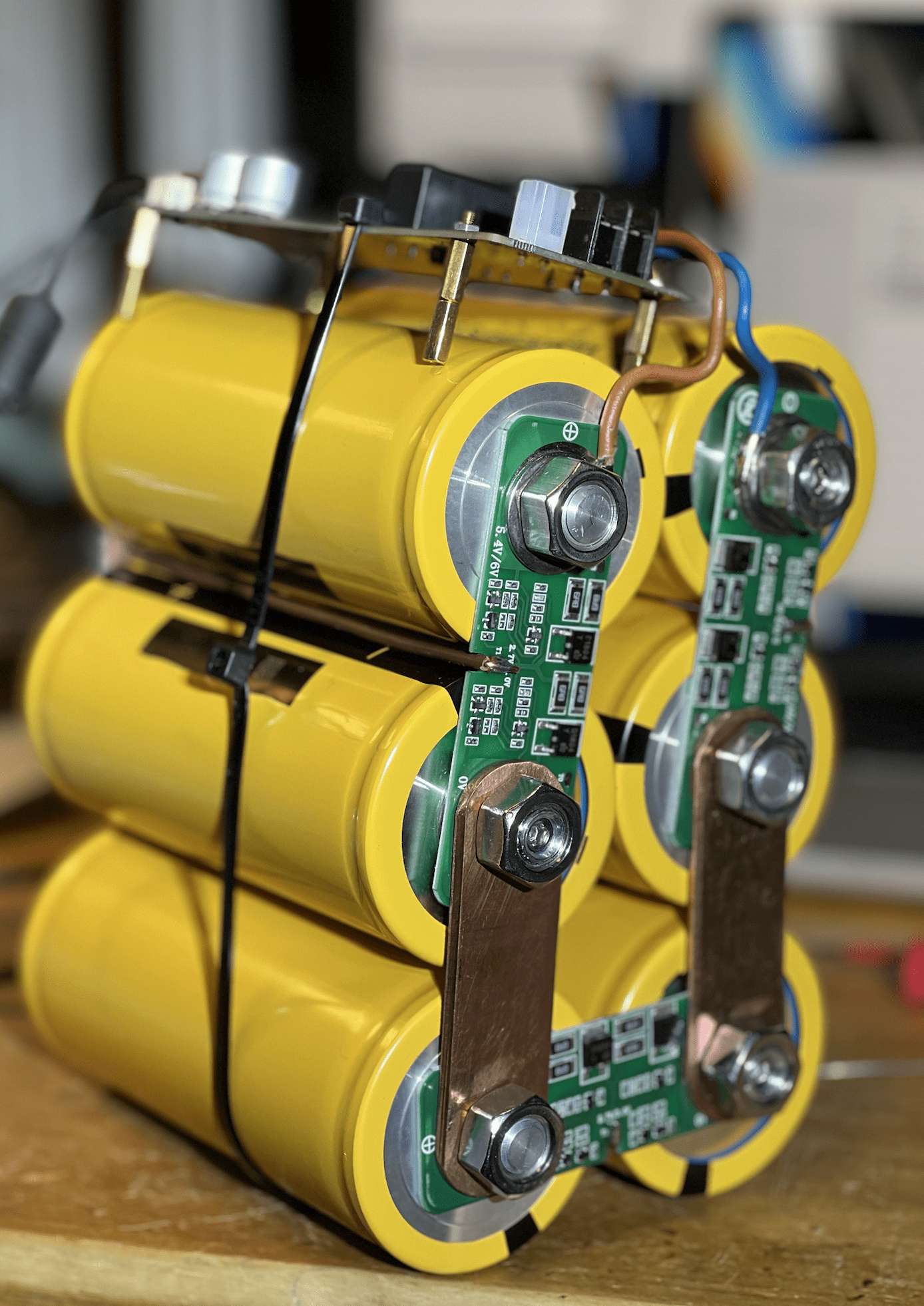

Hats off to @iancanada for the UcPure boards - thank you very much.
I've just constructed my first one and apart from completely ignoring the size of the UCs during the purchase (they are BIG) and the fact that one of my kids asked me if I was building a bomb...all is looking good ;-)
I've built 15v one so far, to power Andrea's clocks. See attached pics. I got slightly worried as the 'full' LED came on but the charge went past 15v without stopping(!) but it's levelled out at 15.5v and is now constant.
Once I've got this one installed I've got 2 more. One is going to power the SinePI once I get it working properly in my setup.
Here are some pics of the test build and I will report back when I'm powering something I can listen to!
