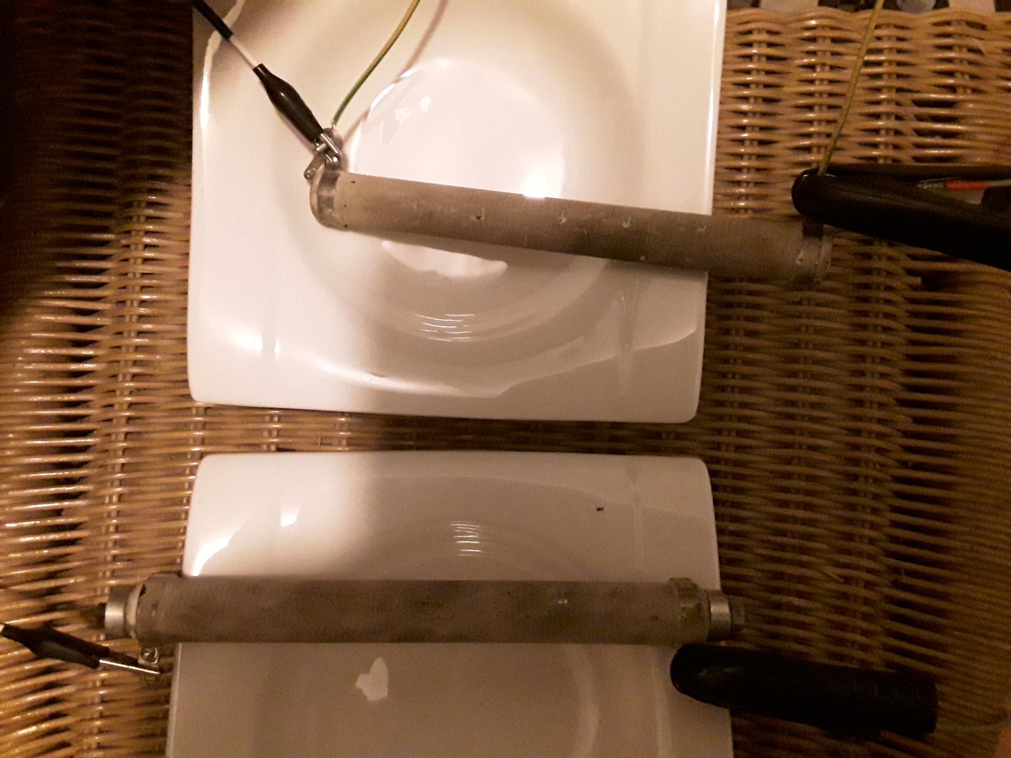

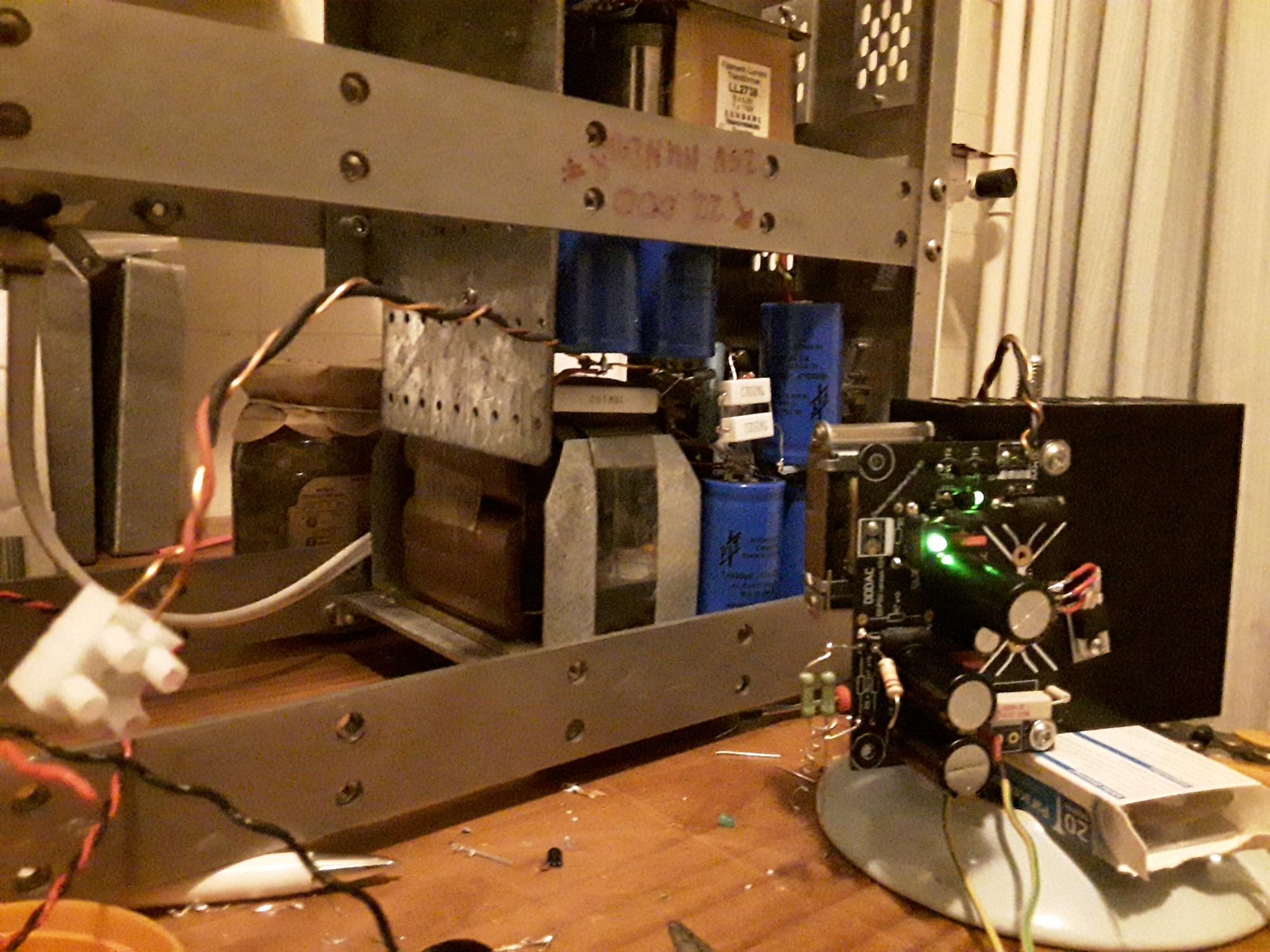

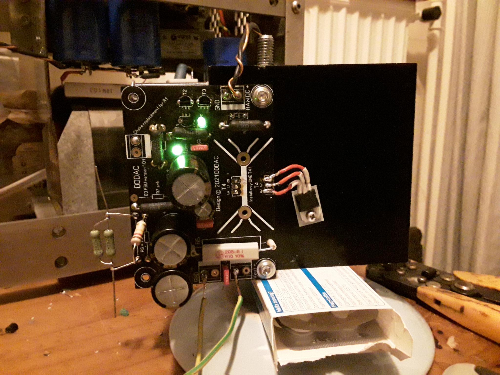

Hello,
Today i kind of finished a LCRC supply followed by a regulator circuit designed by Doede Douma to feed my lifepo4 board from Ian.
I will use the 5 volt 2A supply followed by a Ucconditioner board for the Raspberry.
AND 4 lifepo4 cells from which 3 will be followed by UcHybrid board for some small consumers.
The 5 Volt will be eating all the time and the 4 lifepo4 will just consume a lot when charging.. Once charged they will recharge at different intervals i guess because not all circuits will take the same current.
The supply now can supply around 2A continuously at 15 volt and then have enough voltage drop across regulator circuit to achieve very low ripple.
If i connect a kind of load resistor across each of the 5 supplies will i be able to check if the supply will be powerfull enough to charge everything? When there will be more than 2 A the voltage drop can become to low so ripple will go up but that will be temporarily.
Any ideas welcome, Eduard
P.s As you can see i had to use some big resistors taken from a welding machine to create a proper load

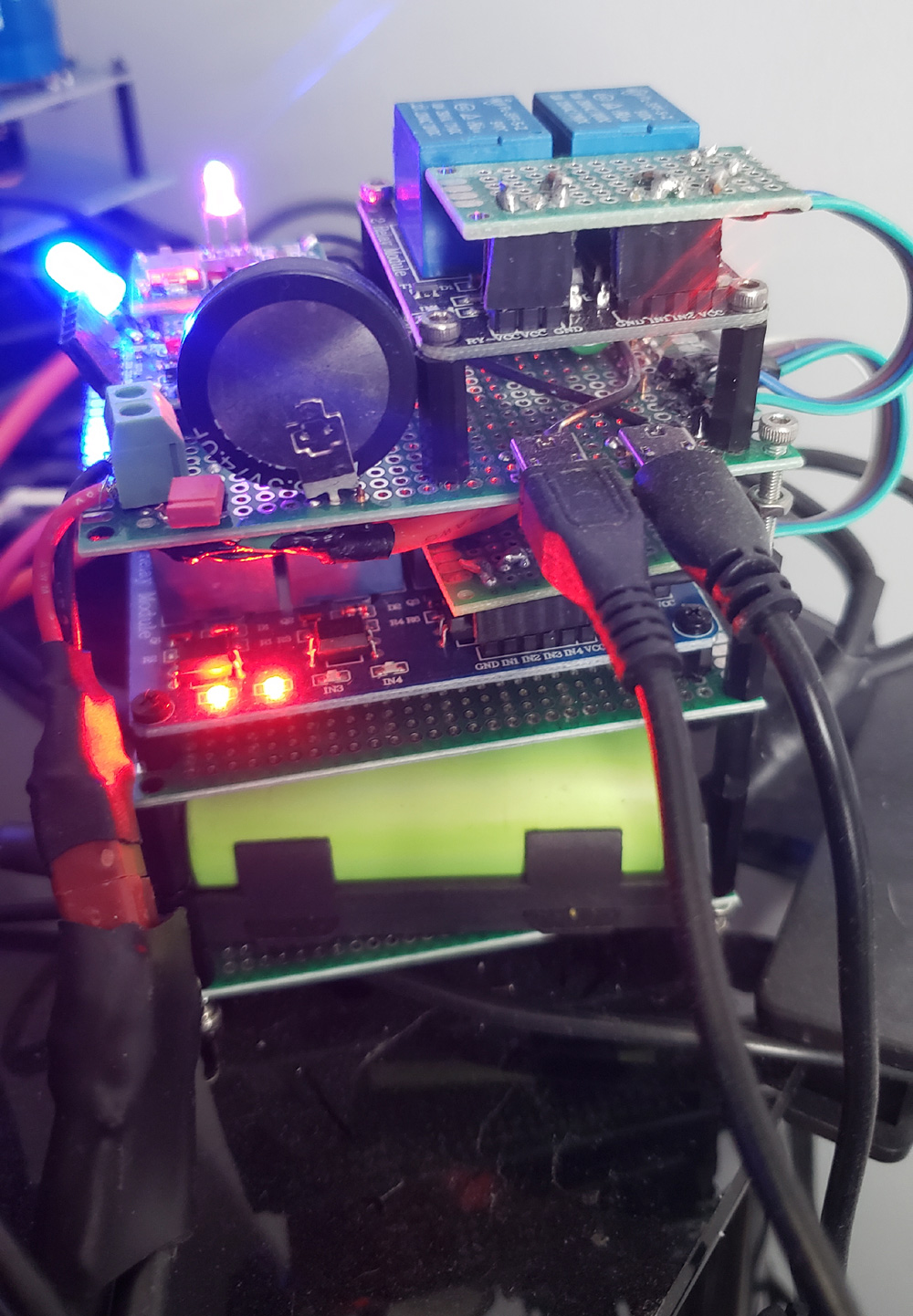

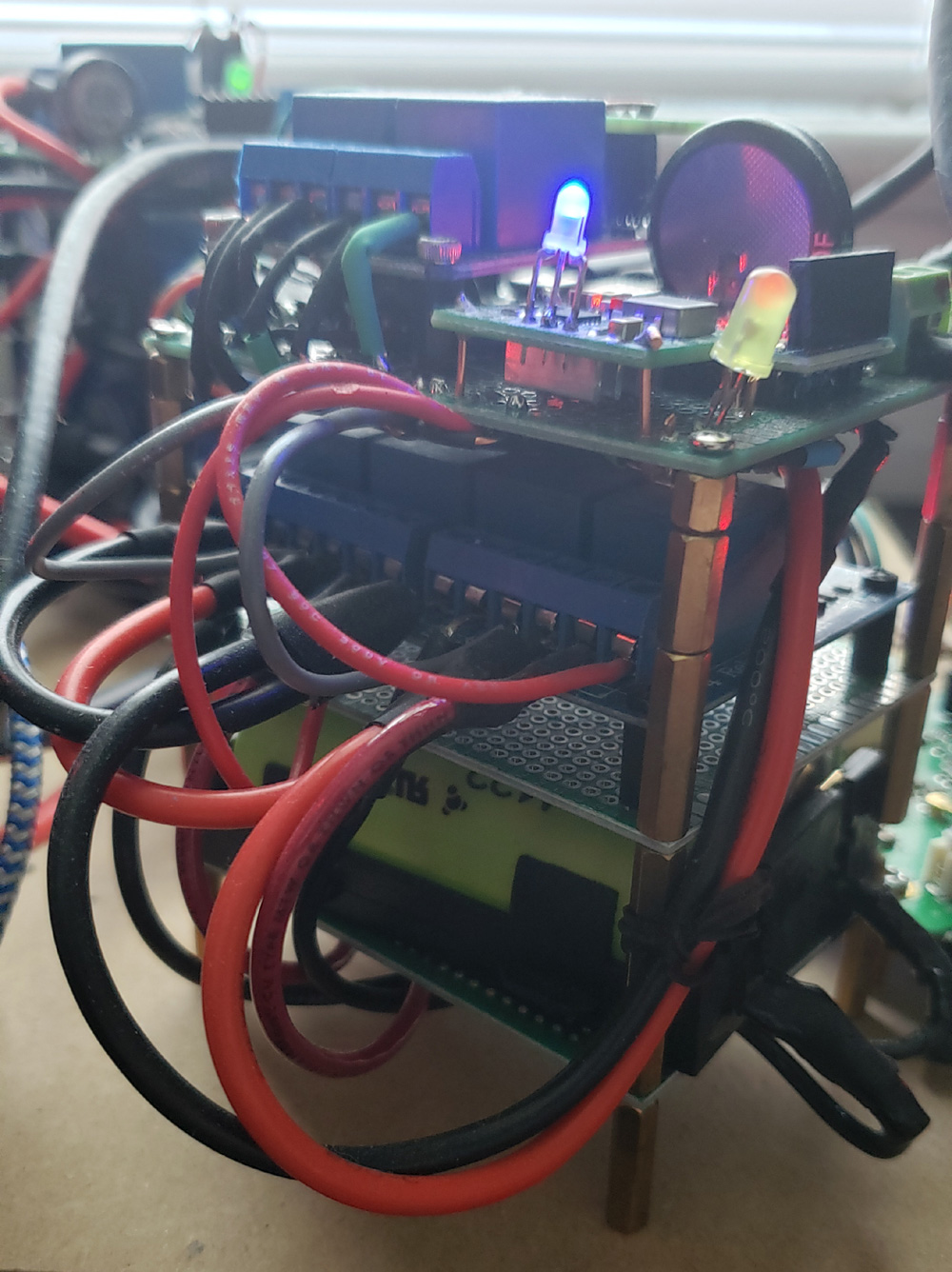

I have built modules that alternate between 2 LifePo4 batteries for constant, clean 3.3V using Arduino code & controller, relays, TP5000's to charge, and a couple of perf board stacked with standoffs.
Some of them also incorporate supercapacitors, managed with power resistors and additional relays to avoid current rush issues.
Ian's solution is more sophisticated - I just wanted to do it myself and to also have 24/7 power for clocks and such without needing to worry about doing anything to trigger a recharge.
If using an IoT music player like Volumio, it is possible to incorporate an ESP8266 or ESP32 to ensure no relays clicking while music is playing.
if the charger is charging in series ( 13.2 v ) and the Arduino and relays etc. are running off 1 cell (3.3v), does this not cause a charging / discharging imbalance?
