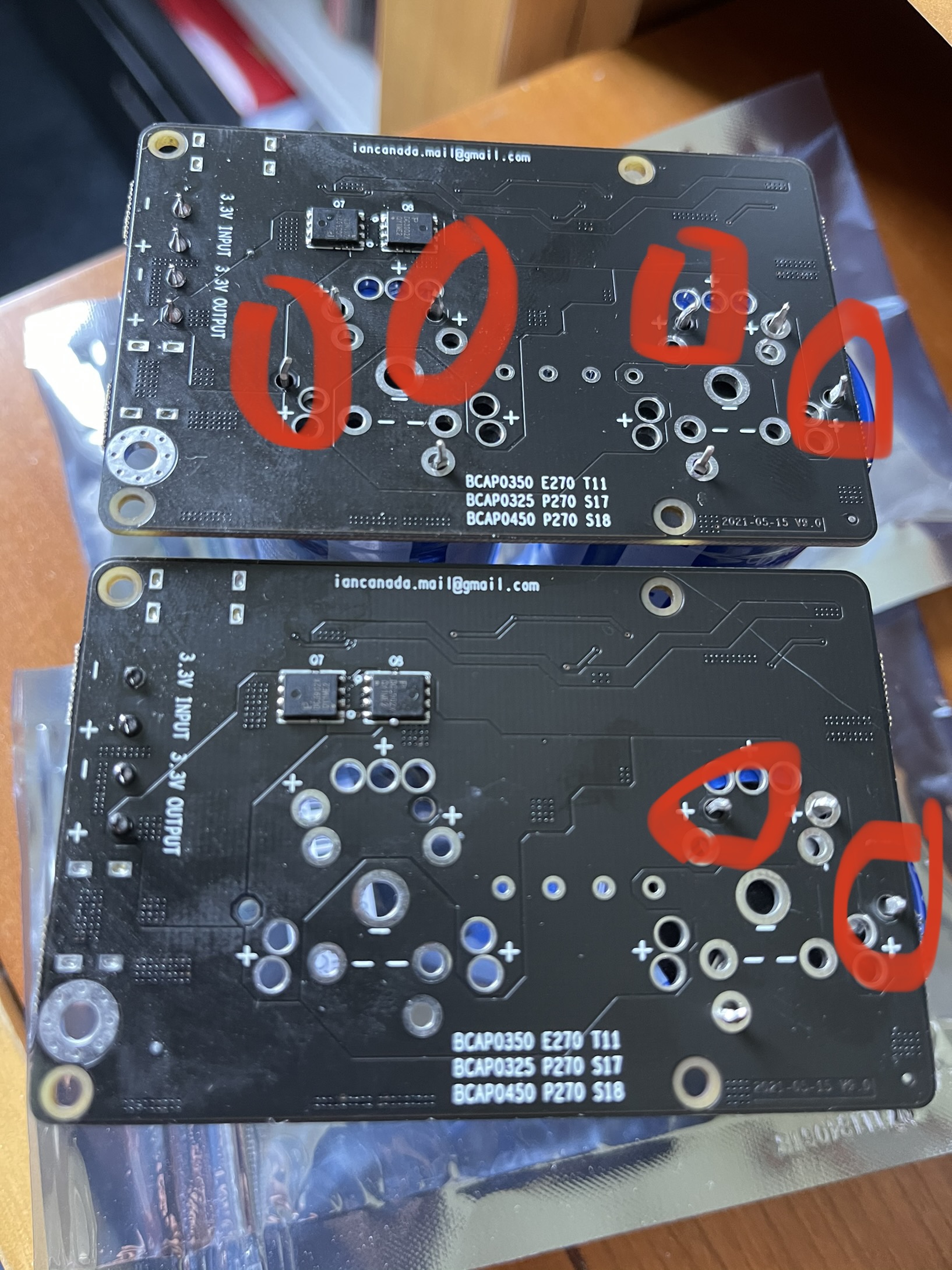

Thanks. D6 on two 5V boards are now lighting up. The power supplies measure at 5v. Should I not use the board until the light is off?
@stew1234
Seems the ultra capacitors were not fully empty. Can you measure the voltages of the two UCs?
It's better wait for the light going off.
Ian
Ian
These are boards I've used before without issue. There are two 5v boards. On the first, one ultrcap is approx. 2.61v and the other ultracap is 2.19v. On the second 5v board, one ultracap is 2.63v and the other is 2.31v.
I also have a Salas ultrabib shunt reg. feeding another 5v ultracap board. In the past, it maintained 5v and powered the ultracaps without issue. Now, after I set it to 5v output and then connect the ultracap board, it won't get higher than about 4.77v. The only change was adding an additional 3.3v. ultracap board between the reclocker and the power supply (so completely different part of the circuit).
Any ideas what might be the issue?
Hi Stew,
I have the same problem for a long time with the 5v version .. for some unknow reason, one of the two supercaps is discharged faster. therefore, an unbalance occurs, and if you do not turn it off in time, there will be an explosion risk.
Here is the link with prove IanCanada UltraCapacitor 5v disbalance problem - YouTube
You can manually discharge one of the ultra capacitors by a 10ohm power resistor until the voltages get equal. If the problem is still, then you have to make sure if the two ultra capacitors have the same capacitance or same leakage current.
Ian

Thanks for the input all. I hadn't used the DAC in a while and after letting everything settle while turned on the ultracaps appear to have equalized. All of the caps were purchased through Mouser so I would expect them to be new. I'll see how they behave going forward.

balancing with a resistor is not a solution, it is too difficult to remove and discharge each time.
there is another way. imbalance is guaranteed to occur if ucs are not turned on for more than 3-4 days.
so i do like this.
I turned it on and waiting for the overvoltage led to light up, then I turn it off. after 10 minutes I turn it on again, waiting for the led and turn it off. and so on average 3-6 times, depending on the degree of imbalance.
And the same, all of the ucs were purchased through Mouser.

Ian,
is it possible to mod 5v board, and when the led lights up, turn off or put the board into emergency mode/bypass mode?
because sooner or later someone will explode or catch fire if the board will be in a closed case.

@alecm,
I have two UcConditioners (5V) in my system. I use them everyday and never had a problem. Ucs were also bought from Mouser.
Only for one time I had one red LED lit when I installed two brand new ultra capacitors. But after three hours of powering, the red light was gone. That's what the balancers work for (the voltage of the other ultra capacitor will be increased slowly to reach the balance point).
To evaluate the potential risk, I did a test to charge a 2.7V ultra capacitor to 3.5V. The only thing I've noticed was that the leakage current was increased. When the charger removed, the voltage dropped back to around 2.5V very fast in a couple of hours. Much faster than just charge it to 2.7V. This feature also tend to make the ultra capacitor with higher voltage back to the balance point rather than going to the other direction.
That's my own experiences, just hope some helps.
