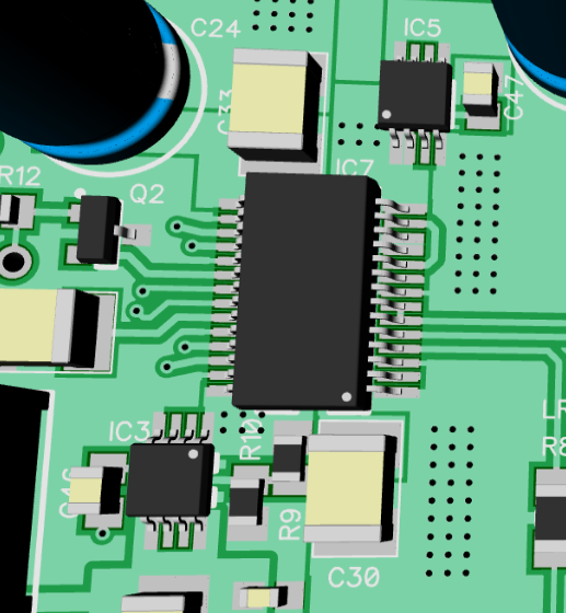

New LifePO4 power supply MKIII was fully tested without problem.
The improvements to the MKII are:
1. Ready upgrading to ultra capacitor power supply by integrating with UcMateConditioner and UcHybrid.
2. New continuous DC 5V mode can be enabled now.
3. PTC fuses replace the protection resistors to reduce the risk of possible damaging and reworking.
4. New optimized PCB layout and the double thickness copper layers lower the power supply ESR even more.
5. Accuracy of voltage measurements and monitoring were increased.
6. Can have up to six outputs of 3.3V LifePO4 voltage rails in total.
PCB size was increased a little bit but all mounting holes are still compatible with MKII.

Upgrading the LifePO4 MKIII to ultra capacitor power supply
Upgrading the LifePO4 MKIII to ultra capacitor power supply would be very easy and flexible. Just need UcMateConditioner (for 5V) and UcHybrid (for 3.3V rails). UcAdapter board will be optional to mount all of them together as well as additional shield layers.
To link them together we just need a bridge cable for each board. Cable should be short and big to keep the lowest ESR performance. It's also no problem to upgrade with MKII. Just need to solder the other side of the UcHybard bridge cable directly to the battery pads of PCB rather than connectors.
BXAP0325 P270 S17 is the lowest ESR UC so far. Other suitable size Maxwell Nesscap UCs also work. It could be the best power supply that can be reached so far with this crazy upgrading.
