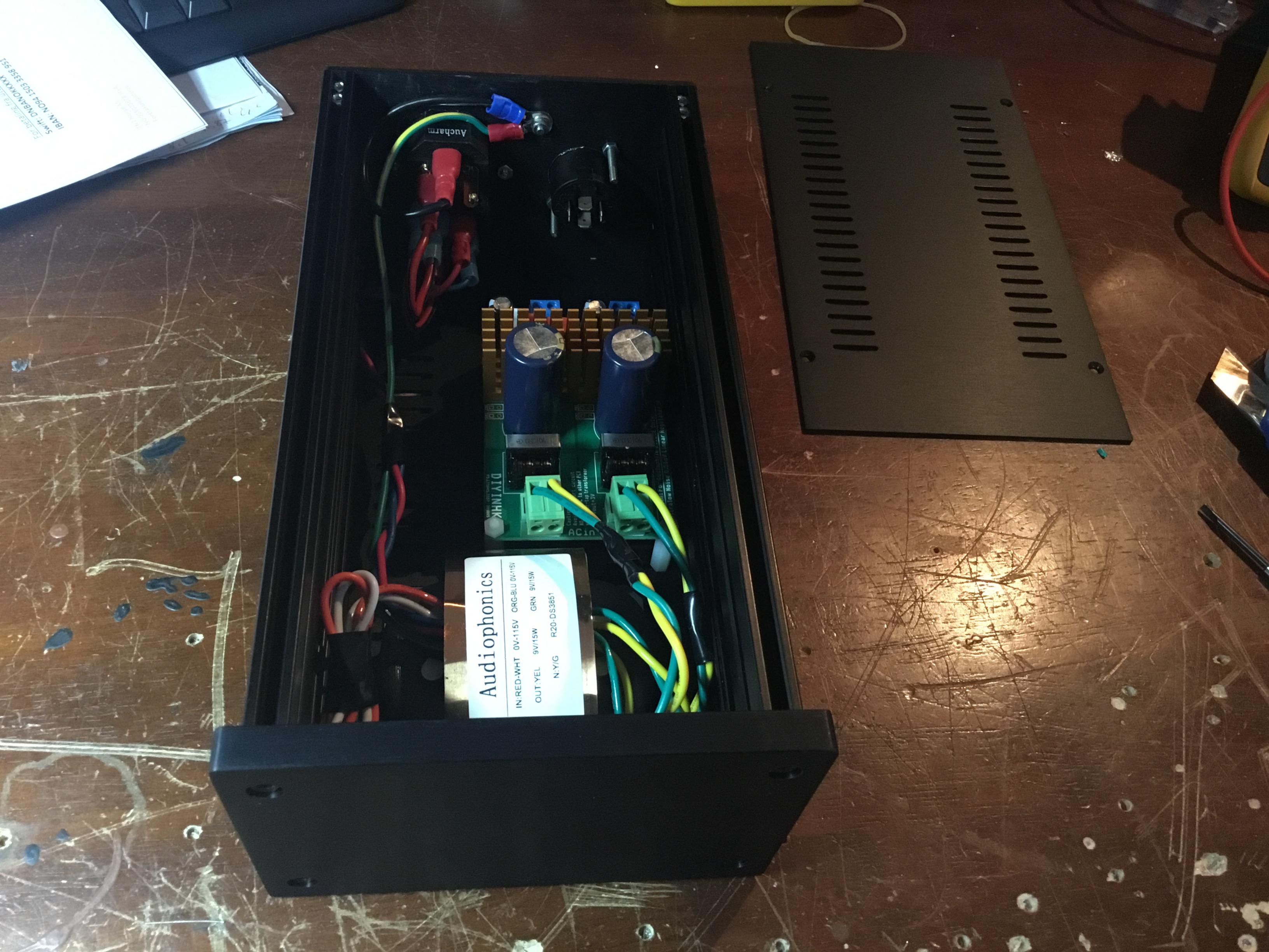

Why not build one ? This is diy, and fun. My psu with R-Core and LT-3045 regulators.

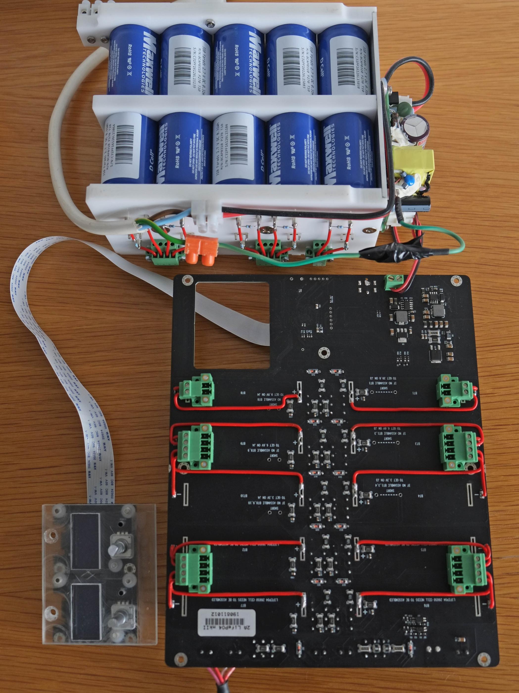

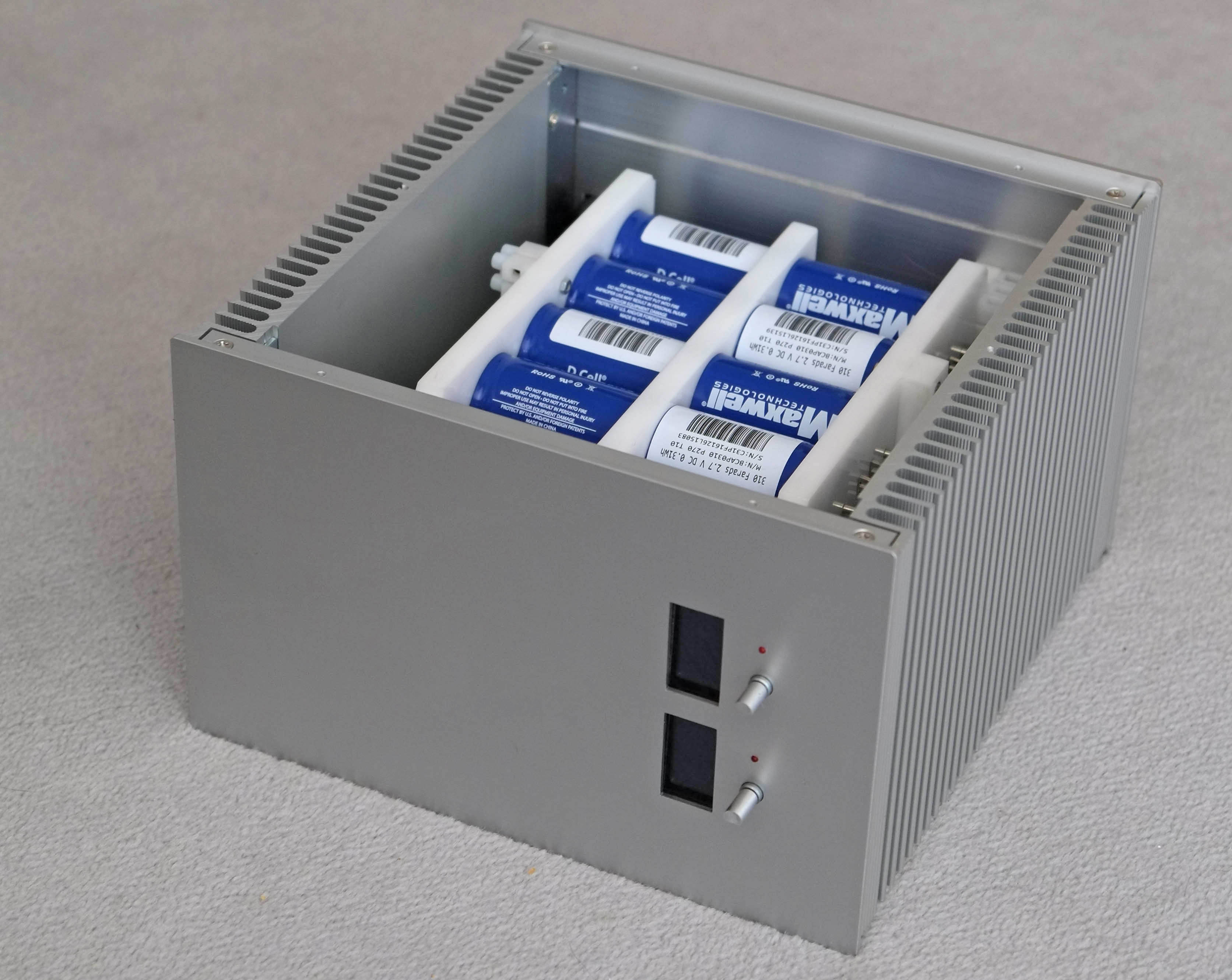

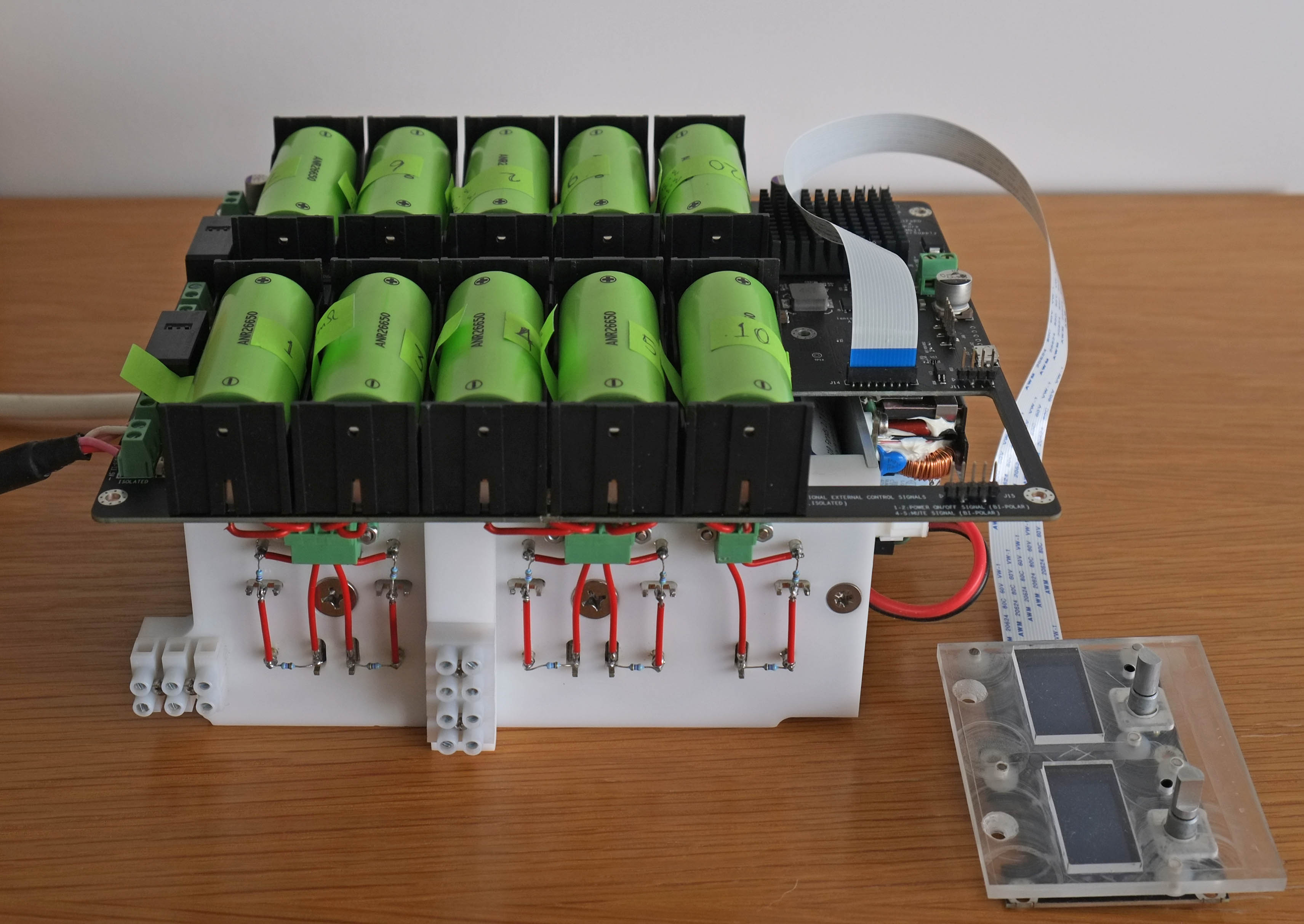

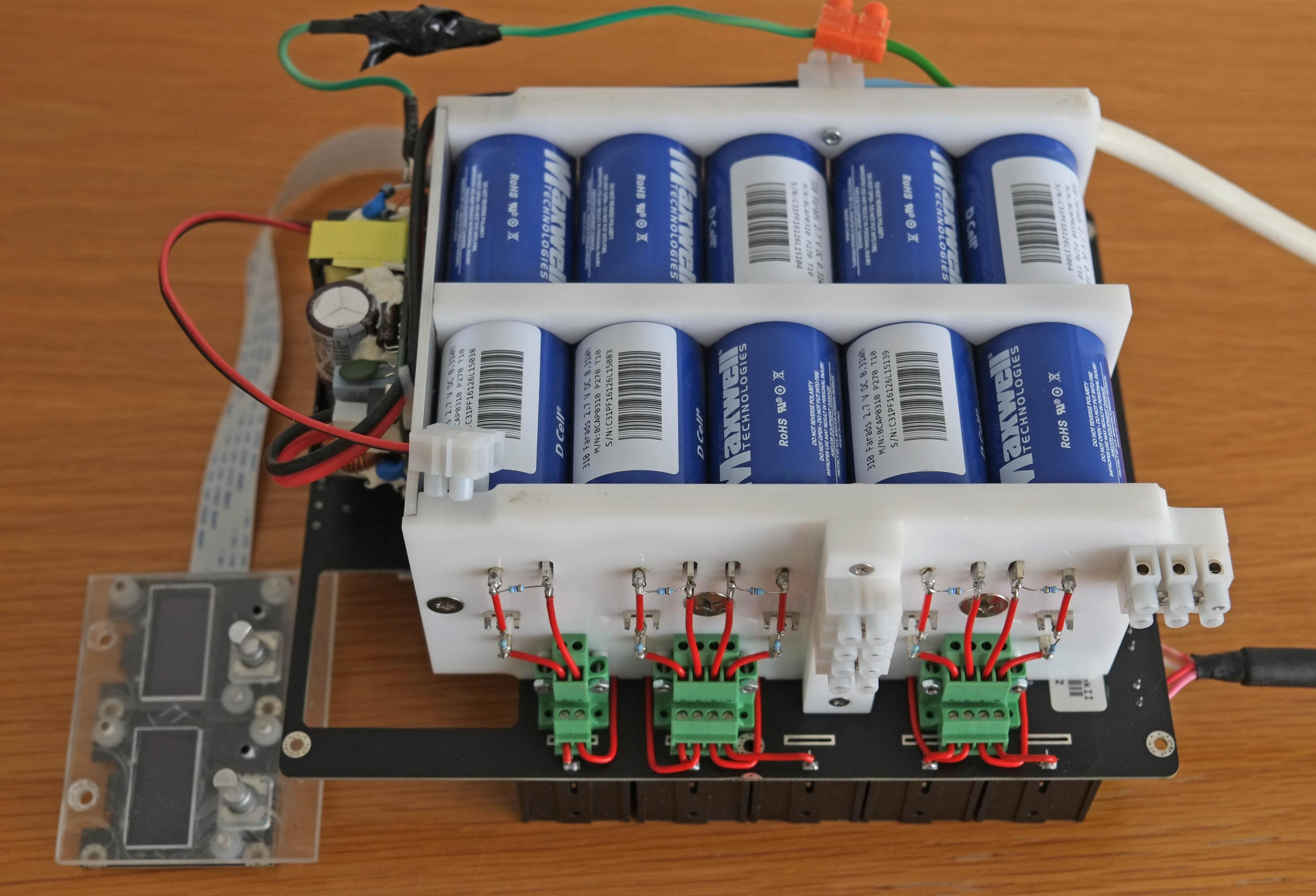

Seeing Ian's progress has prompted me to post my take on his battery/ultracap combo. This is now up and running and the ultracaps add texture to the bass, especially cellos. This supplies power to the M Scaler for two hours when fully charged at 13V. I have another battery board (damaged) that Ian has offered to repair that will double run time. Once I get this sorted, I will box it all up in a Takachi case; a very tight fit. Photo of box doesn't show top board added.

Hi Ian,
Your UC solution looks interesting. From your testing indicating short distances and thick wires are best between the batteries and UCs, I thought you may have exploited the opportunity to direct connect the UC board to the battery board using headers and footers to the slots connecting the batteries on the battery board.
Martin.

Hi Ian,
Charging the UCs was both simpler and more difficult than expected. My Plan was to connect the empty battery board and charge each set with the lifepo charger I have. Unfortunately, the charger couldn't see any batteries so I charged them with a 3.3V power supply. Once the UCs had a couple of volts, I could revert to the charger. What surprised me was that all the UCs charged together. The process took about three hours.

Hi Ian,
This looks promising.
How will the connection to the battery board be made? As short and thick leads are important to get the best out of the super low impedance of the supercaps, this seems to me one of the most important design choices.
Would it not be better to put this board up side down below the battery board so very short leads are possible?
