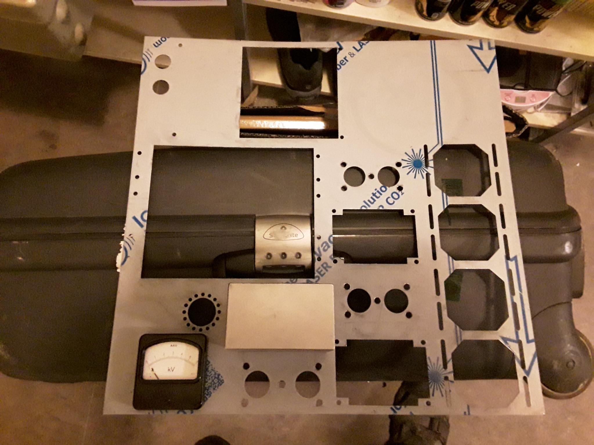

P.s i can make a stainless steel plate like the one in the attachment to check if everything fits before using red copper in about 30 minutes. Figuring out the position and dimensions of the holes takes much longer. Other people can develop circuits like Ian does. Not many people can do both.
