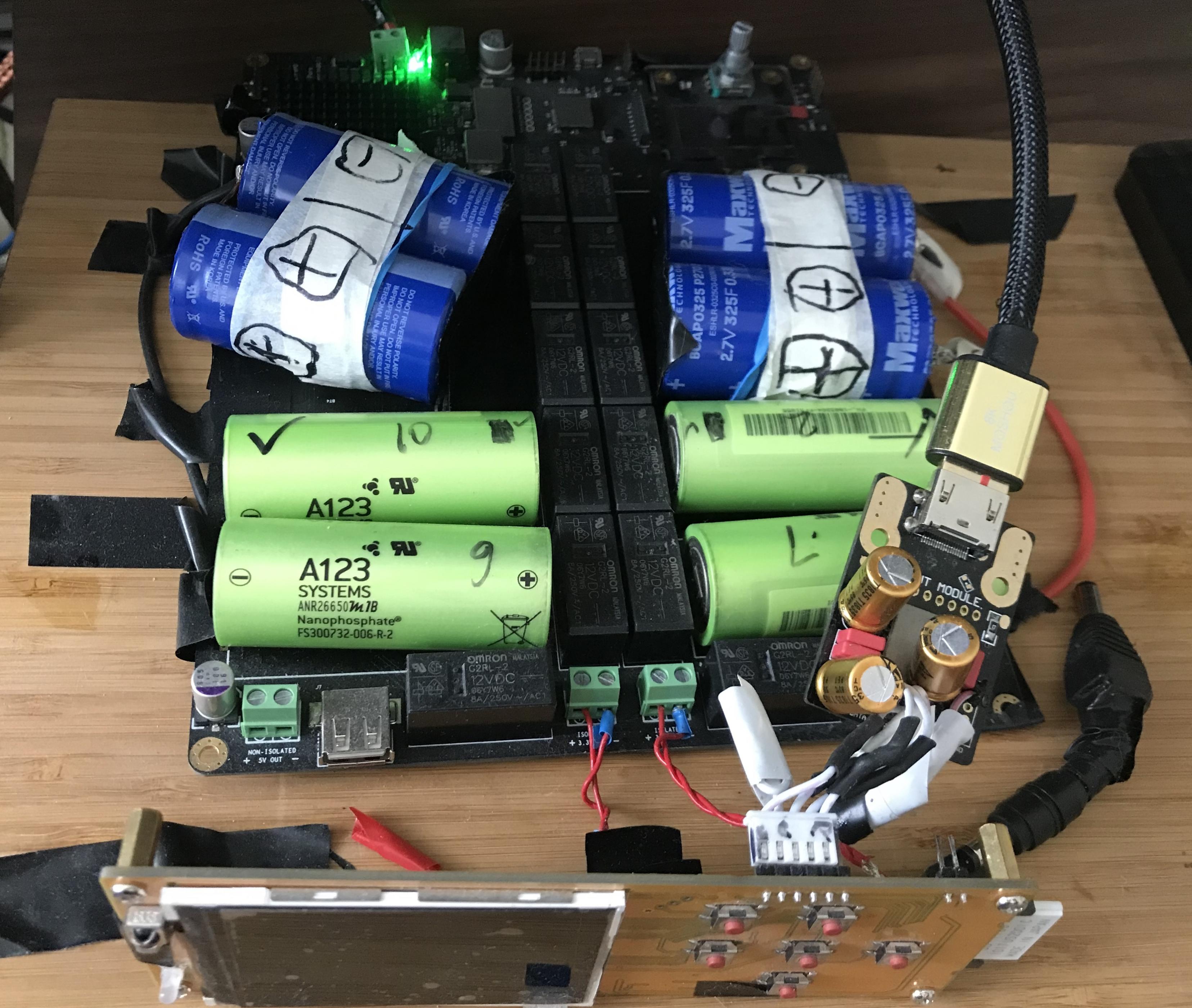

Upgrad my system with UcMateConditioner, UcHybrid and UcAdapter
I upgraded my system today, the power supply section is now:
1. LifePO4 MKII
2. UcAdapter PCB
3. UcMateConcitioner (5V)
4. UcHybrid (3.3V 4x)

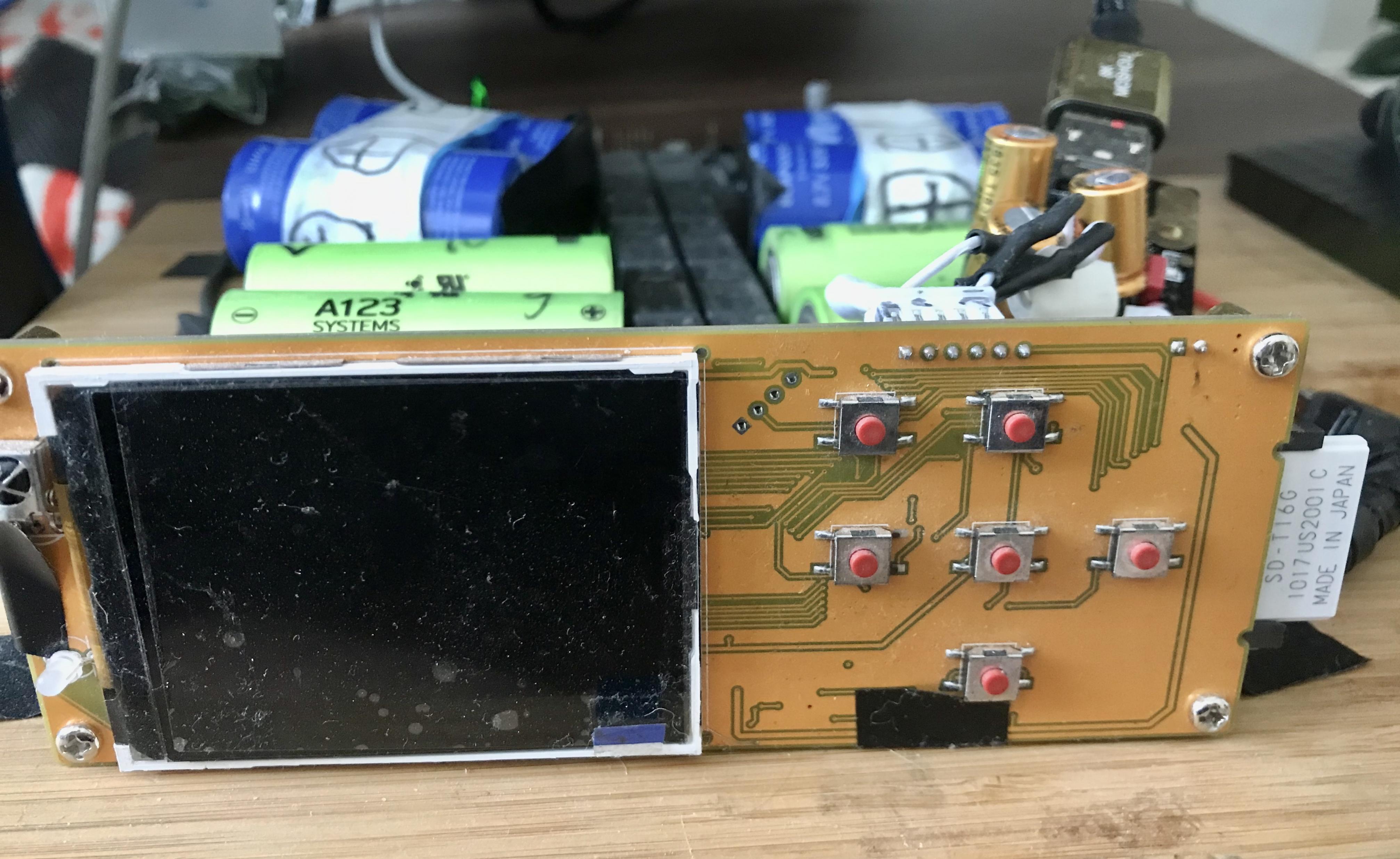

The upgrading job was pretty easy and straight froward. Both MKII and MKIII are good to go. MKIII will have some dedicated connectors. The integration was seamless. When I turned it on, everything was OK. The blue conditioning LED started lit in a couple of second. No smoke, no fire😀.
I have some new discovery and still feel the improvements.
The small board behind my PRi DAC stack is my HDMI receiver board. I use it to receive the true DSD signal the I hacked from my Oppo bluray/SACD player through ReceiverPi.
UcUpgradeKitIntegration by Ian, on Flickr
UcUpgradeKitIntegration1 by Ian, on Flickr
Ian

I'm looking to add 2 more 3v3 rails to my LifePO4 MKII, looking for fuse holder / fuse suggestions.
Thanks,
Aguaazul
Thanks,
Aguaazul

Just made this for mine, board is 25mm wide and will fix to relays with double sided tape. Fuse is 5 amp fast blow, fuse holders were in the spares box.

In reply to your request concerning height of the Mk2 board; I assume same as Mk3, height from bottom of board to top of battery holder is 30mm. There are up to 2.5 mm high SMD components under the board.
Martin.
