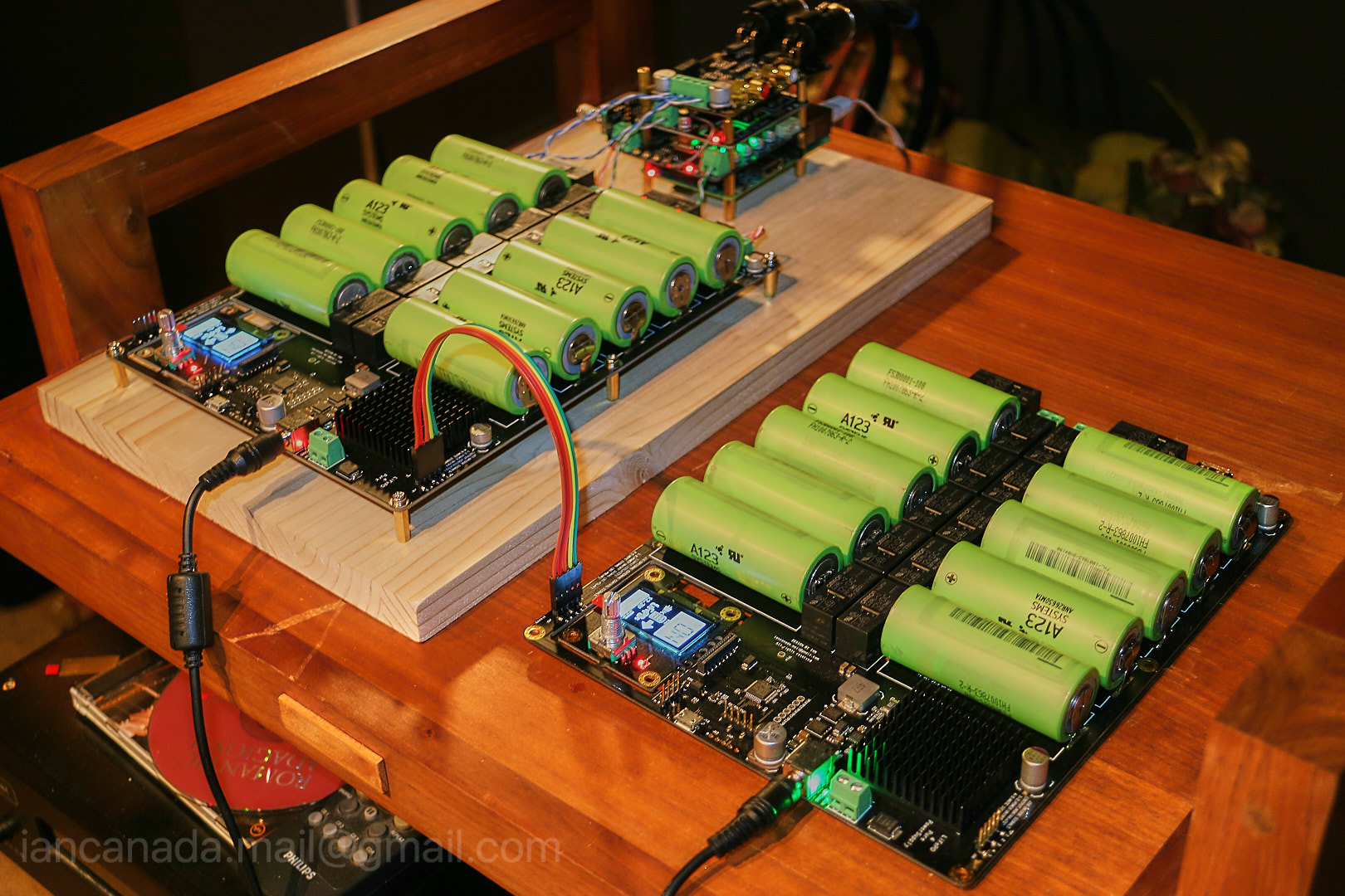

More LifePO4 power supplies bridged together
Two or more LifePO4 power supplies can be bridged together to get more rails. One is master, others are slave. Only need a simple bridge cable. No any other setup.

Stack on top each other LifePO4 pure power supply
I like the way that two LifePO4 pure power supplies stack on top of each other. One master and one slave. We can have 8 isolated battery rails and 5 linear rails in total. This configuration can save a lot of space, looks very compact :D
Having a good power supply system has never been as easy as this.

This looks really fantastic!
In this configuration, would one only need to check the screen and controller in the master power supply or both of them need to be used/monitored separately?
Also, would it be possible to use only one dc charger to charge both powersupplies simultaneously (through the bridge/patch cable connecting them)

It looks powerful!
@syracuze,
Only need master for the on/off control. Settings are independent from each other.
Two LifePO4 pure power supplies can share same DC input. Make sure it has enough current. All battery rails are isolated and has no business with the DC input.

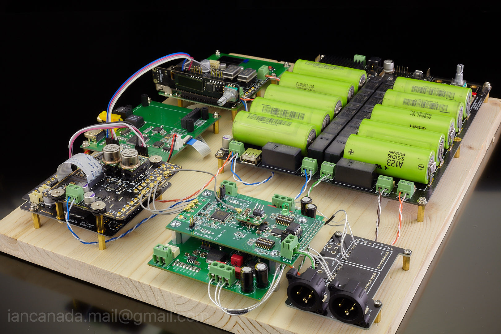

Weekend project
I built a DAC project this weekend.
1. LifePO4 power supply
2. Buffalo III SE DAC
3. Mercury I/V stage
4. McFifo
5. McDualXO
6. S/PDIF receiver
7. RPi
8. FifoPi (as DoP decoder and I2S 16bit to 32bit converter, this function could be integrated into McFifo later)
9. Ess controller as music format analyzer/monitor (optional)
To build a DAC project has never been this easy. I mean top quality. Because no need big transformer/s and capacitors and complicated power cables any more.
