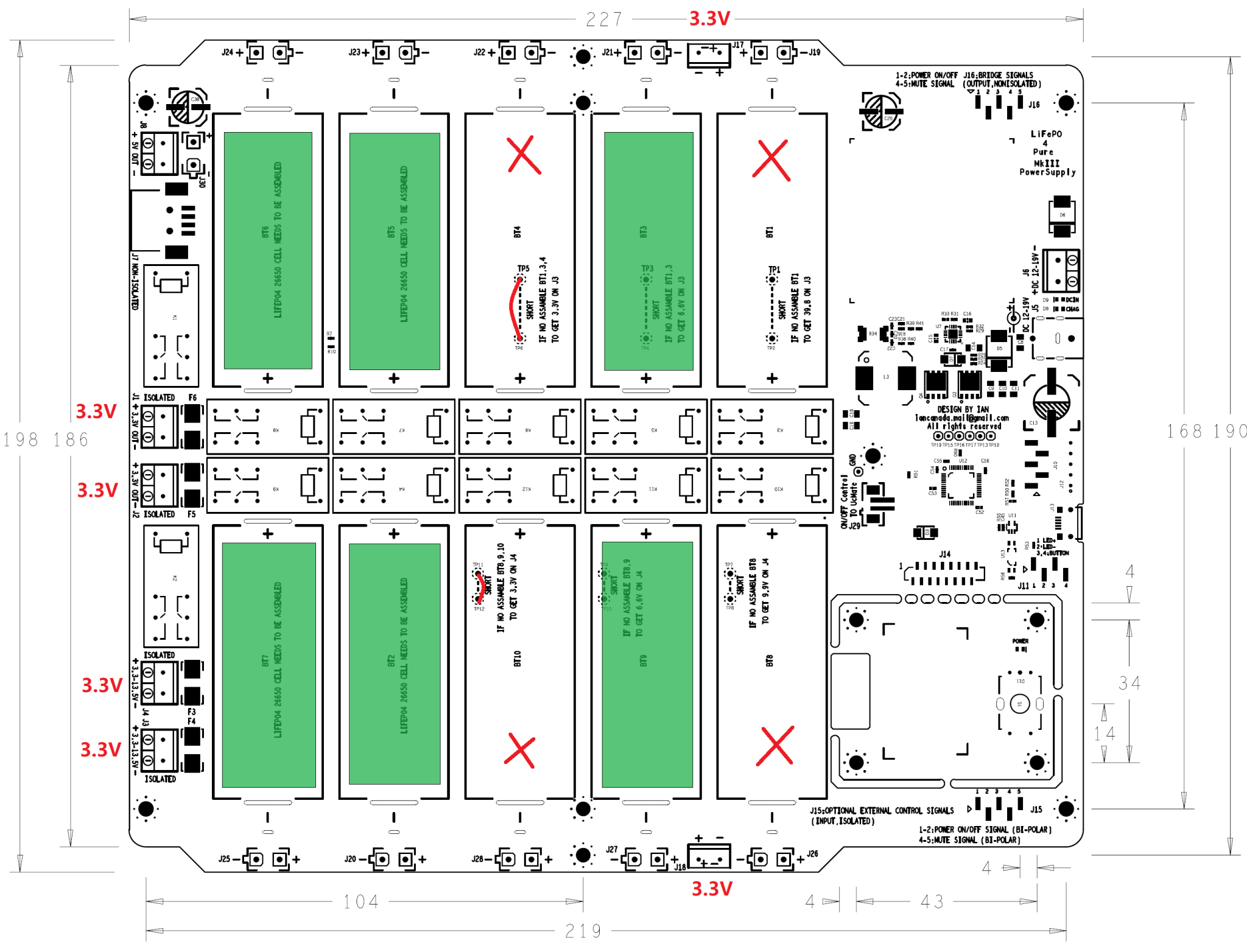

is it possible to use all 10 batteries so that the 3.3 volt batteries have more energy before they need to be recharged?
so far I only use four out of 10
I doubt it. @iancanada recently posted a configuration of six 3.3V:
Since I was only aware of four isolated terminals (2 3.3V [J1&J2] and 2 3.3V-13.2V [J3&J4]), I would of assumed four would be the max for 3.3V.
I had no idea there were even terminals (J17, J18) on the side.
Ian, is it possible for more than six 3.3V outputs?

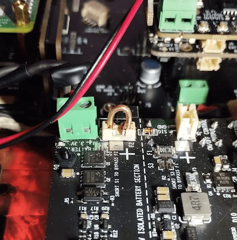

S1 & S3 are where you solder a link to bypass the adjacent fuses for possibly better sound, but some risk.
Greg in Mississippi
The above is part of a post about the PurePi. As for some reason (maybe the presence of a UcConditioner?) my PurePi II's 5A Littelfuse has actually blown, and as it takes some time to replace it (given limited availability in Europe): what does the "some risk" amount to"? Worst case?
Did anyone here bypass it?
I just temporarily bypassed it like this:
but am a bit reluctant to start up the streamer...

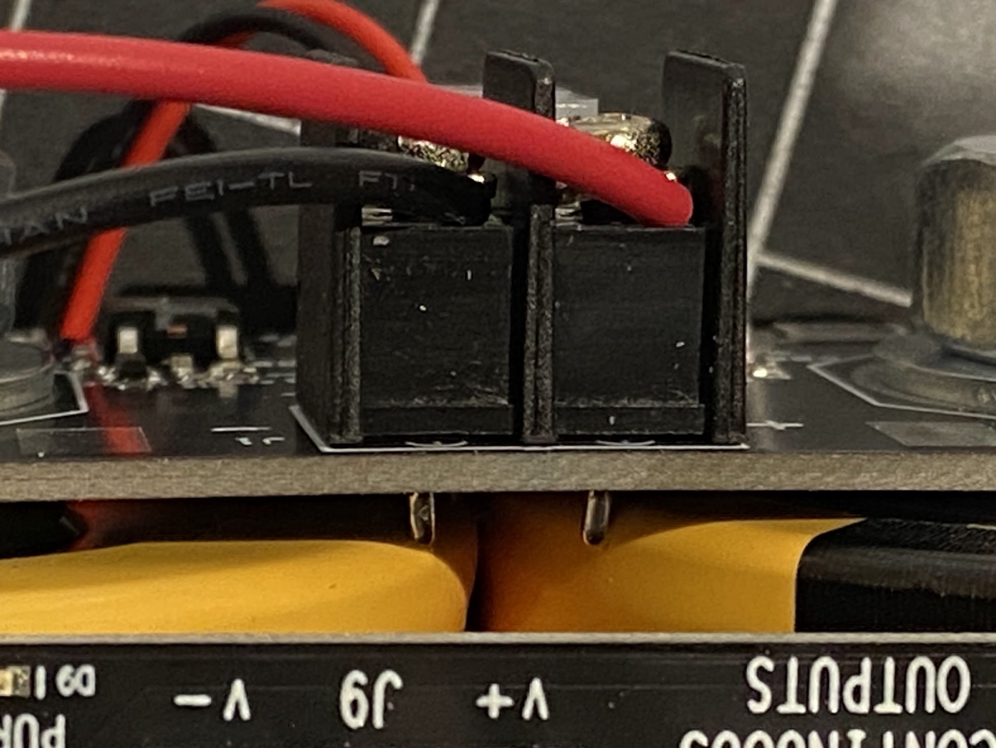

UcPure/UcBalancer troubleshoot case
issue: UcPure in 5V configuration, one of the ultracapacitor can not be charged and always keeps 0V.
Finally the reason was found.
The pins at the back of the UcBalancer PCB touch and break the yellow film of the big capacitor and make a short circuit. Please see the pictures for the issues.
Fix:
Discharged all the ultra capacitors to 0V, cut the UcBalancer connector pins it they are too long, or installed more washers. After that it works fine without any problems.

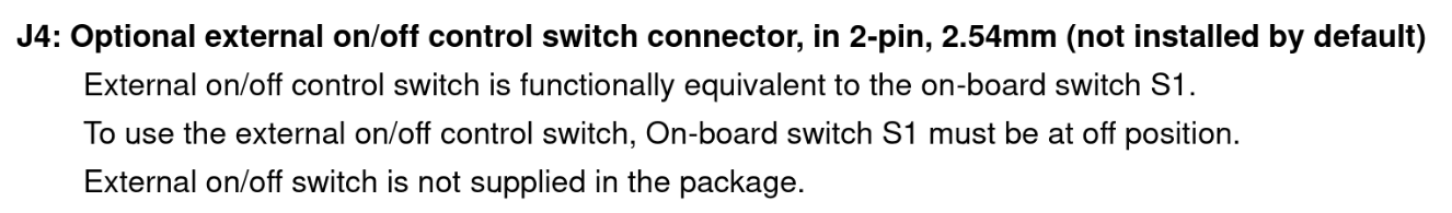

LiFePo4 Mini 3,3V PWR supply trouble w. switch "S1"
Dear all. Maybe someone is able to help.
Im using a LiFePo4 Mini 3,3V followed by UcConditioner3.3V to power Q7 for my Rpi streamer.
The problem is, that switch "S1" broke - nipple broke off so I can't turn LiFePo4 Mini on/off anymore. 🙁
The manual says that J4 could be used as an alternative input but switch "S1" has to be in the "off" position. Since "S1" is not switchable anymore I took it off the PCB.
I soldered a 2 pin mini terminal block onto the PCB at position J4 with a new on/off switch.
The trouble is, that the switch has no function. I makes no difference if the switch ist turned "on / off". The minute power is applied - the LiFePo4 ist powered with AC 9V at terminal block "J2" - which I added - "J7" (switched output) has 3,3V present. I even tried with DC 5V on USB connector "J6" (not at the same time).
Since I can't find any shematics (circuit diagram) for LiFePo4 I raise my question for help or a solution here. 😉
Thanx in advance for any hints.
Christian

Don’t the “S1” switch have to be in the on position, in order to use the external switch?
I think it is like that on some of Ian other modules…
Before any attempt, what does the manual say?

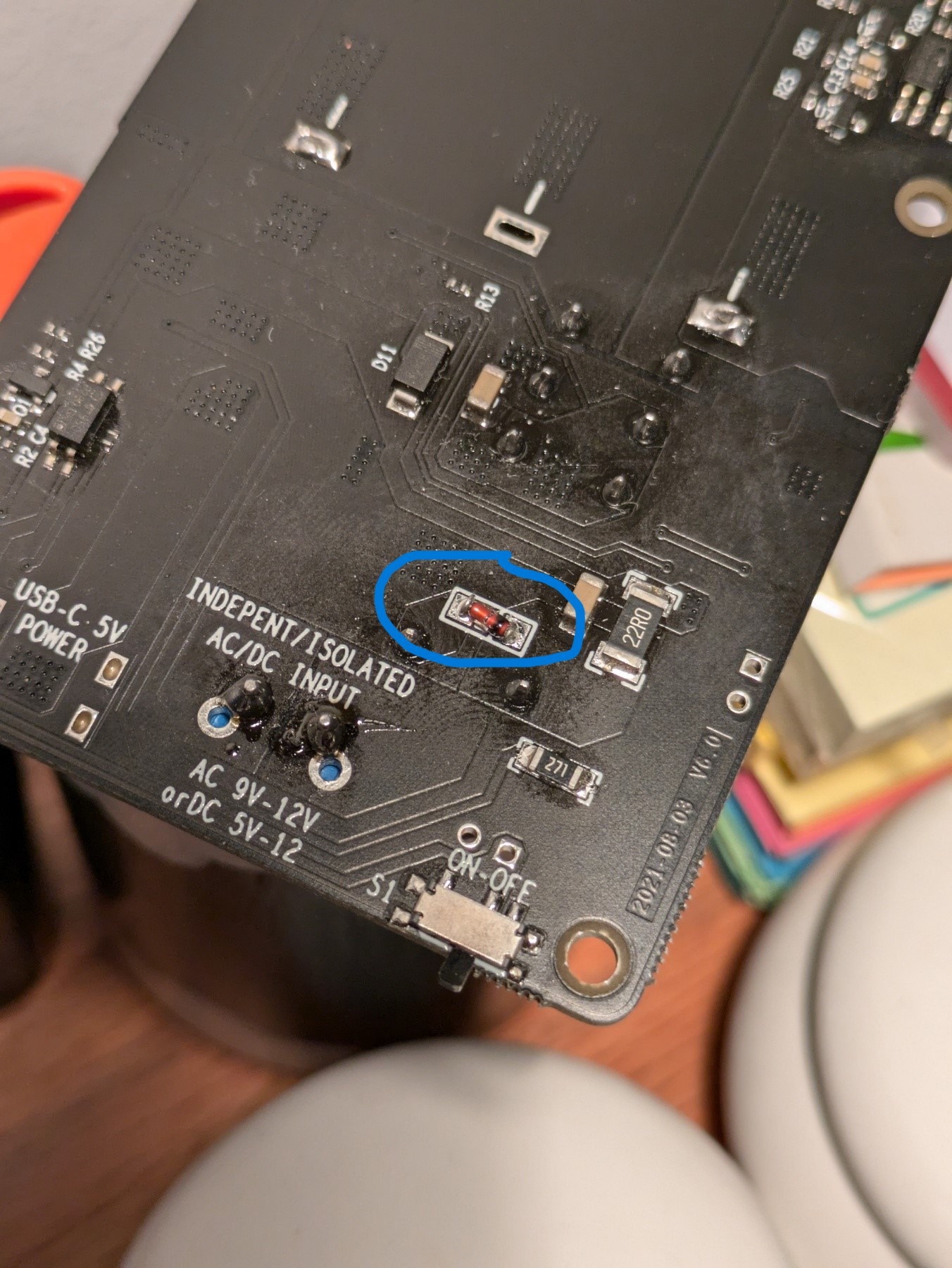

My UcPure power on/off switch broke too. The switch is still there but it's flushed with the PCB, so luckily I was able to use a small screwdriver to turn in on and off again. The UcPure is legacy, one of the first ones produced so I guess it was fragile. The newer UcPures have a on/off dip switch and now I know the reason why.
I tried a external power on/off switch, but no luck. I'm giving up until the Summer to work on this since it's very, very low priority, but for the UcPure the power on/off switch is suppose to be off.
So I recommend double-checking to see if the power switch is still there, but flushed. You can possibly dig in with a small screwdriver. If it works, it is much easier to troubleshoot and possibly glue a switch together as a last resort.

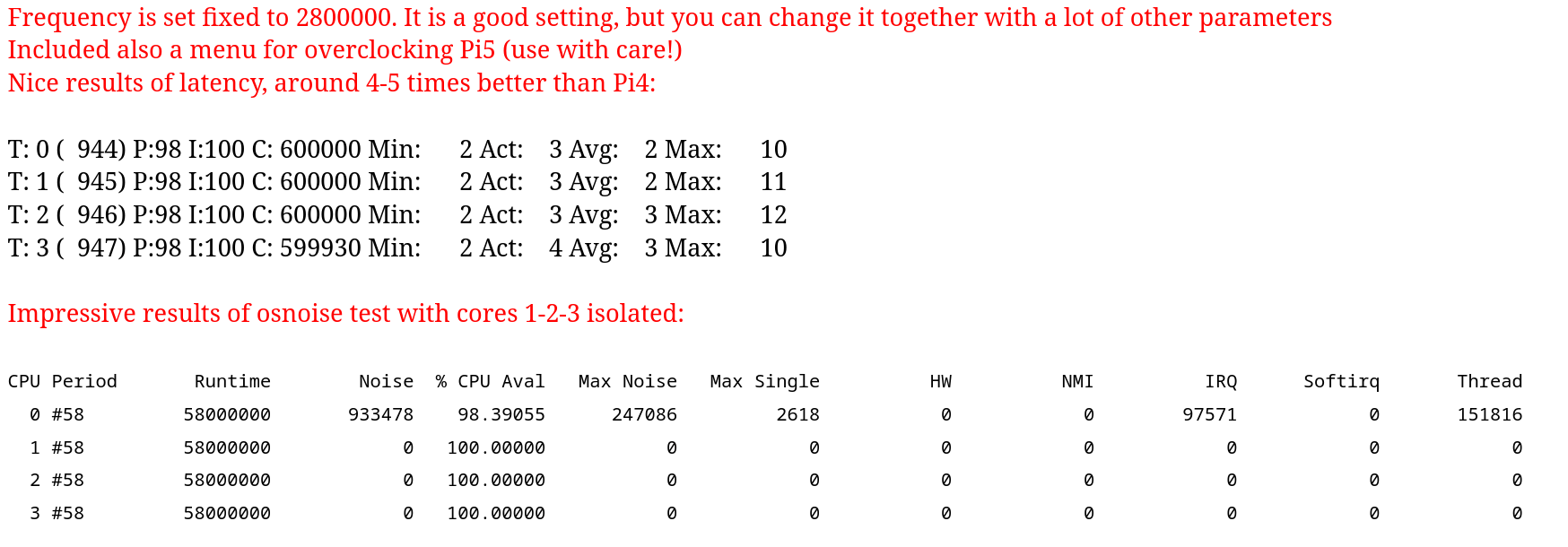

On a non-related Power but Optimisation issue, I'm happy to report I'm RPi5-ready as my Audiophile OS is freshly installed after implementing GB2023.
Once I receive the RPi5, I can just physically replace the RPi4 and install a new RPi5 realtime low latency kernel and I should get 4-5X the low latency performance than with the RPi4 @ 2.8GHz RPi5 CPU. I was hoping 3GHz, but I'm good @ 2.8GHz.
I dedicate CPU cores 1, 2 and 3 just for Audio so the osnoise test looks nice. CPU core 0 is for general OS tasks. Then I'll really be done until GB2025.

I am in process of assembling the power unit of an Ian Canada streamer. During testing LifePO4 Mini 3.3V, it appears that I burned the diode below the board (please see foto). Can you help with the type of diode in order to purchase a replacement?
Separately, I used LinearPi MkII (5V) to supply J2 input of LifePO4 Mini 3.3V. It appears that power is not enough (batteries seem do not change). From the LifePO4 Mini 3.3V manual, I see that it requires minimum 5.5V supply.
Is there a way to make LinearPi MkII (5V) supply LifePO4 Mini 3.3V? If not, what kind of supply should I seek for LifePO4 Mini 3.3V?
Thanks a lot in advance.
Theodoros

I had the pleasure of building a DAC with Ian's gear some years ago and have enjoyed the music without a hitch ever since.
Unfortunately that came to a quiet and mysterious end today. All I have now is the red LED on the LifePO4 Mark III board flashing every second. No green LED, no screen, The 19v supply is OK, connections to the board are OK, all fuses are OK, I can't see any evidence of shorts etc. No voltage on 5v or any 3.3v.
I have no idea where to start looking for a fault.
Any comments would be welcome.
