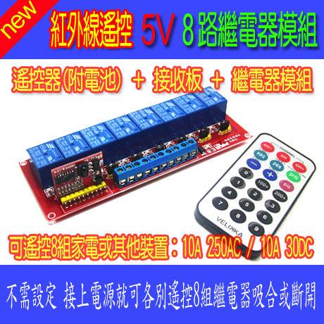

Why not buy an RF module for an option? The RF module in this photo is only for $2. Taobao can bought a remote control module that supports Android phones.
