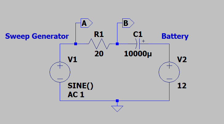

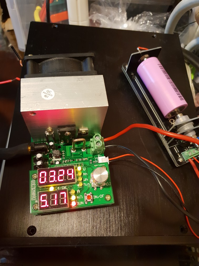

To measure the internal resistance of a battery below 10m ohms, you need to use a precision resistor to compare. For below 10m ohm of batteries, there is no simple and cheap way to measure.
First, measuring battery impedance at DC is of little value for audio. A battery with 50 milliOhm Z at DC may have impedance of 500 milliOhms at 10kHz. PSRR is thus severely compromised.
Second, measuring battery impedance does not require an expensive set up. The routine shown in Walt Jung's article "Regulators for High Performance Audio, Part 1" Figure 2c can measure impedance down to a single microOhm. A 1V sine signal through 20 ohms is sufficient (I pick 20R as that's the internal impedance of the AP Analyzer. (You don;t need an AP analyzer, just a sweep generator and scope with XY inputs). Sweep frequency from 10Hz to 1MHz
Second, measuring battery impedance does not require an expensive set up. The routine shown in Walt Jung's article "Regulators for High Performance Audio, Part 1" Figure 2c can measure impedance dotwn to a single microOhm. A 1V sine signal through 20 ohms is sufficient (I pick 20R as that's the internal impedance of the AP Analyzer. (You don;t need an AP analyzer, just a sweep generator and scope with XY inputs). Sweep frequency from 10Hz to 1MHz
Is the measurement method you mentioned more expensive? The measuring instrument I mentioned earlier was bought, from Taobao, for only USD $18.
Measuring the internal resistance of the battery is only to determine the battery that is purchased, especially the battery of an unknown brand. Whether it is worth buying, it is not really necessary to determine the true internal resistance of the battery.

Read the articles by Walt Jung, the guru -- the referenced articles are very easy to find on the web.
Omicron's Bode-100 -- application note: https://www.omicron-lab.com/fileadm...impedance/App_Note_Battery_Impedance_V2_0.pdf
