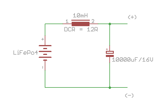

I'm curious if the LC filter (see schematic) at the LiFePo4 output could have positive impact on sound (eg by reducing high frequency noise).
I know that at the other side large capacitor may cause high inrush current which can be a challenge for relays (welding). Is it worth using LC, then?

LC filter will degrade LifePO4 power supply performance. Avoid this configuration.
Please no worry about the large capacitance at the load side, my LifePO4 power supply has special designed delay scheme to protect relays from welding.

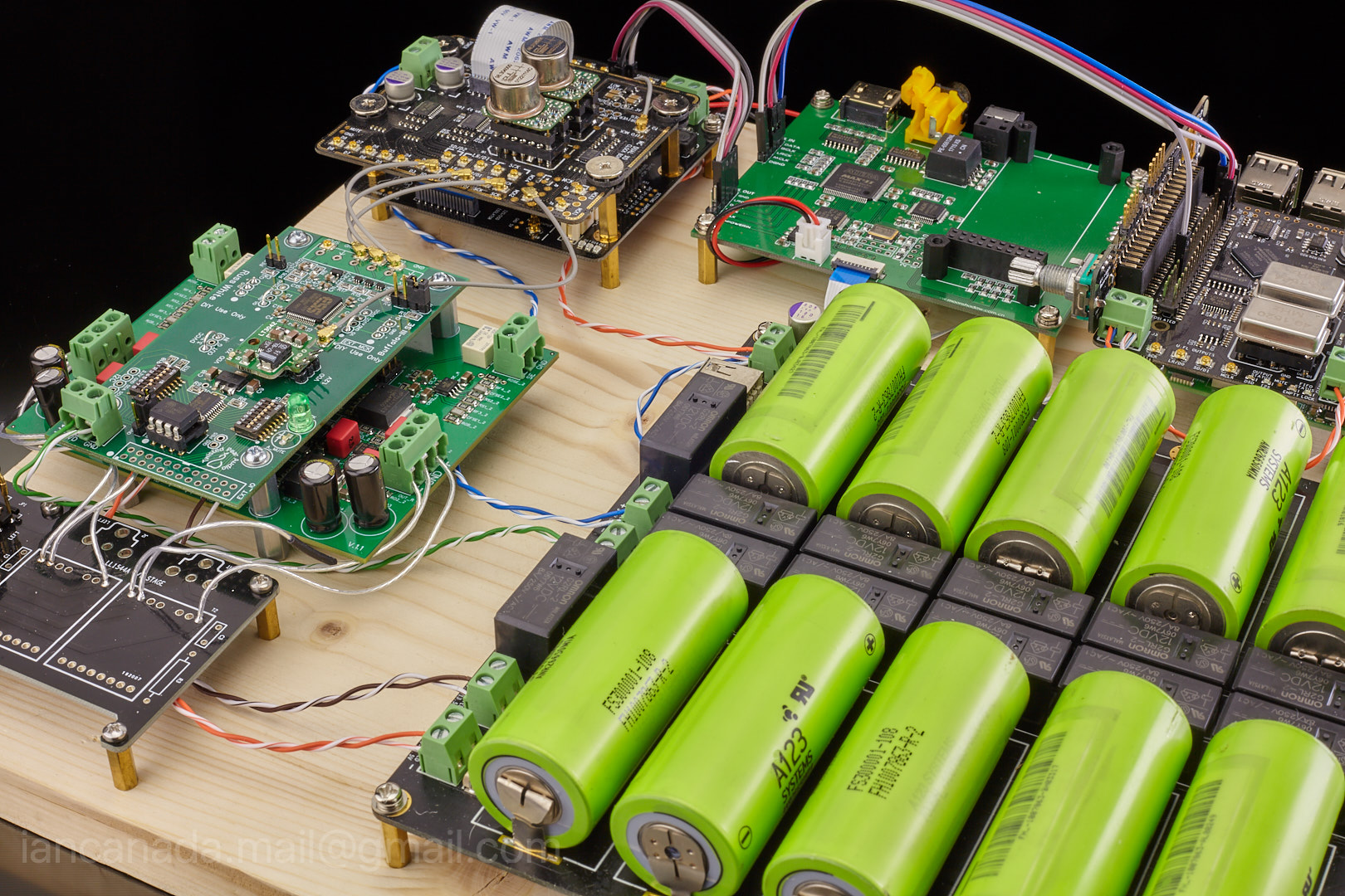

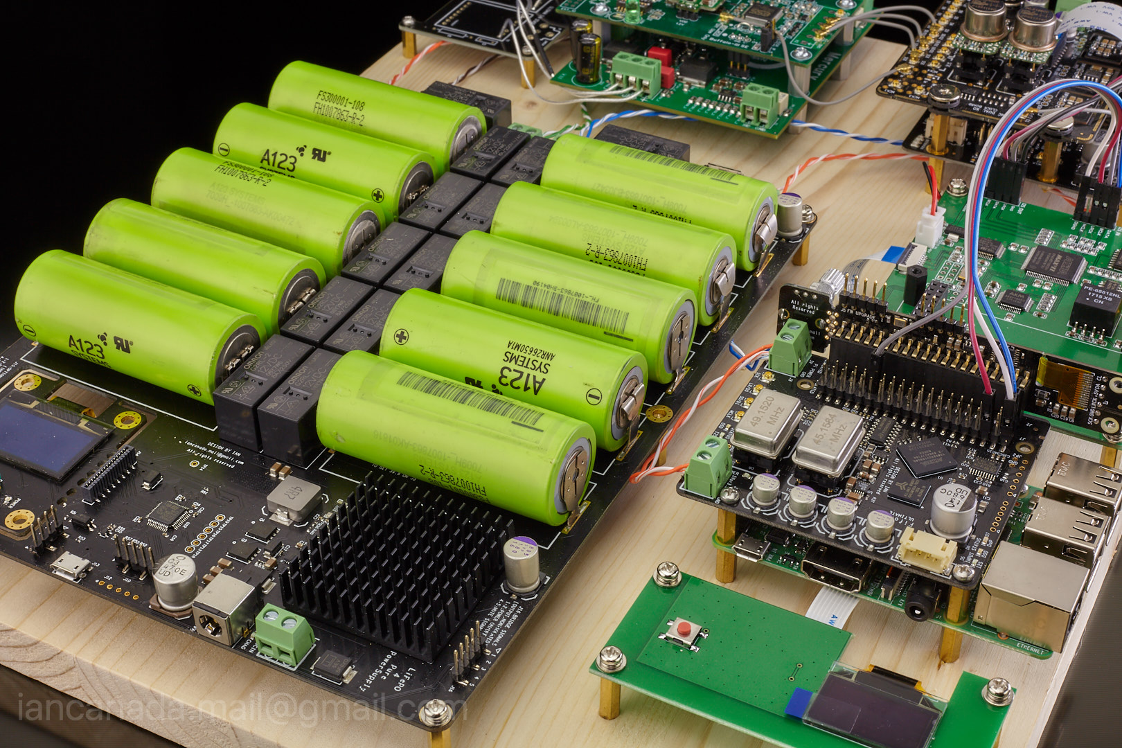

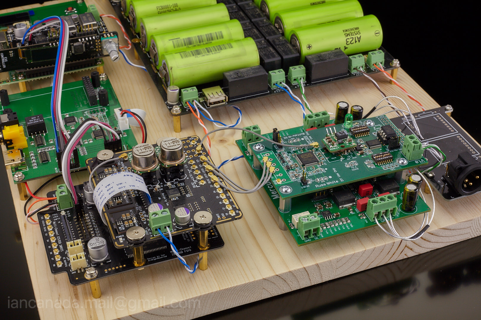

This looks great Ian!
Any chance you could share couple of more pictures of this setup from different angles to understand the wire routing?
@syracuze
More pictures from different angles.
Ian
It's just a spdif interface, noting special. So, no worry.
I'll do a interface board with everything integrated later when I get time. It's just a functional verification for now. I don't have problem.

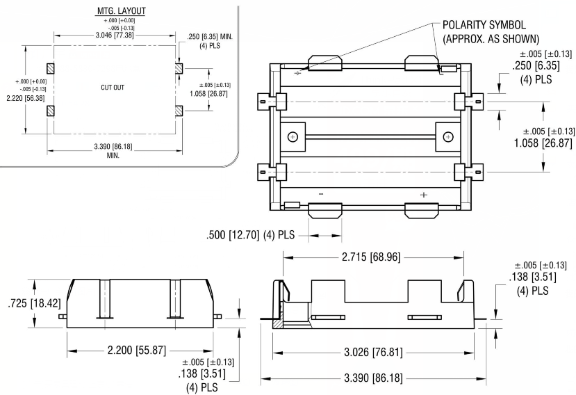

I'll try some 26650 holders to see if thy can fit.

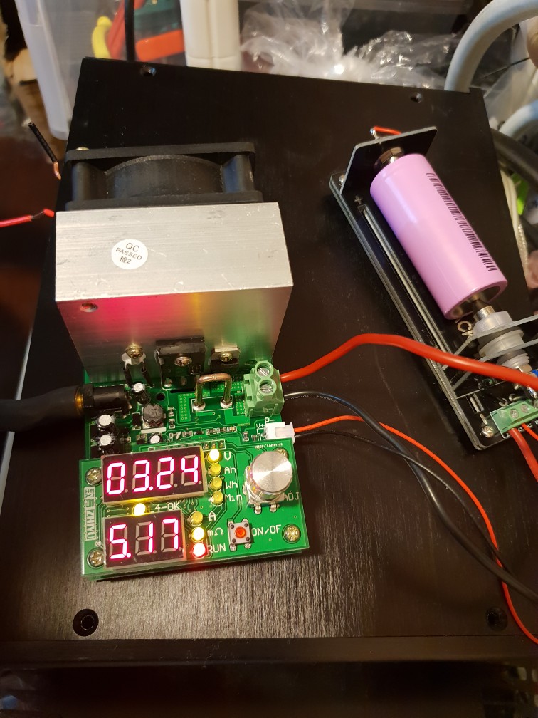

It is hard to solder the battery connector by hand and it is very easy to burn the battery. I have burnt four batteries, and the result is poor welding quality and not secure enough. The conclusion is that you should someone help you to solder using the Spot Welding.
I heard somebody using ultra capacitor doing this kind of job. Worth to give a try.
YouTube
Ian
I didn't expect it to be that simple. I just ask the store that sells the battery, according to my needs, help me solder for free charge.
The method of this video may be relatively safe.

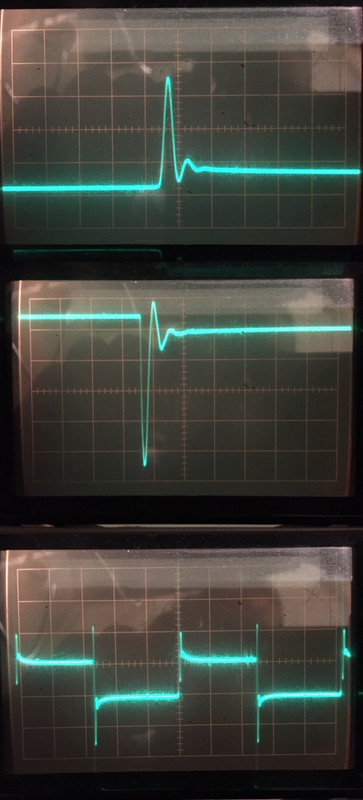

Further to my post #396, I have done some measurements on the LiIon batteries that I use for my cycling lights.
The battery consists of 3 LiIon 18650 cells in series to provide 11.5V. A protection circuit is included but I put the 'scope probes on the battery terminals, thereby excluding the effect of the protection circuit for the waveforms.
With a 10KHz 50% duty cycle i switched 2 test currents: 56mA and 460mA. The waveforms are for the 56mA load, although they are very similar at both currents.
1st and 2nd waveforms are magnified views of the 3rd scope shot.
1 & 2 are at 2uS & 50mV/div
3 is at 20uS & 20mV/div
My estimate of the output impedance of the battery is 420mOhms, that's 140mOhms per cell. The load transient response indicates some (internal) inductance interacting with the output impedance.
I do realise that these are not LiFePO4 cells, but are they much better?
As it stands, I am a bit concerned about the proposed battery PS.
