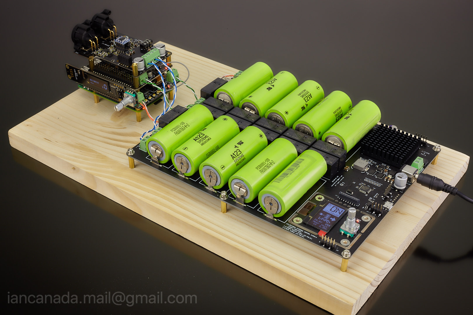

Have you considered over current and temperature control? Maybe someone has a problem with the design module, causing over current and the accompanying high temperatures.
Is there a protective way when the battery polarity is reversed?
These lifepo4 cells can put out a ton of current, 50A continuous per the datasheet. Pretty sure you have some serious problems if you're drawing 50A, and you'll smell smoke and burnt electronics.
I do believe in safety, but it needs to make sense. And I personally would rather a simpler circuit instead of an idiot proof one.
Randy
LiFePO are quite safe compared to other Lithium cells. With an undervoltage lockout and an overload protection they should last forever.

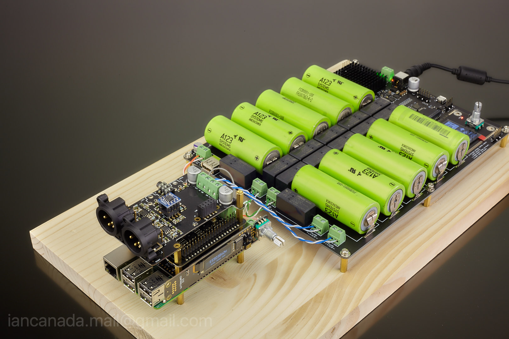

Thanks Jesper,
That's a great idea. This kind of features have already been included in this LifePO4 power supply design.
If you listen to music for only two hours, normally the charge time will be 10 to 20 minutes. After that time, the charger will be stopped and goes into idle mode. The battery life will be extended comparing with charging it all the time.
The ending charge voltage is also under managed. If you just want to charge the cells to 3.35V, you can set it to. The charger will be stopped when the voltage level is reached. In this case, you can also set the sweet spot voltage according to your system and your preference on this power supply.

LifePO4 power supply V2.0 test
I did some test to LifePO4 power supply V2.0 last weekend. I have to say I'm really happy with the sound quality while this power supply is included in my system.
Here is the configuration:
1. LifePO4 power supply V2.0.
Four battery rails:
3.3V,
3.3V,
13.2V,
13.2V,
and one 5V linear rail.
2. RPi with Volumio software.
3. FifoPi with Crystek CCHD957 45.xxx/49.xxx MHz XOs.
4. Dual mono ES9038Q2M DAC running at sync mode.
5. ESS controller running at isolated mode.
6. OPA1632 fully balanced I/V stage.
I was not very happy with the sound style of OPA1632 I/V stage before. But this time, I listened to it for more than three hours without stopping the music. With this LifePO4 power supply, I realized what is the the true sound style of OPA1632. The sound stage is wide and deep with so much details, full with atmosphere. It's the first time I run this kind of active I/V stage from batteries. Something really surprised me.
Another thing I have to mention again is that now the whole system is very clean. No more huge transformers and capacitors, much less internal cables, no longer needs special grounding considerations because all battery rails are isolated.
Now I'm pretty confident to run a small production to make it available to other community members.
