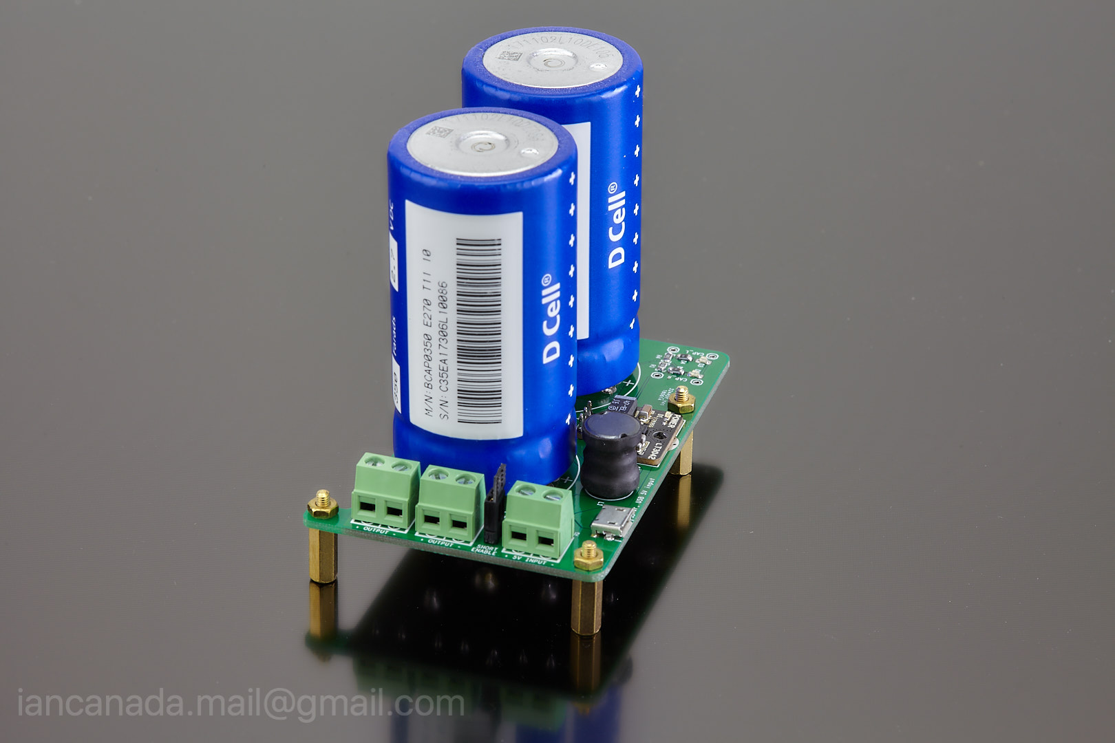

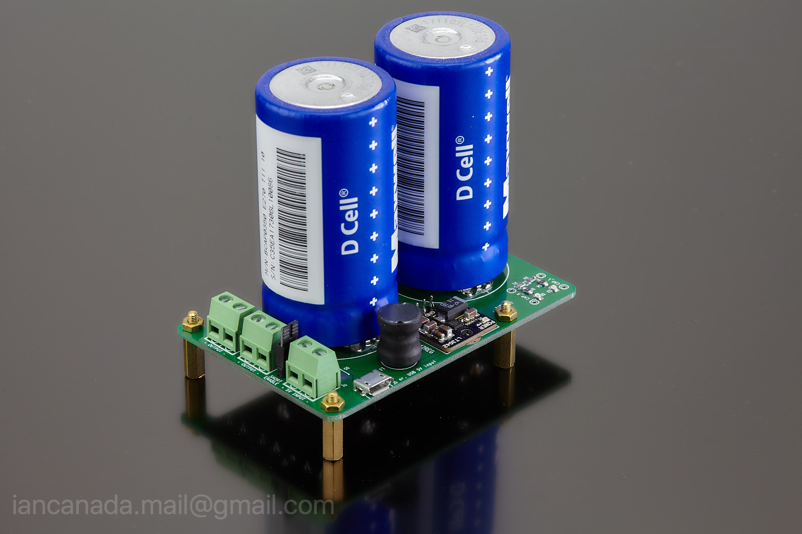

Busy working on adding more features, such as short circuit protection and low battery protection and so on, almost done.

Shcematic of the sharing ultra capacitor power supply PCB
I think the sharing LifePO4 explore PCBs are all received. Here is the schematic for reference.
All optional components can be left nu-assembled. The schematic is simple and flexible.
The UCPi can also be switched between floating charge mode and pure mode by plugging and un-plugging the DC input.
I may not have enough time to provide more support. It would be very appreciated if any body can sharing his experience in this thread to help other community members.
One important thing I have to mention here is the safety. Ultra capacitors can delivery more than 100A of current. It would be dangerous if short circuit happens. So, please be very careful.
Good luck to experience ultra capacitor power supply.

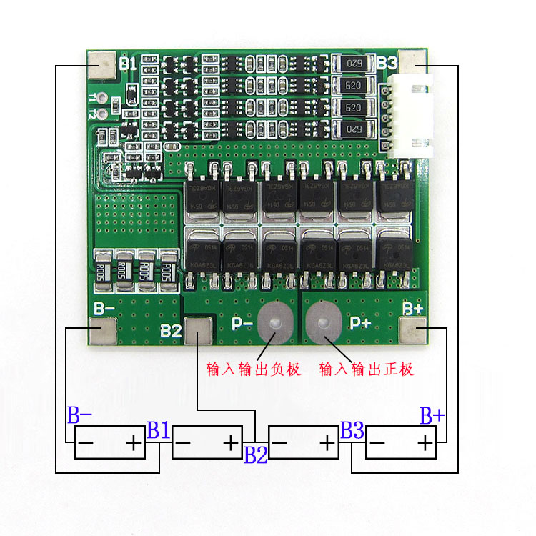

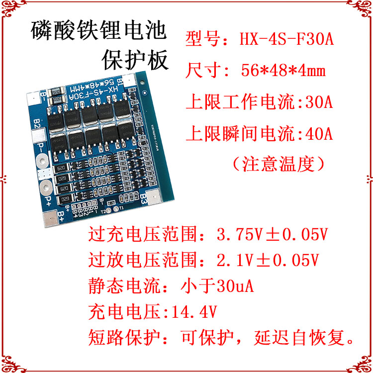

me too! However, before enjoying Ian's LiFePO4 battery power supply, I will try to DIY LiFePO4 battery power supply by the board integrated both of the battery charge management and the battery protection, only for $2 for one rail, from Taobao.
3.2V ????????+????? 2A?? 3.6V ???????-???
4?14.8V?????? ??? ??12.8v????????? 30A-???

However, everything involved in the power supply must be very careful, especially for automotive power batteries that can output very high currents.
After a period of searching, I found a lot of LiFePO4 battery power supply for cars, they are large, mature, stable and low-priced modules. I just share my experience.
Everyone has their own choices, but everyone is responsible for their choices. Ian can also purchase these battery modules for cars to analyze the characteristics of these industrial production modules to improve the reliability of his modules or be proved that Ian has considered all the parts of the consideration.
