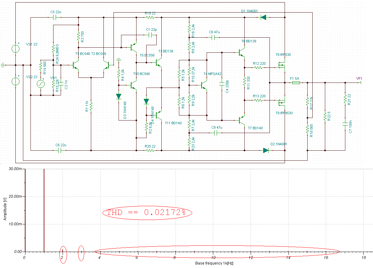

Destroyer x Amplifier...Dx amp...my amplifier
Attention...the gain resistor must be tweaked in an obsessive way
Inject 1Khz tone and check the output with a scope to be sure that with the same signal level the power output will be the same power.
Do not saturate your ears.... avoid sound reflections in the room....use 1 watt one meter distant (speaker)
Sit in a safe way.... or you gonna fell down from the chair.... so big gonna be the surprise after you check your evaluation referenced to the real amplifier that were playing.😉
You gonna be, at least, deeply surprised..... the work to build and adjust the stuff will worth as will show you something you would not believe if i try to tell you.

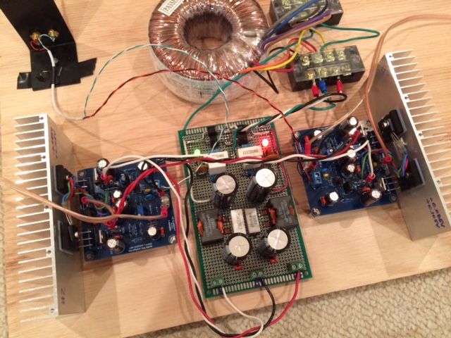

Thanks for the detailed analysis. I will have to get that Vr19 for you. I wonder if the problem is the incorrect transistor, but I have to wait until I get a 35v power supply to see if it makes a difference.

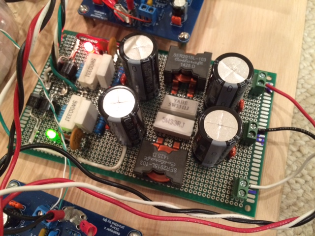

I finally got all my parts to build a Dx power supply unit with a 250VA 25v toroidal transformer. The Dx PSU went together pretty nicely with four Nichicon 4700uF caps, and I since I did not have any 1mm magnet wire to make the choke, I used some extra Coilcraft flat wire 10uH inductors from my class D amps. The PSU puts out +/-37 volts and ripple was measured at 6mV with no load - pretty good I think.
Applying 37 volt rails finally allowed me to see voltage across the 0.33ohm emitter resistors. I set it for 100mA quiescent current and adjusted offset to about 1mV and it is stable.
Playing music on it now - real nice. I think I did not have enough bias before so it sounds real clean now.
Schematic of PSU:
So it seems all my problems were from result of not using a high enough voltage power supply.
Thank you Carlos for a great sounding amp and clean power supply. 🙂

I just realized that I am probably running a high bias current of 100mA. Besides added heat output, is there any issue sound quality wise from running at 100mA vs the circa recommended 10mA? Would there be less distortion with a higher bias current?
I have been listening to it for a day now at 100mA and think that this amp sounds great - excellent clarity, super bass dynamics.
You mean another set of 4700uF separated by same RL? I do indeed have more (samples that I will probably not use for class D as they are so big).
So it's not bad to operate at higher bias is you can afford the heat?
Btw, I plugged in my old LM3886 (a stock board with built in dual 10,000uF caps and Burr Brown OPA2604 op amp front end) which I used to think sounded pretty nice) and there is no comparison - the Dx just kills it sound quality wise. The weight of the bass is just not there compared to the Dx. The highs are about the same possibly better with 3886. Maybe it will be relegated to a mid/tweeter amp for my active 3 way system?
Higher bias is normally better if you can afford the heat yeah. If you have those inductors sitting idle then definitely press them into service with another LC stage on the output.
The highs of the 3886 suck in my experience without serious attention to decoupling (many ceramics or low ESR caps across the supplies) and even then I prefer to use a step-down trafo to lighten the load on the amp.
The 3886 obviously can be made to be quite nice with proper attention to detail as seen in numerous examples of reference quality chip amps in the Chip Amp forum. I don't have mod86 or MyRefAmp etc to compare with. I wonder of discret class AB amps will generally have better bass authority. I think their ability to provide a large current has to be better than a chip amp if using big fat OPS transistors.

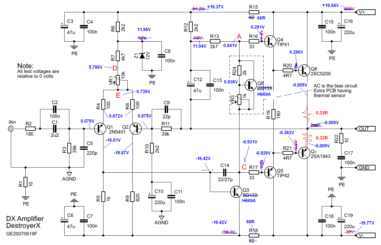

Here are the test point measurements you requested. This is with inputs shorted and no load of course.
Thanks!
536154d1457417392-destroyer-x-amplifier-dx-amp-my-amplifier-dx-amp-resistor-schematic-test-points-20v.png
I see you have the dummy resistor in the unused leg of the LTP. This was first investigated by member SandK many years ago. The idea was to equalize dc operating voltage at LTP collectors to equalize the affect of Early Voltage. I remain sceptical.
And still no AC bypass cap across the Vbe ? What secrets are you employing here Carlos ? 🙂
