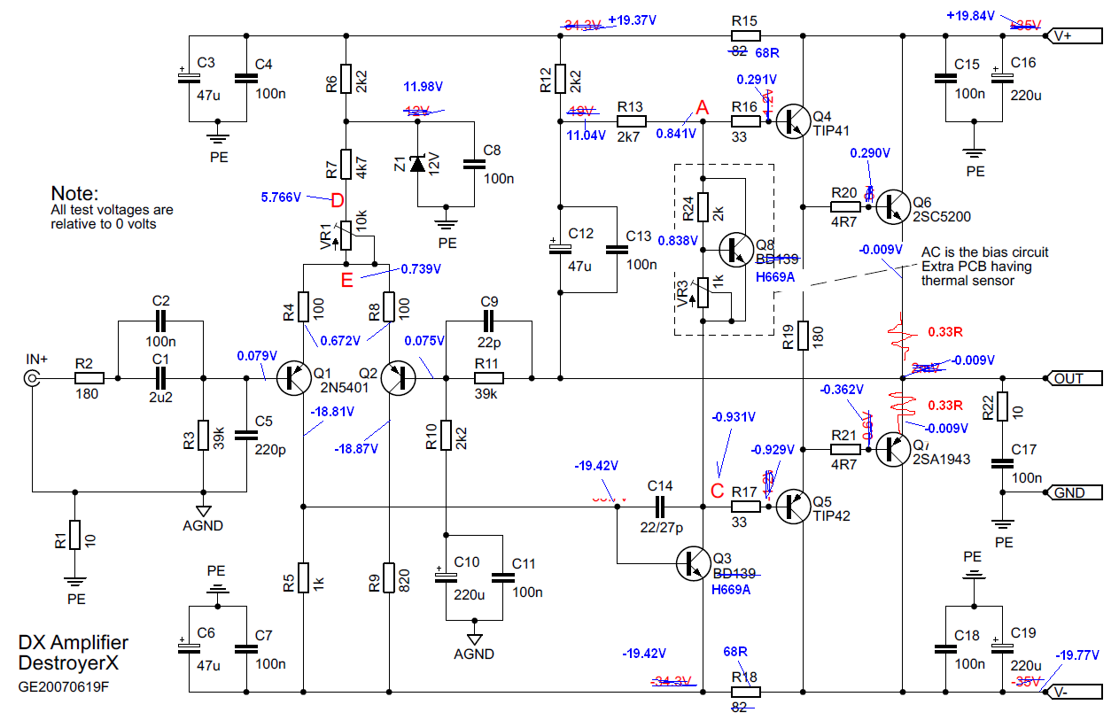

For lower rail voltage R12 and R13 will need to be scaled down in proportion to provide the required current for the VAS stage (Q3). This may prompt you to increase C12 to 100uF.
And R6 should also be reduced so that the zener regulator for the LTP has enough current. It's more usual also to see a cap across the Vbe multiplier (points A and C) but Carlos may have had reasons not to.

Post 7477 pic:
take off the voltage measurements for the ±37Vdc supply rails and insert your measurements with the ±20Vdc supply rails.
Include measurements across the input LTP and the input offset voltage.
Here are the test point measurements you requested. This is with inputs shorted and no load of course.
Thanks!
Calculate the currents through R4, 5, 8 & 9 check how well balanced the LTP is.
All the Vbe around the LTP look OK. Note the input offset voltage = +79mVdc. This is normal for a PNP LTP.
But the balance of emitter voltage does not agree with the imbalance of the collector voltage. Did you match 100r? Did you match Q1 to Q2?
Something wrong with the -19.42Vdc shown at the base and emitter of Q3
Q3 is the wrong device for the second stage.
Calculate the currents passing R12, 13 & 24
Calculate the Ic of Q8
Vbe of Q8, OK, but Q4 shows zero !!!!!
Vr19 missing. When the second stage is working properly with the correct current then Voltage A to B is the bias voltage. When the output stage is turned on Vab is ~2.3V
and Vr19 is ~1.2V
When you start up with the bias voltage turned right down, Vab <1V and Vr19 ~zero
Calculate current passing R16 & 17. That's the base currents of the driver stage. Something wrong.
Calculate the output base currents.
Calculate current passing R15 & 18. That's your front end quiescent current.
It is the currents and Vbe that are important.
I recommend you change R2 to nearer 1k and/or increase C5 to 1nF

I'd say -19.42Vdc on base of Q3 is a typo as on the same net there is -18.81V which looks right.
Thanks, good catch. Do you have an opinion of suitability of the H669 transistor substitution for BD139?
I don't have much useful data for 139, so I can't assess it's suitablity for VAS.
You should be using a highish gain, that is fairly linear, ultra low Cob and preferably a high Early voltage (Vaf)
a1360/c3423 does this job
A d669 is a very good driver, if it meets the Hitachi specification.

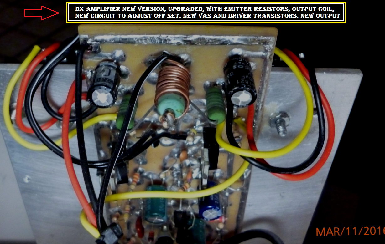

If you're still looking for debugging help with your schematic, everything looks fine except for the voltages around the H669A bias spreader. Its not generating enough voltage to bias your OPS. Could there be a faulty transistor or an error in its pinout? You have 1.7V between B and E which either means its blown or its pins have gotten swapped.
Thanks for the tip, let me try swapping that with a fresh one. I will also check the pinouts. On another note, I just finished debugging my Pass ACA amp. It's working now and sounds very nice. Problem turned out to be an error on the pdf diagram of the PCB trace layout. I used that to wire my PTP board and the pot is connected to the wrong cap in the drawing.
What should I be measuring?
Q8 - the one with the preset pot next to it.

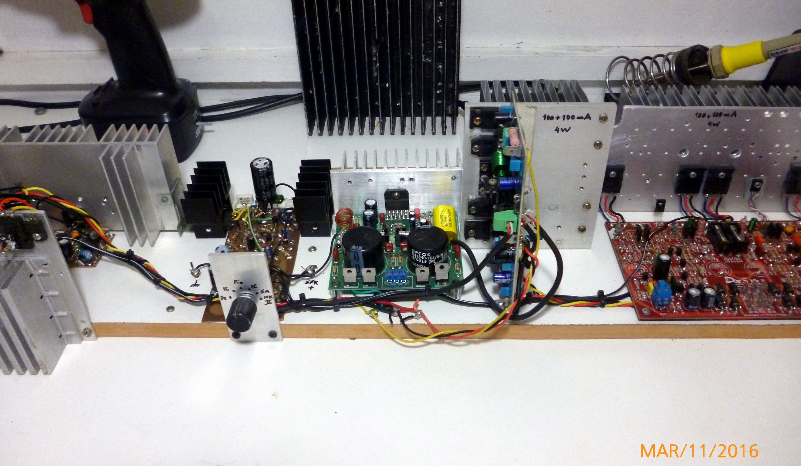

I have tested these transistors, not only 2SD669A but also MJE340/350
Sound was a little bit better in highs..... or.... i convinced myself that was better without make A/B comparison.
A lot of ideas colapsed to ground when i made A to B comparison....blinded ones, because other methods are fool in methods.....just serve to ourselves to reinforce hypothesis we have created to support our own beliefs.... when we make A to B, real stuff appear.... reality becomes something you cannnot doubt.
These transistors, and many others, finished died, shorted, damaged, after my traditional torture tests.... i do not have them anymore.....so..... they died.
MJE340/350 also died...but i keep one pair when i have my own doubts..then i install as VAS in one channel to compare with the second channel....and then i realise, again and again, and once more, and twice, that BD139/140 are unbeatable into this range of supply voltage..... TIP41/42 really deserves to be replaced...but BD139 entered my amplifiers to stay.
Never believe in thoughs.....never believe in faith...... test all your ideas...do comparison tests and you will be surprised how much we can fail related our pre conceived ideas.
Photo show you the "Comparator"..... make something alike and you gonna be surprised with your conclusions...same signal entering...all amplifiers adjusted to the same sensitivity...same speaker....then ask someone to operate the rotaring switch and take note about your conclusions..... operator will give you numbers and will correlate these numbers with the switch...from 1 to 6.....you will not know what amplifier is playing as he will give you scrambled numbers..not the real sequence..nor the inverted sequence.....if i was not clear.... he can rename 1,2,3,4,5 and 6 as 4,2,6,1,3,5 .... this way you have not idea what is playing even considering you have built the comparator.... use a clever operator not to switch in sequence...or you will realise what is going on..... understand, in advance, that you are clever and you will try to discover all time long what is playing...this is human nature.
Do it...... and you will see the reality in a different way .... and will not trust your pre conceived ideas anymore.
One audio source, several types of songs, one output speaker (at a time), same output power to all amplifiers...same conditions.... a fair comparison.... you cannot know what is playing...instruct switch operator not to modulate voice according to his taste....ask him to be monotone...dark room...listen to speaker and small ligth into your portable annotation book.
