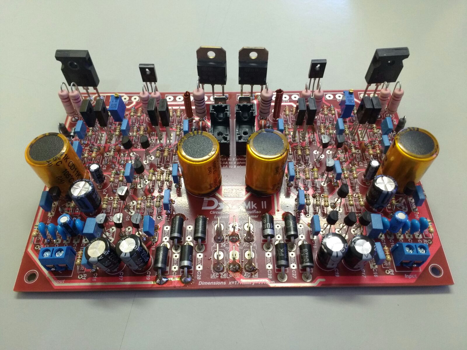

When setting bias current using 10ohm safety resistors - does the recommended circa 850mV to 1100mV reading correspond to the 33v power rail value only? If a +/-20v supply is used will the correct bias current be less and hence lower voltage on 10R resistors?
Don't set the output bias using a big resistor in the supply lead.
The bias CURRENT changes when the supply voltage changes, even when the bias voltage almost appears to stay the same.
Removing the test resistor effectively increases the supply voltage at the amplifier and the bias current increases.
You must measure the bias voltage across the output emitter resistors.
If your amplifier does not have any emitter resistors, then fit one to each output device.
I have 0.33R and 5w resistors. Is that sufficient? Also there are no holes or traces in the PCB for the resistors. What's the easiest way to install emitter resistors with point to point? Also, what is the bias current I want then 100mA?
I had to test out my theory that the bias current as measured across 10R external resistors changes with supply voltage. All I had was a 53v dual rail. So I hooked it up and the bias current easily went up and I was able to get more and set it for 1000mV. Then tested the amp with music and it sounded fine an ran for 5 minutes until "pop" blew the fuses on my Abletec SMPS. Checking what caused the supply to blow it's fuses revealed the main 5200 NPN transistor shows 0 ohms across two of the pins. Caps are all still good. I wonder if this is the only part that got fried?
What is the max voltage for the Dx anyway? Will need to order some spare Toshibas power transistors.
Based on instructions on Greg's website for setting bias. Adjust to get between 850mV and 1100mV across 10R. That's about 100mA right? Seems high as I was only getting 10mA with the 20v supply and it actually worked and sound good. But I have no idea what bias current across transitors is as this was the external "safety" resistor as advised by the official Dx amp setup instructions.
I don't know. Use R.Cordell's calculator for thermal stability.I have 0.33R and 5w resistors. Is that sufficient? ..............
And did you try to check the actual bias voltage across the emitter resistors (Vre) AFTER you removed the 10r test resistor from the supply rail?Based on instructions on Greg's website for setting bias. Adjust to get between 850mV and 1100mV across 10R. That's about 100mA right? Seems high as I was only getting 10mA with the 20v supply and it actually worked and sound good. But I have no idea what bias current across transitors is as this was the external "safety" resistor as advised by the official Dx amp setup instructions.
What si the Vre when mains voltage is at absolute max? Does it stabilise or does the current keep on rising?

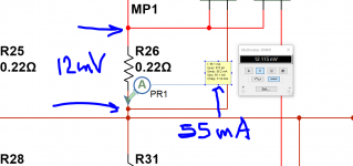

I'm not an expert but I will adjusted to about 12mV to 15mV resulting in about 55mA and maybe a bit more across those emitter resistors maybe this might not be your case it depends 🙂

The optimal Vre for a ClassAB EF output stage is discussed at length by D.Self.
For a 0r22 emitter resistor D.Self suggests 23.1mVre (= 46.2mVq)
