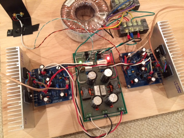

I finally got all my parts to build a Dx power supply unit with a 250VA 25v toroidal transformer. The Dx PSU went together pretty nicely with four Nichicon 4700uF caps, and I since I did not have any 1mm magnet wire to make the choke, I used some extra Coilcraft flat wire 10uH inductors from my class D amps. The PSU puts out +/-37 volts and ripple was measured at 6mV with no load - pretty good I think.
Applying 37 volt rails finally allowed me to see voltage across the 0.33ohm emitter resistors. I set it for 100mA quiescent current and adjusted offset to about 1mV and it is stable.
Playing music on it now - real nice. I think I did not have enough bias before so it sounds real clean now.
Schematic of PSU:
So it seems all my problems were from result of not using a high enough voltage power supply.
Thank you Carlos for a great sounding amp and clean power supply. 🙂
I just realized that I am probably running a high bias current of 100mA. Besides added heat output, is there any issue sound quality wise from running at 100mA vs the circa recommended 10mA? Would there be less distortion with a higher bias current?
I have been listening to it for a day now at 100mA and think that this amp sounds great - excellent clarity, super bass dynamics.
With a classAB amp the increased bias current means less load-induced noise on the power supply, hence better dynamics normally. If you have any more of the Coilcraft inductors, add another stage of LC - this will likely improve SQ.
You mean another set of 4700uF separated by same RL? I do indeed have more (samples that I will probably not use for class D as they are so big).
So it's not bad to operate at higher bias is you can afford the heat?

Higher bias is normally better if you can afford the heat yeah. If you have those inductors sitting idle then definitely press them into service with another LC stage on the output.
