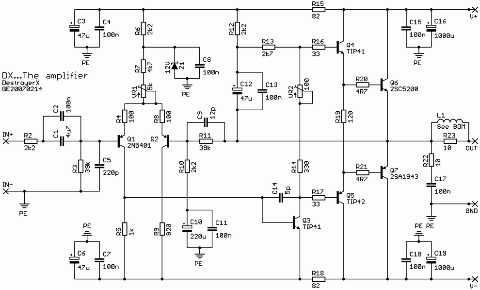

DX AMP is a very kind amplifier that can work even with junk parts...you will need to respect only the voltage limits, current limits, some small gain may be needed..hummm, more than 50 will work fine.... the speed is not "that" problem, as Dx amplifier, a very kind amplifier, will reproduce music inside the audible range, not producing harmonics to disturb your cats , or to confuse Bats flying around.
Using 35 volts, almost all audio transistors will fit...some current will be needed at the output.... 5 amps transistors will work fine...under 8 ohms, even 2N3055 and 2N2955 will work there...also TIP3055 and TIP2955 and other Tips transistors too.
Dx amplifier can work with 2N transistors, 2SC transistors and 2SB transistors.
Also it has suggested transistors, beeing the more adequated ones those ones you have in your junk box...a very flexible design that do not need you to follow instructions in details.
Also, can reproduce good audio without Platine silvered Brica, tube tuned low loss high stable precision golden stripped capacitors.
For your board, golden plated lines will not be needed and it is the only one that can work without holes to screws in its board...it sound good, even not beeing pretty and expensive.

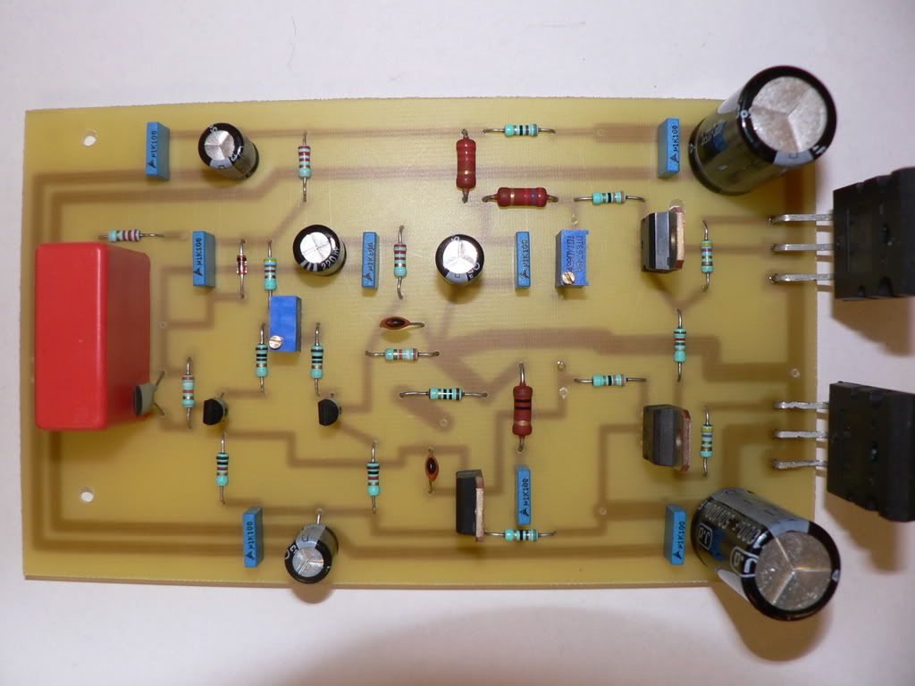

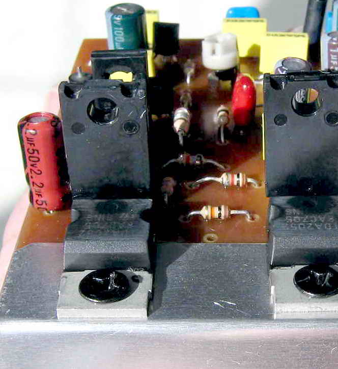

Second channel mostly assembled , op-devices fitted are mjl 21193/21194, VAS is bd243c
(hope it's 'in focus' now ):
The BIG picture is here:
http://i29.photobucket.com/albums/c272/aqvrs1853/P1040664.jpg
best regards,
Klaas

Great Klaas...many thanks by your attention and kindness to produce a better picture
for my historical purposes....hehe....not so real purposes...i use to be kidding, this way life goes better with good mood.

Many thanks by the very good picture you have made Klaas.
Now you have respected the excelence of Panasonic Lumix products.

The amplifier is not a professional product, it was not made for sale..i have no boards to sell or to give to friends.
regards,
Carlos
But i will tell Greg...in the future, all suggestions will be introduced into a last model board.
They will be small differences...input condenser size for instance...rail filter condenser position...maybe the option for a bias multiplier for the ones prefer this way.
But this will be made in some monthes Roender....your need will be there, in the last board model.
thank you by your help and attention... i am happy that Rumania is here too, represent by you Hoender
I am attaching one "feature" image.... a propaganda, advertising image.
regards,
Carlos
The last model board may change to a square board...more used in our forum
Dimensions will be sligtly different, and Greg Erskine, an artist, as profession, will have freedom to do whatever he wants to do.
This will result in a better work related mine...i am a pig to do those things...and he can do much better.... even compared with non pig constructors, i think he can make better.
Here another idea about the output transistors...of course those chips (burned) used here for the model are not adequated for Dx amplifier...a model only. ....parts are there to "populate" the board...not for real electronic work.
"L shape" aluminiun is shown to transfer heat to a vertical heatsink surface.
regards,
Carlos

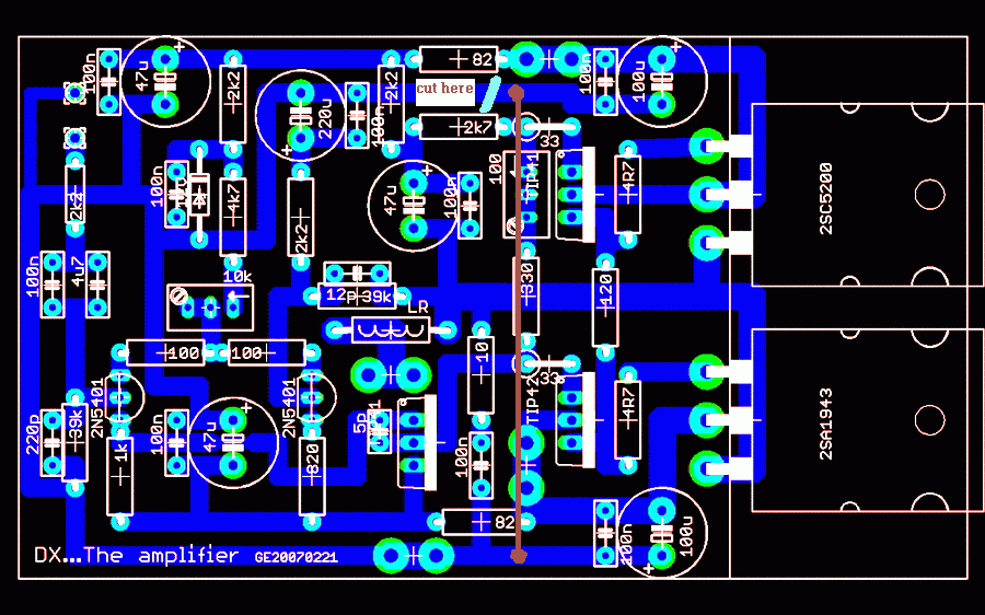

Good point Roender
This is why I used 'STAR' connections with my own amplifier, with a single central ground point at near the output end of the pcb with the Zobel going straight to it and the input ground plus all capacitor connections radiating from it.
Now that Carlos' amp is proved a runner it would be worth designing a 'Star' pcb for it. These are more difficult to layout but ensure best sound for the design.
Cheers ........ Graham.
No problems Graham..i will try to do your suggested star grounding.
If not possible..because of board room..i will put an star marking my ground because of you...hehe...kidding..will be possible, of course.

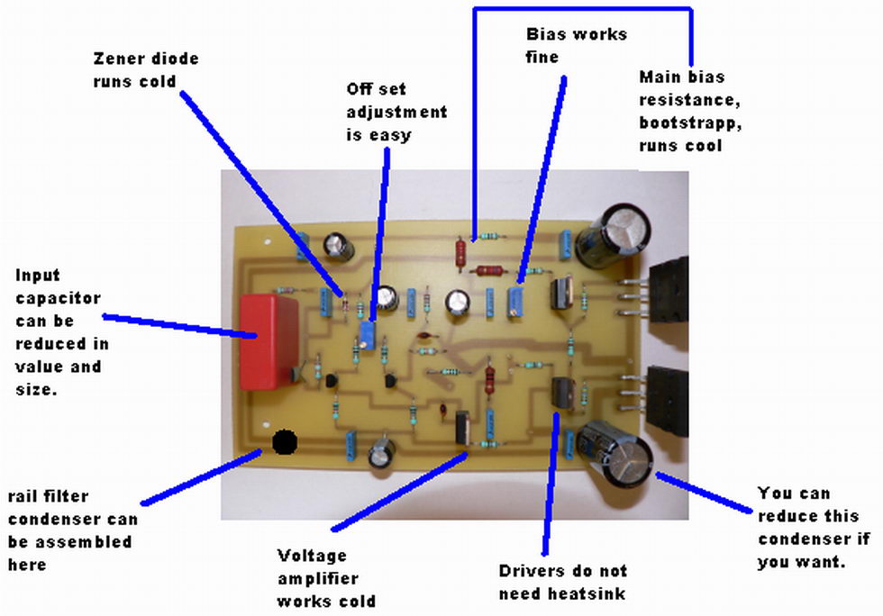

I was remembering , Mr. Roender.... the idea, in the beginning of the tread...also in the former thread that produced this one (Simple amplifier) was to remove everything that was not "sounding"...things, when removed, made not difference to sonics perceive using audition tests (young kids helping..they have no preferences and they do not lye....also do not try to discover what you want them to tell you)
And this way; emitter resistance gone....VBe multiplier gone...output coil gone (but this is dangerous, depending the speaker may be needed)...also the input rail condensers were not "sounding" enougth to be keept there...near the output colectors...i found that even a 100N were working fine there.
This made me suggest Greg to exclude, or to let as "optional" those rail condensers...people can use them running wires or not use them.
In the future, some modifications will be done to make friends happy, in special suggestion that came from constructors or "quasi" constructors.
That preference will be posted here, because we have the "suggesters audiophiles"..those suggest...suggest...suggest and do not construct nothing.
Also, there are the re-designers..they redesign everything they see..also do not construct nothing.
There are the "simulators"..those simulate everything and construct anything.
And there are the "around the clock consultants"...going every thread to tell what is rigth and what is wrong..never watching for themselves to observe if there's something rigth or wrong with that behavior.
And there are the "analisers"....alike me...the ones that analises...analises.... and normally do not construct things that they analise.

Hi Carlos,
I wonder if you tried listening with and without the 82 ohm rail resistors R15 and R18 on the last drawing above ?
If they do not make any difference that could be 2 resistors and 4 capacitors away !
