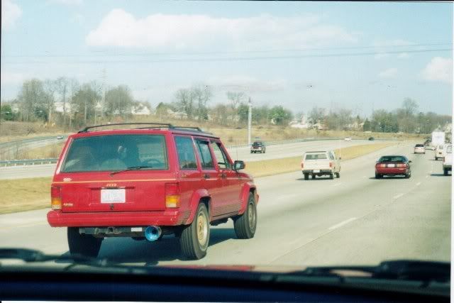

What a puny tail pipe on the back of that car !
And if that amp is bridged to 4 ohms, or a dual 2ohm drivers are used maybe that will combat the wind loss. LOL.

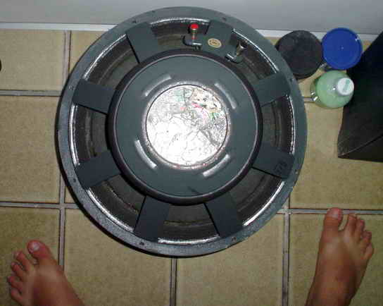

Watch the woofer size compared with 6 feet tall man feet
And they use 7 of those ones and many midranges and tweeters.

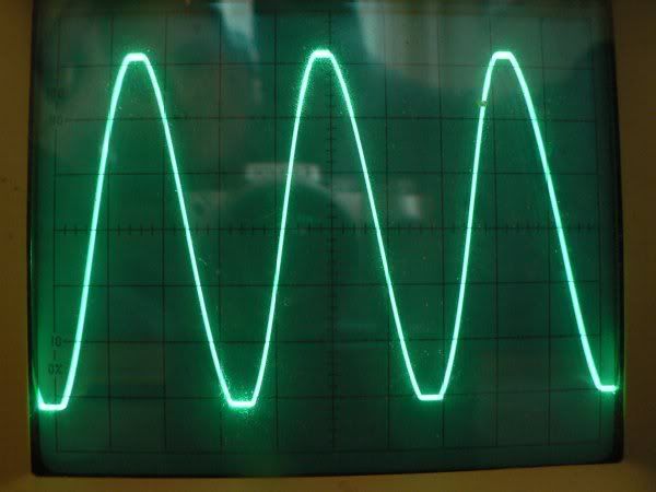

Carlos, i don't think my scope is moody.
It's just me starting to learn about the nature of how amplifiers work.

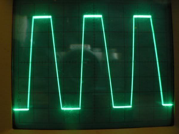

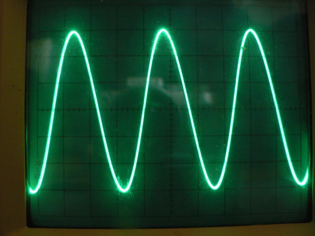

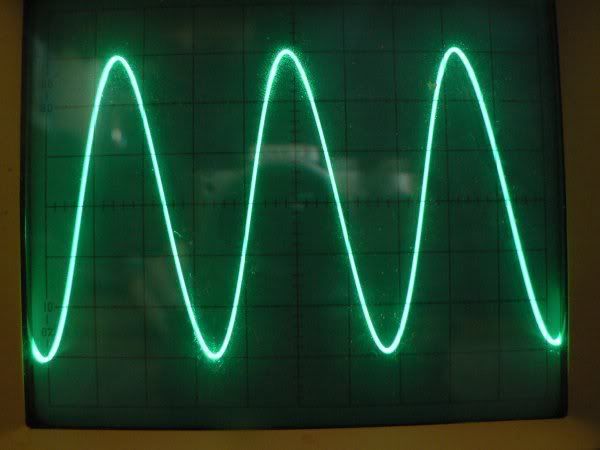

Finally good progress 🙂
Changed VAS-transistor to bd-139, then tweaked feedback-cap to 12 pF , cap across base-collector of VAS to 22 pf.
No other compensation installed, powersupply-caps are 12200 uF +1000 uF local caps:
All scope-images are 10v/div into 6.75r load.
600 Hz at onset of clipping:
600 Hz clipping:
600 Hz heavy clipping:
15 kHz at onset of clipping:
15 kHz heavy clipping:
The apparent assymmetry is caused by the camera, some glare from reflections (lines are clean in real).

That is good news Klaas, Carlos can put his shotgun away now,
his amplifier is reprieved.
If you turn the beam currect down (brightness) on your scope (the camera will compensate) you should have less scintillation and internal reflection at the top and bottom of the screen.
You would think that a slower and lower gain transistor at the VAS would be less likely to cause problems, whilst actually the increased internal capacitance and its variation can initiate oscillation.
This is why I prefer the Toshiba 2SC3421/2SA1358, and 2SC4793 and 2SA1837, even more than BD139/140.
Do let us all know if your efforts were worthwhile.
Cheers .......... Graham.

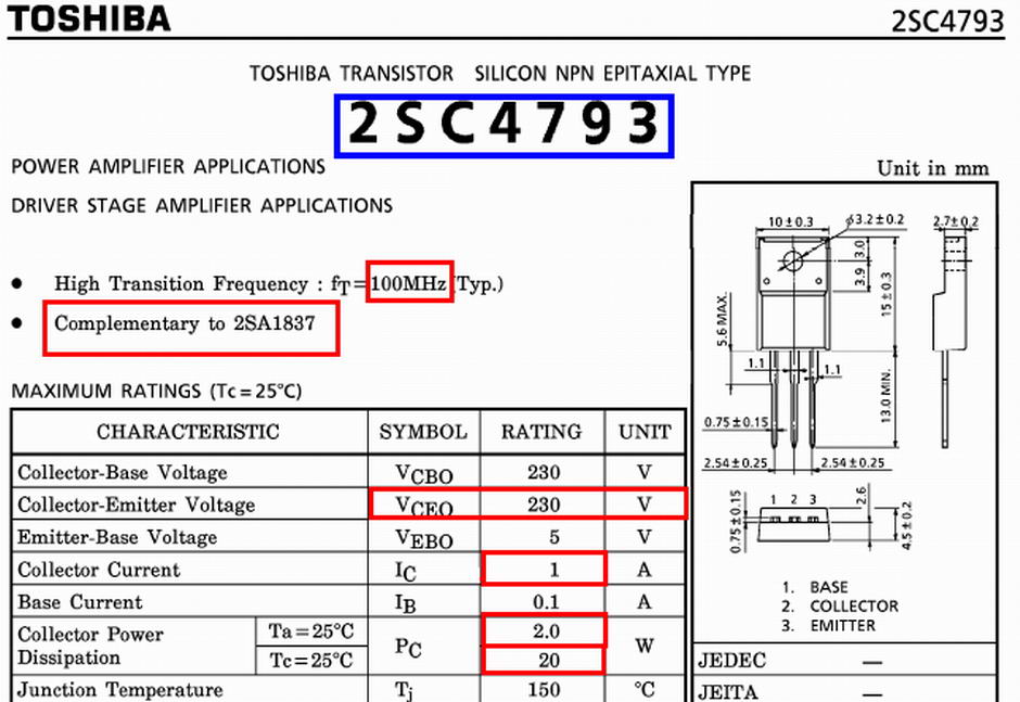

2SC4793 is perfect as driver and VAS
And it is made with some kind of plastic, we do not need to use insulators...pretty good they are.

Discussion about BD139/140
http://www.diyaudio.com/forums/showthread.php?s=&threadid=97030&highlight=
They are my prefered pair for drivers and to use as VAS
The one that had first selected those units was Hugh Dean from Aspen Amplifiers.... the most respectable researcher i had ever know, because he use ears, not only scope, distortion analisers, spectrum analisers, signal generators and so on.
This transistor price is not high, and despite plastic case, it is able to dissipate 20 watts, and 2 watts without heatsink.
Capacitance in colector is not too big, around 20 picofarads,
The gain is reasonable...from 70 to 90 normally.
This transistor, despite has the possibility to work till 100 megahertz, it is not eagger to oscilate.
I was avoiding to mention, to keep the characteristic of simple, cheap and xtraordinary...using TIP41 as Vas and drivers....but, of course, better transistors can be used.
I could not use better than those...much better than old traditional units as 2SC2238 and 2SA968.
The advantage of those old fellows is that they have sligtly higher gain..but they loose in all other characteristics, including that you will need insulator, as it is traditional...a very standard old fashioned TO-220.

Thank you Tinitus..it seems to me that people is resistant to those ones
BD139 and BD140 works fine into amplifiers using 35 volts supplies...but, people had measured capacitance of 100 picofarads...well...this is not good....maybe because fake ones., or not original ones.
MJE350 and MJE340 are most acceptable cousins.... a lot of people in this forum like them....but they are not so different related BD139 and BD140.

Installed the Philips bd-139 as VAS yesterday.
Haven't got much time to evaluate, but it seems to sound slower as bd243c.
I don't do fast ab-tests like Carlos, so please take my comments about sound with a grain of salt.

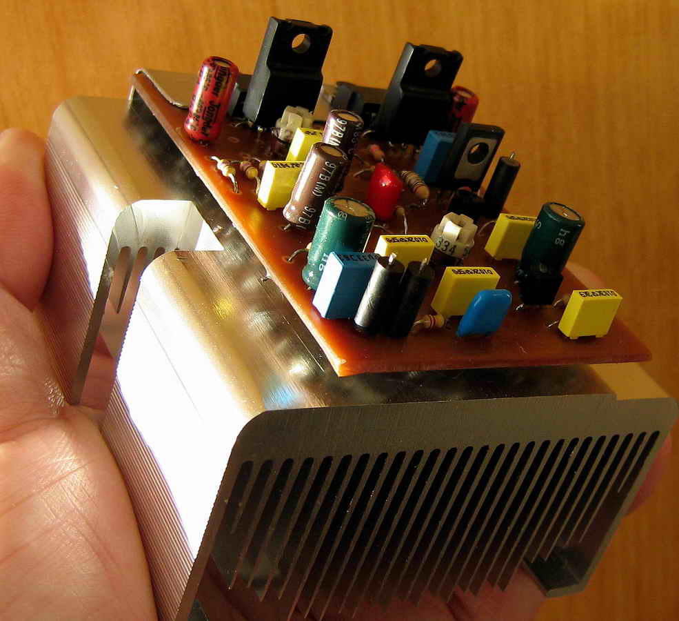

You made me feel at home with your pictures.
Those images are very common here...those plants, ligth and colour...nice place you leave....very nice.
And your camera is very good...Leica lenses....the brand is also very good...Lumix, from Panasonic.
But....you was a very bad man with me, the Dx amplifier board.... had not good focus.
You could be more gentle producing, a single picture, framing the board only...to inspect your board a little bit better.
You may understand...you are the first to construct my amplifier....so, your image is important for the Destroyer X Corporation historical files...hehe.
It is possible that this amplifier turns into a Kit someday...but has a chance to be included in some amplifier to crazy car boomer folks, as i can produce 300 watts units with switching supplies...those powerholic will turn crazy watching their woofers melt.... incredible how they love destruction, they feel proud of those things...crazy folks.
Well...lovely images...give me the link to watch more pictures from you.
Sorry to answer...do you have a face?....ahahaha...people from North Europe do not like to show their faces.... i do not understand why..people are handsome there.
Live is interesting...people is much more interesting....ahahaha...and crazy too!
regards,
Carlos
regards,
Carlos
