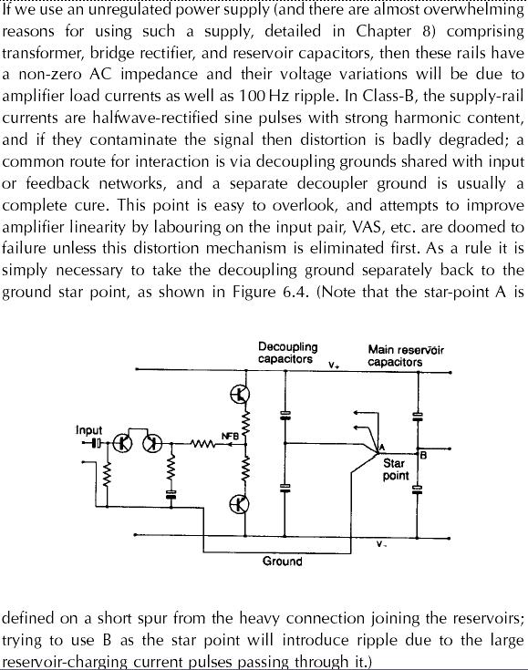

Hi Roender.
My star ground point would be (is) on board between the decoupling cappacitors (left of A on that drawing), with all other capacitors and zero volt rails returning individually to that same point; these being Zobel, NFB divider, main supply 0V reservoir halves, any other rail smoothers, input ground and output ground, each separately and on a per channel amplifier (monoblock) basis.
Cheers ......... Graham.
roender said:I don't want to teach anything to anyone. I'll promise that this is my very last post in your thread ...
This is just crude facts: the correct way in implementing "star ground"

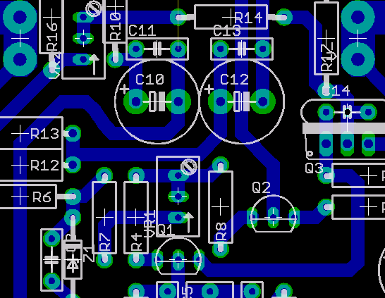

Greg , i had a look at your pcb, i like it
Much better than the one i had cooking in Eagle .
Regarding your two red traces:
I think with a bit of shifting of components, you can run the left one at the bottom of the pcb , where it is now.
I made a quick drawing for loosing the one on the right:
Reroute the connection from q1 to q3 as shown in black.
It would need a bit of shifting of components, but i think it could fit.
Graham , i agree with you on the optimal layout of the starground.
I just find it darn hard to implement on a pcb, maybe i'm just not smart enough
![greg_erskine_changed.jpg](https://i29.photobucket.com/albums/c272/aqvrs1853/greg_erskine_changed.jpg)

Hi kvholio,
Thanks for the suggestions. I have a little play around and see what happens.

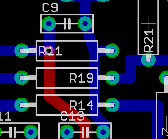

Graham Maynard said:Re PCB
One R labelled R21 should be R11. The middle one ?
I cannot see the Zobel.
Cheers ........ Graham.
Hi Graham,
Thanks for having a look. There is a "temporary" via right behind the first "1" in "R11" which makes it look like a "2". I'm using back and forward annotation between the schematic and PCB so these kind of naming errors can't (shouldn't) occur.
The intention is to have the zobel and output inductor offboard.
regards
Greg

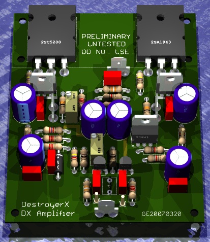

Lovely boards Greg..go ahead in your research.
I thank you very much for your cooperation.... every cooperation will be welcome.
Special thanks to Greg, that cooperate with me since the early beginning of this thread...you are free to decide things related the board Greg...but please, include some option in the board to help people to customize for their own needs....maybe a green and orange wires to travel under the board for the folks that wants the VBE multiplier.
If Klaas wants to make his version and to publish here, will receive my thanks...this way people will have more options.
Of course i am open to receive suggestions, and Roender suggestion was accepted...so Roender, no reasons to abandon us.
But the design was already made..some small changes were made...as optional diode biasing.... VBE multiplier using external board and some parts were removed.
But this is the end of modifications..for now on...to avoid too much confusion.
The working schematic was posted and soon we will have Greg finished board...maybe Klaas finished board too....i hope those friends can construct and test their boards to avoid future surprises.
Zobel was something Greg forgot and will be placed in place once again...also the optional holes to output coil will be there to keep people free to use it or not to used it.
The amplifier use low speed transistors as voltage and drivers, and this was done to be simple, and to be cheap..also to avoid surprises with oscilations in the HF bands...as those hi speed transistors are dangerous...their advantage is something that may not have too much advantages compared to the risks they provide.
The thread, in my point of view, gave the results i wanted... i could show the amplifiers, modifications were done, some contributions were accepted, a lot of hits shows that we had many visitors, Klaas had constructed and said sounds good...final board is arriving and my mission was finishing...
Everything that will happen here, in the future, will be much more than i hope for...maybe more people will construct, as pioneer Klaas have took the risks for himself...thanks Klaas....many folks may follow you in the future.

kvholio said:Regarding your two red traces:
Hi Klaas,
I took your advice and it worked out OK.
