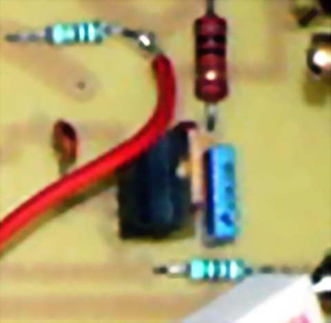

Related to those drivers, i noticed a silly mestake: i mentioned bc243c/bc244c, it should be bd243c/bd244c. silly mestake

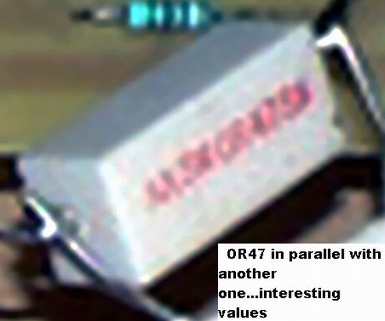

Rail-resistors are 0.47 r// 0.68 r.
They are just for measuring current, fuses are there for protection.
You are right about fuse-resistance Carlos, to make matters worse they are dynamic resistances, resistance is varying with current-draw of the circuit.
At 30w rms they lit up like a christmas-tree .
Mounting the diodes on the aluminium bar was just convenient, given big thermal inertia of the bar and its coupling with op-devices and heatsink i figured it would be okay.
I made this heatsink for universal use, i can mount different types of op-devices without drilling/tapping new holes.
It also provides superior thermal coupling compared to using screws.
I used stainless-steel threads/nuts, cause in my experience threading in aluminium eventually wears out.

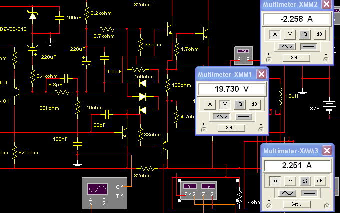

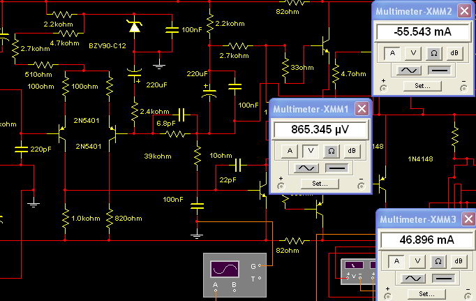

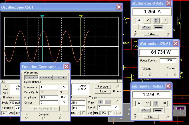

Replacing those fuses and removing the rail protective resistances
Your clean power will jump to more than 40 watts RMS clean...well, that's what i had here....maybe your fuses and protective resistors (if already there) are reducing the usefull power.
I could have more...near 50...or 48 to be precise, but i have perceived that distortion was already appearing....something that may be around 0.5
Interesting is that my series resistor....related those diodes, was a 33 ohms....when the simulator show 120 to 150 ohms and your circuit used 25 ohms....maybe the diodes used...in the simulator was 1N4148...in my circuits i have used 1N4007.
The voltage amplifier Klass...if you know the gain, please, inform it to me...also the transistor number.
regards,
Carlos
regards,
Carlos

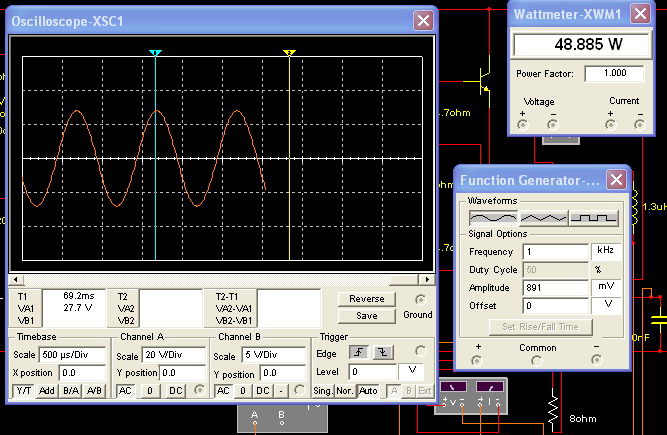

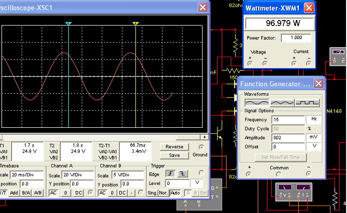

15 hertz losses....observe that the input capacitor was modified to 1 uF
Because Klass had to use an enormous capacitor (in size)...and really not needed so big that way...sorry Klass
I have simulated with 1uf at the input.
This was obtained (simulated) over 4 ohms
regards,
Carlos

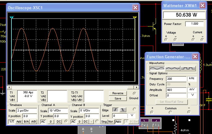

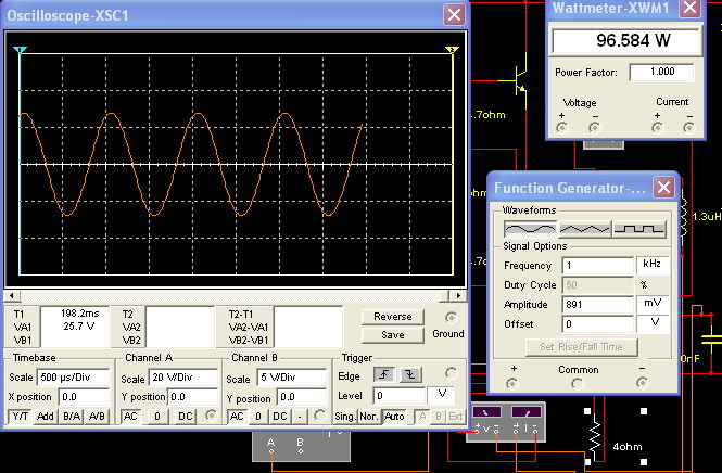

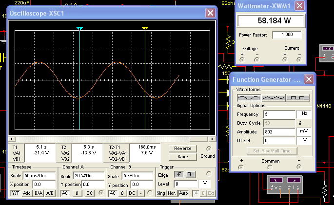

Here you can see the power losses over 4 ohms
Because i have reduced the input capacitor...so...now you have losses there.
But you can see that it is very good even this way.
Power obtained by Mr. Klass was reduced because he had fuse problems and i suppose the voltage amplifier gain not so good.
We will see in near future if Klass amplifier power will change.
Those simulator results makes sense related the real life audition and real life measurements made....but triangle wave started before in frequency..simulator is too much nice in this aspect.
regards,
Carlos
