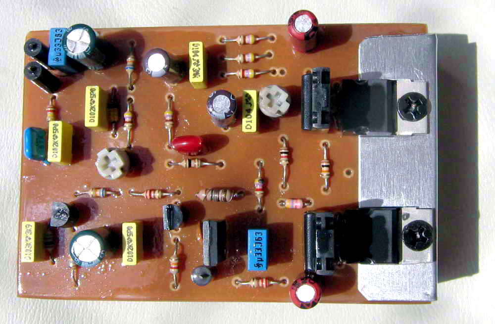

Hi PhongVuTuan!
This is my output stage! I'm using a Symmetrical amp.
If this scheme can make a difference, please tell me that thing.
Tips: using PNG or GIF for better quality and file size. Because I only have aaa.jpeg so using PNG will only have quality but I still use PNG. Capture schematic and save as .PNG at the first time, you will feel the difference

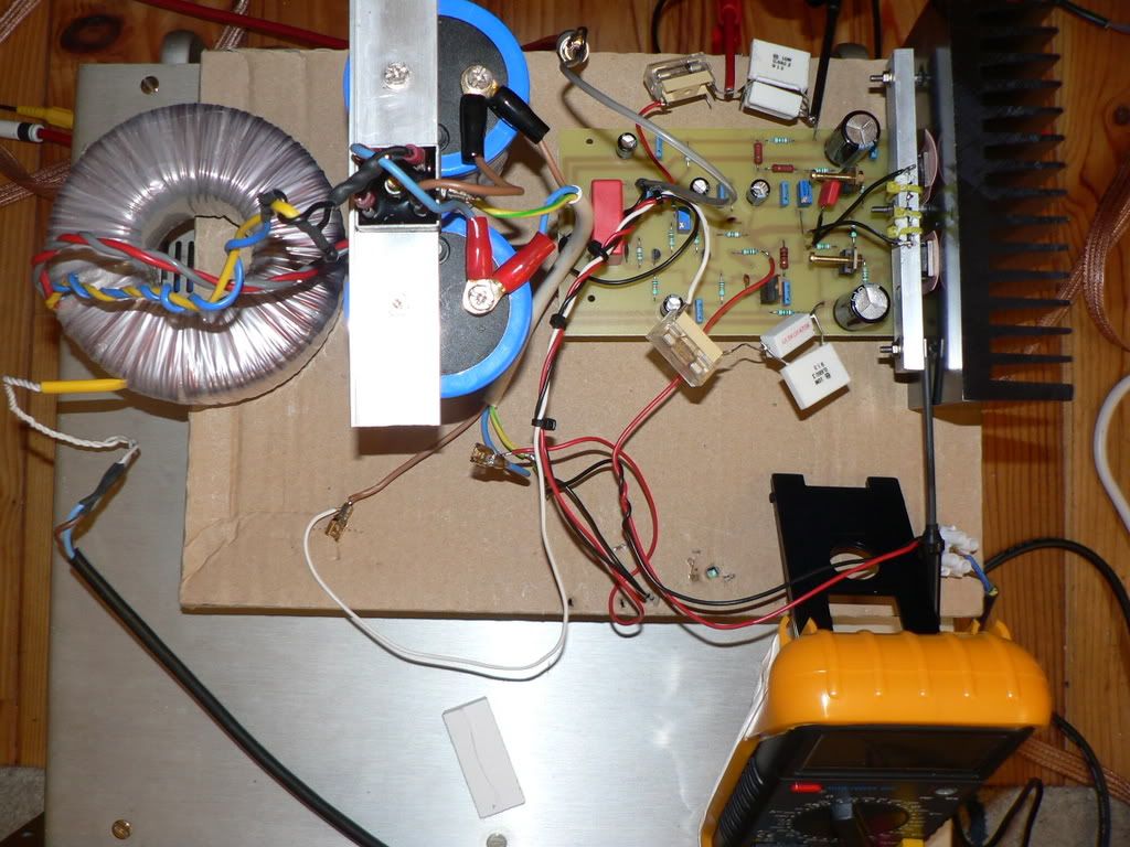

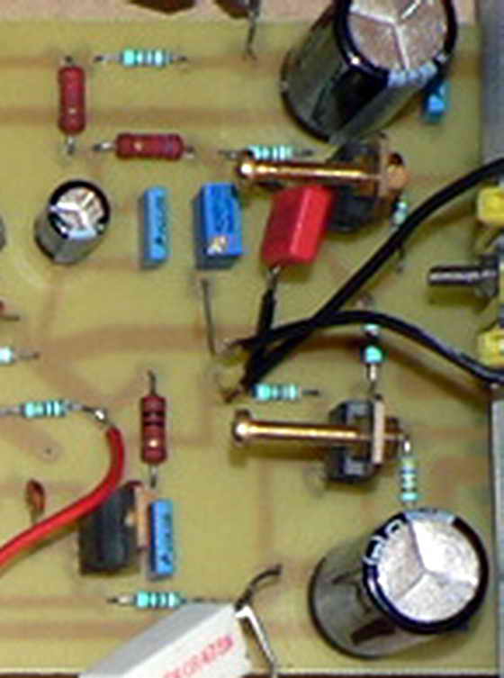

Yup, tried and tested into dummy-load at 30w rms sine-wave:
Using bc243c/bc244c as drivers, 2sc3855/2sa1491 for op-devices.
Used 3 diodes in series (with .22 uF in parallel) for bias-circuit instead of resistor after frying my first pair of outputs
(maybe because of careless biasing)

Thanks for the inspiration Carlos 🙂

3 diodes and 100 ohms in series will bias to around 60 miliamps each rail...using 37 plus and 37 minus.
Using 30 volts... 135 ohms will produce almost the same 60 miliamps.

powersupply-voltage is +/- 35 volts, 300va toroid, 2x47000 uF 😀
quiescent-current ~ 50mA, 100r potmeter measures 25 ohms adjusted.
One channel running, need some parts to complete 2nd channel.
Sounds good, good separation between different instruments.
Claps sound as claps, raindrops sound as raindrops 😎

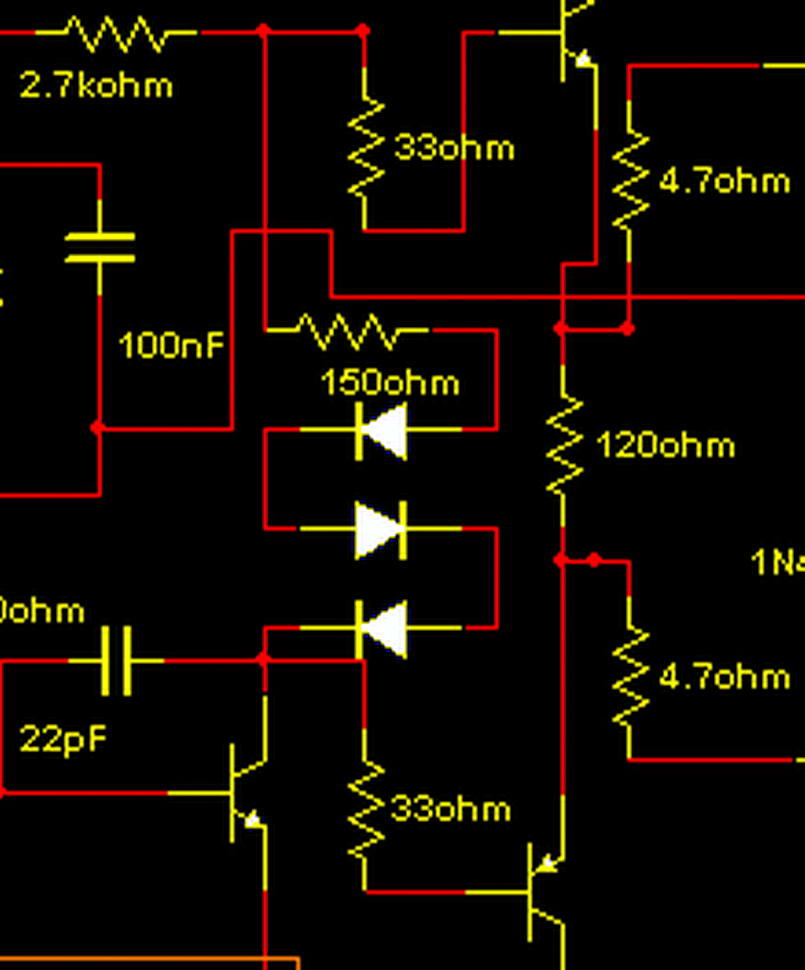

Hi Thanh in HCM city
It's really nice to see you here. We are in the same country and the same occupation. I'm an IT too. I have a hobby of making amp for fun.
Now you live in Viet nam and in Viet nam I think you can never buy a genuine transistor in HCM city or Hanoi. They are all fake ones with low safe operating area (SOA) and low gain and the bad thing is they are not linear in gain. That is too bad. To make an example if you make a VAS stage with normal darlington design, it will distort like mad and your amp will add a lot of noise to your audio signal. I compared them to ones I have from digikey and found this. 2sa1930 is well reputed for linearity and gain is not OK at all. and 2sc5200 madly distort your amp at as low quiescent current as 50ma. And they will turn your amp into rubbish before you know it. But I can use them to source a light bulb without a problem. (recently I bought a bunch of trans from Digikey: C5200, A1837, bc546, MPSa42/92, 2n5087. And to my surprise they wake up sound quality in my amp)
I found this circuit as a way to go round this problem. The driver trans (TIP41,42) which is fake with poor linearity, I bias them at 70 ma and this will improve. The power transistors (2sc5200-a1943) quiescent current will be at least 100ma. You will have a good heat sink and avoid thermal run away or your amp will blow.
The Emiter resistors in the circuit is used to achieve better linearity.🙂
