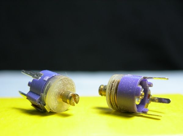

I bought these 2 trim-caps long ago.
Can't even remember what I intended to use this for 😀
If I am not mistaken, they are like 10-50 pF ( violet colouring )
Mounting is 3 pins.
Pin spacing is 5.08 mm ( 2/10 of inch ).
Looking at my attachment image (
sorry for all the dust )
from this you can figure out they are small.
One thing I have learned:
Do Not use metal screw driver
.. to adjust small value trimmer caps or trimmer inductors.
There are special non-metallic plastic screwdrivers,
we should use.
Or you may find some other thin little plastic piece in your room,
that fits for adjusting.

I was a Radio Amateur from 1965 to 1991 and those ones
Use to produce some drift...you adjust and they go changing value while the mechanic system goes into place.
So....for instance...you adjust to 10 picofarads and they drift to high or lower level...and 11, 12, 13 and they can stop in 15 picofarads.... very unprecise those ones.
the problem is to adjust and them, and then to remove them to measure out of the circuit.
After removal, the previously adjusted capacitance value will already have some drift.... so...your adjusted value,that one made when the trimmer was soldered into your amplifier... that one will be the reference to search for a fixed unit, with this same value, and this one will be installed in the feedback line, as the best possible adjusted value (by ears)....well..it will be wrong because of the capacitance drift, consequence of bad mechanics.
Normally they go from 10 percent to maximum capacity.for instance, 5 to 50....or 10 to 100 pf.
Your can be different..of course they can be constructed using different ranges and rules.

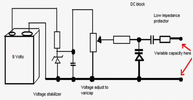

Maybe Graham has, already tested, a small circuit having Varicap diodes.
This will turn things better, as i will have more precision and no mechanical drift.
I can try some...but the problem is that i will have to make it, using try and error....better if Graham has already done circuit for this purpose.
It is boering to calculate all those things....having some circuit dear Graham, i will have to re-calculate only mine own varicap range to voltage and the series with the output series capacitor... as circuit may see those two capacitors, the varicap and the output one, beeing a system with a resistance .
The resistance, to avoid that the amplifier circuit load the whole thing, can be placed in another position to avoid too much calculations.
regards,
Carlos

Hi Carlos,
Yes I think that a useful arrangement.
15pF might be a little too low for you to be able to home in on the optimum value. Maybe something like 50 to 75pF would be better, or the oscillator section of a sub-min AM portable oscillator section with the trimmers removed.
The reason I say this is that once you exceed the optimum value the effect upon reproduction is much smaller than when the value is below optimum. Thus you need to be able to swing way too far, so to speak, in order to be able to home in on what is actually best. This cannot be done when the trimmer has a value similar to capacitance needed.
Also it is not right to physically hold any component connected to the base of the NFB sensing transistor in the differential pair, nor have any wires (varicap) connected to it.

Correct Graham...you are rigth....the wiring will have an uncontrolled capacitance
that will create more problems than solutions.
The old and good padder or some small air gap variable condenser will be used...i will pick some hammarlund in my friend's house.
Thanks...it is good to have you here.

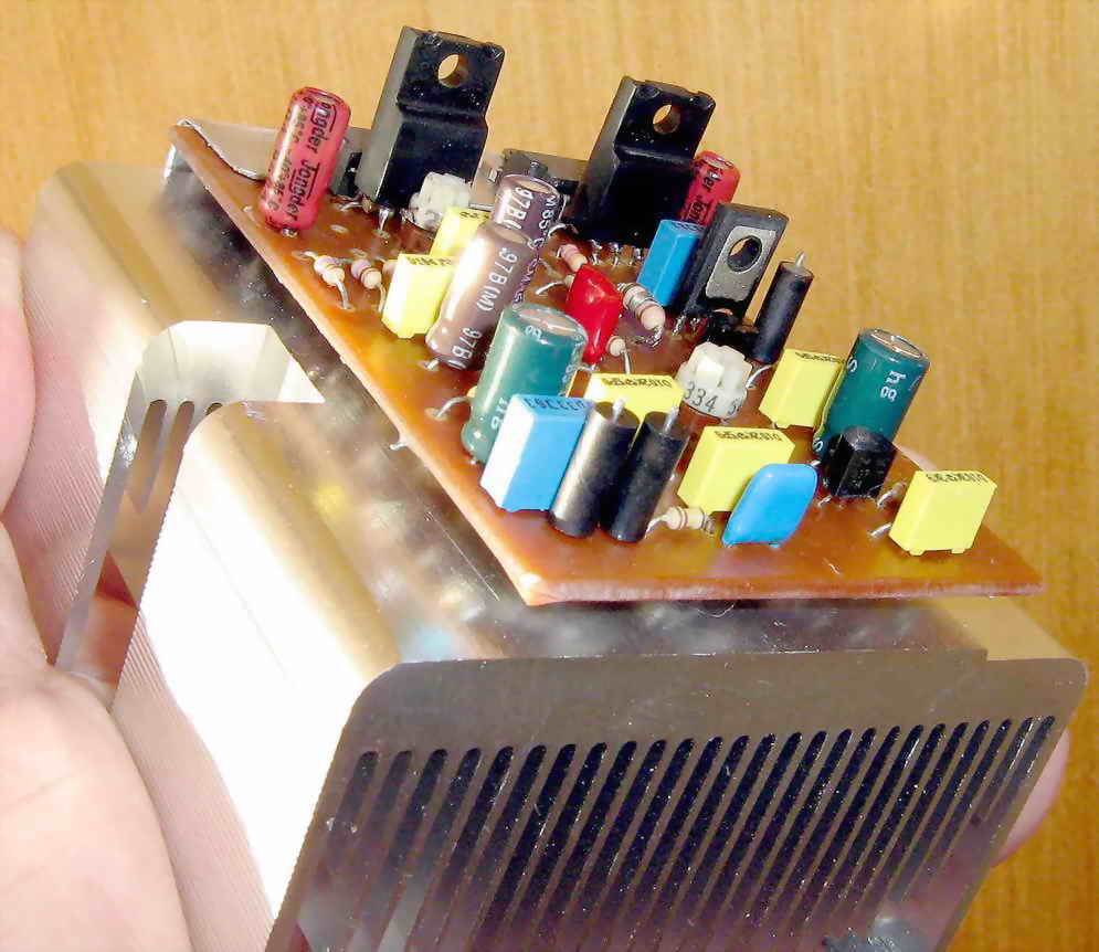

re. Amp sound
I have made am amp with such design with power trans: 2sc5200; 2sa1943; 2sa1930 and its 2Sc. Power rails: +/- 50V The amp just work fine, no smoke, no extreme heat. This amp is designed at 80W but only good at 20 w and the treble is not clear enough. At higher power output, the bass is quite loose which is so bad.
I have some changes in the driver, adjust quiescent current and the result appear to be OK. All the trans in the power stage are bias with 70ma quiescent current. And a compound pair with current limiter is added before the power trans.
I will be happy to see your schematic Phong, including your modifications

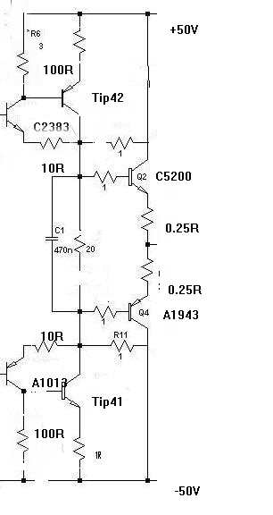

Hi Carlos,
Simulating the last circuit you posted with the grey background, gives 0.12% @ 40W 1kHz into 8 ohms load.
If the two 100 ohm emitter resistors at the differential input pair are shorted out this becomes 0.10% @ 40W 10kHz into 8R.
Both the above with a single output pair.
With parallel connected output pairs having separate 4R7 base resistors the 0.10% figure holds for 80W 10kHz into 4 ohms.
The distortion is predominantly odd harmonic, but falling with order.
The square waves are clean too.
Simulators are not 'real life' but the performance is most definitely useful.

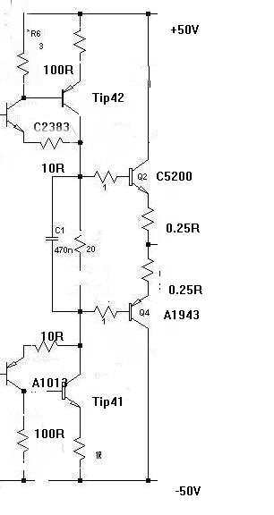

Hi PhongVuTuan,
At 50V rails I feel you would be wiser to double up on output devices for 8 ohms, and quadruple for 4 ohms, with additional 4.7 base resistors as necessary.
My choice for driver transistors would be 2SA1837 and 2SC4793, with the latter being used for the VAS.
I wonder which device you are using for your VAS.
Also when rails increase above about 35-40V there is a need to increase the value of a Miller connected VAS C.dom.
Carlos shows 5pF. Maybe increase it to 22pF @ +/-50V.
Cheers ........ Graham.

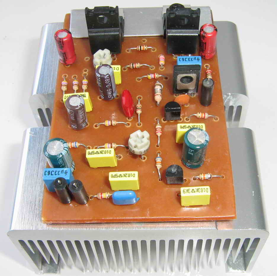

Well... Phong did not return with some more informs.
For sure his amplifier is not the beautifull Dx amplifiers, as his unit is behaving very bad.
Your simulations, Graham, are matching what i am measuring when listening, as i have an AC voltimeter connected at the output all time long...so...i am watching the output all time long.
Also i have tones recorded from 5 hertz to 10 Kilohertz that i use to check....it is clear when the amplifier starts to clip....not needed an Scope to perceive that scandallous awfull sonics of the clipping.
I have made the testing using FM inter stations noise.... 18 pf seems to good Graham...... increasing it the difference is small....but decreasing it from those 18pf you can perceive clearly differences.
Phong told something about a current limiter somewhere...well..if this is in the supply we already know the reason why his amplifier is behaving so bad.....with current limiter the amplifier will be, for sure, limited in power.
Hey Phong...you sent a bomb in my amplifier, as you told about another one...almost the same...behaving very bad.....some folks may believe DX amplifier will be bad too....hummmmm, not real thing.
I hope you find time to show us your amplifier.
I imagine you are very busy, and not that "accidentall bomber" your post suggest.

Dx amplifiers, a great small amplifier.
This is some art work done...not a real circuit...but a real board with some real parts over...values are not the correct ones.
A Model only...thing made to show only.
I am just kidding...Dx is not a corporation...nor a factory...i am just a diy as you are...having passion related my "son"..this amplifier.
Not more than that...simple this way.

re. output stage
Yeah, you know I like your design in a way that it's very simple and require very few components. Most amp circuits sold in our Electronics shop are using your design. At first I made exactly yours, then that didn't bring good result. I think it was the transistor quality is not linear enough. I read an article from some Elliot Electronic page. They tell me some thing not OK about the linearity of Darlington. I switched to this new schema and I think I have solved the linearity problem. My point is creating a class A - Amp to drive the power transistor. The quiescent of the Tip41-Tip42, I put at 75-100ma far exceeding the base current of the power trans. The tip41-42 must have a good heat sink. With this design I don't have to care much about trans quality. Now I'm going to find some bad trans to work with my amp to see the difference.
Prior to this, I have a slight change to take 4 pair of 2sc2383-2sa1013 to make a parallel network to drive C5200-A1943. It worked quite OK.
I made my Amp with a main placing all the power supplies: +/-50V; regulated +/-20V, +/- 55V, +/- 5.6V for Power Stage, gain stages, preamp and input selector. The Power Stage of the amp is also on the main board. I have a Plug-in Drive card, containing high gain stages. I have made several cards using some design other than yours: symasym. (I use only one 2.2MF capacitor in the audio path which is MKP); I have a VI limiter that cut down at 4A wich is a little bit high. And still the sound quality is not improved. From this experience I know that, the poor quality of my amp is caused by Hfe linearity of the output trans.
Furthermore, I have a from input Ground to Power ground to avoid hum.
Now I'm quite happy about the amp with no hum, better damping factor and linearity. Why don't you have a try, and tell me some thing about it. 😎 Have fun
By the way, I forget 2 additional resistors that do nothing in the scheme, here is the scheme
