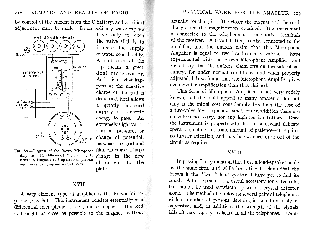

Thinking about the 'Brown Microphone Amplifier' in post #242 above (which is said to have had the gain of two triode stages)
that was the 'solid state' of 85 years ago.
I constructed a microphone using the carbon rod from a battery and a large tin when I was 11. You could hear a fly's footsteps in earphones after it recovered from being swatted and put on the tin. (My first 'electronics'.)
