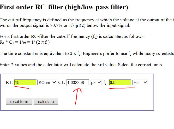

what about the input and output caps?
how do i know their values?
What about them 😀 Values are easily calculated once you define the other parameters such as source impedance, wanted LF response, your wanted input impedance and so on.
is there a formula, a system of equations or a differential equation?
where can i look that up?

Input and output caps are calculated as follows...
Decide your input impedance. This is the "input" resistor for the common opamp configurations. The one from + input to ground for the typical non inverting amp or buffer and the one in series with the - input for the inverting configuration. Decide your wanted LF point.
So lets say 15k input resistance and an LF point of 6.5Hz and lets see what we get.
(the LF point is when the signal is 0.707 of the input voltage... the -3db point)
The formula for all these is 1/(2pi F*C)
Its even easier with an on line calculator 😀 Try this, scroll down to the filters section, pick your units and enter two of the three variables,
calculators for electronic circuit design
