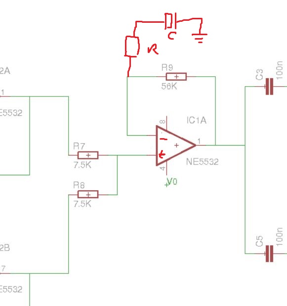

You need to understand how it works before deciding on swapping components.
R1 determines the input impedance. So 22K here. The gain of the stage is (minus) -R2/R1. So it has a gain of -1 (it inverts). The input cap is essential with it being a single rail design. The value of the cap works in conjunction with R1 to determine lower frequency limit. So that is 0.7Hz for these two. If you change the 10uf input cap to 1uf then the -3db point rise to 7Hz. The value of the output cap works in conjunction with the load impedance the circuit is connected to.
If you reverted back to your original scheme (non inverting for input and adder) then the addition of the two signals would not be as accurate because one would modulate the other. The inverting configuration avoids that completely. It really is better. For the sake of four 10uf electroylitics and a few resistors I would stick with the inverting setup to be honest.

The 100k on the output is good practice. It defines ground for the cap and means that the cap does not develop a voltage when left floating... that would cause thumps and bangs when you plugged something into it. The input caps should really have the same too, a high value resistor across directly across the input to relate it to ground at all times.
You can change the gain of the "adder" or mixer" if you wish. It follows the same rule as the input stage for calculation.
you changed the values of the adder.
i thought it would be nice to have a bit of gain in that stage.
why is it wrong?
If you were retaining your original configuration then you would need an extra resistor to add gain to the "adder" stage. The value of R would set the gain. The cap would be around 22 to 47uf.
I still advise the inverting set up though 🙂

The circuit in post #38 is correct and essentially complete. All that is missing is the 100uf cap across the zener and (recommended) the 100k across each input to ground. The 100k connects to the left hand side of the cap in the diagram.
In the diagram in post #38 the Vref is used just as a bias voltage for the opamps. It is not in the signal path. It is purely a reference voltage. This is a true and pure single rail design.
Personally I would be more than happy with good quality electrolytics for the input and output caps. Electrolytics have a bit of an undeserved reputation imo 🙂 Film caps in that size will be large and expensive.
