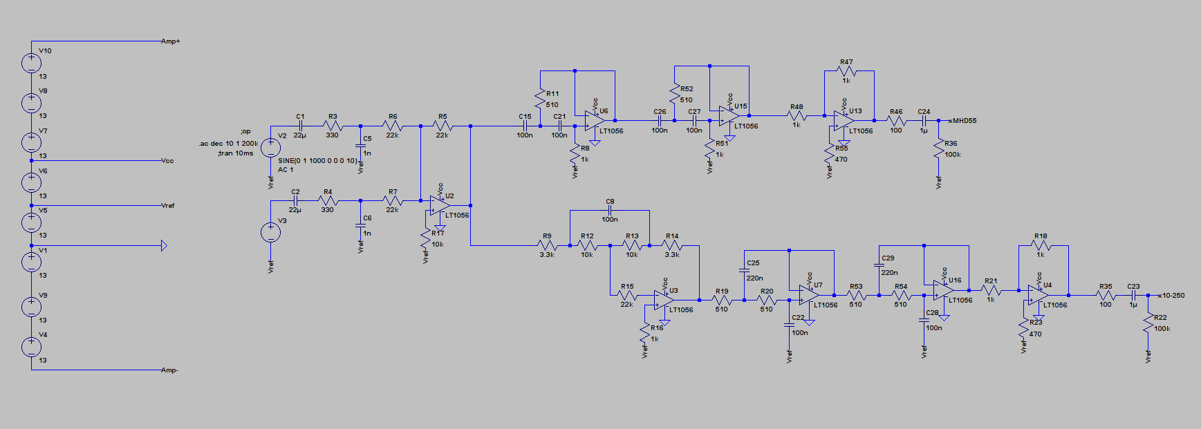

Designing a noob-preamp (single supply)
In the attached case all audio should be on the potential 'Vref'.
Would it work like this?
Should the amps and the preamp be isolated / decoupled from each other?
My thought is that they might influence each other via energy impulses they suck out of the batteries.
Those class d amps seem to be very sensitive about 'clean' DC-supply.
I don't get it completely.
I plan to use them in series with a center tap which would give something around +-50V if fully charged.
Correct :checked:
That center tap will connect to the audio GND of the source.
Yes, that's correct. :checked:
I need the same center tap for the preamp, right? (then with the next possible potentials for +-12V (~13V))

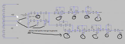

This is where you have to make a choice.
Your preamp as drawn MUST run on its own separate supply because of the way you have it configured. That can be either two 9 volt batteries connected in series such that they apply 18 volts to the circuit as drawn. No centre tap is used. The lower battery negative is preamp ground and this would connect to the power amp ground. Power amp and preamp are treated as totally separate units.
You could also feed the preamp from two series 9 volt batteries but this time use the centre point as ground. You would then need to alter the preamp so that all inputs and outputs were referred to this point.
Carrying on from the above, you then have the option to use the SLA batteries to directly power the preamp.
Like this.
Ok.
As far as i see we expressed pretty much the same with our drawings.
We only used different symbols and of course your diagram requires the opamp supply pins connected to '+12' and '-12'.
Pros and cons of the different methods are quite clear to me now....now i have to decide...
I still have my concerns about the wiring of the batteries, especially with a seperated ps for the preamp.
As it is i have audio GND from the source connected to the '-' of the 32V supply.
This should be connected to the center tap of the +-50V supply.
And via the power amp module that is connected to the negative pole of the speaker.
Does it really work like this?
Yes, it really works like that.
The seperated ps for the preamp is the important bit here. Separate means its not referenced to any other item in the chain and that means it can be connected as you wish.
