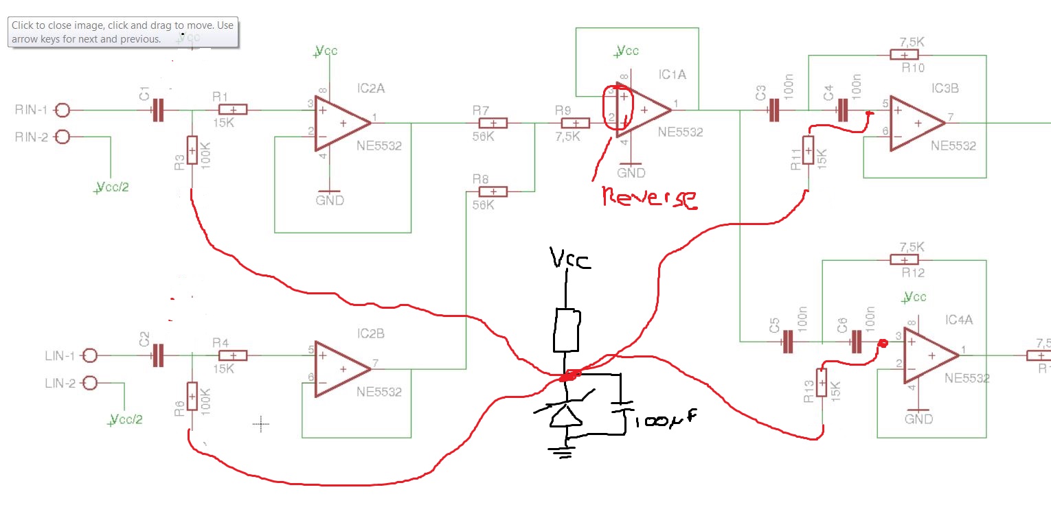

Hi everybody,
i want to design a sla battery driven active mono crossover.
i attached a circuit diagram below, i guess you can see from that what i'm going to do.
i want to use sallen-key topology with butterworth characteristic because of the obvious advantages.
single supply is kind of a problem especially with the low-pass.
maybe i should use mfb-design instead?
what i did:
input buffers
- does it work like that with single supply?
- from what i understand i create a virtual gnd in that stage. i needed that when i only did the low-pass. does it make sense like that?
adder
- i already used exactly that adder, but never with single supply
high-pass
- that high-pass usually works with single supply, but i have no idea if it makes sense together with the input buffer (vcc/2 and so on)
low-pass
other
- is an output-buffer necessary?
here is the diagram.
i tuned the r for 150hz crossover-frequency.
this my first ever attempt with this prog.
the ic are not named correctly and may have done a bunch of other mistake.
but i'm here to learn.

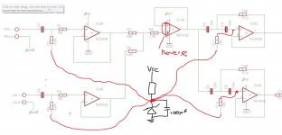

You have a few errors.
1) The input buffers are OK.
2) IC1A has the opamp inputs reversed.
3) R11 and R13 need to go to the opamp + inputs.
Instead of a resistive divider for biasing, why not have one stable reference. It doesn't have to be exactly VCC/2 either. Take your supply voltage and divide it by 2, then pick a zener closest to that value. Use the zener plus a resistor and decoupling cap to create a clean and stable reference. Then use a single resistor to each opamp that needs biasing.

thank you very much.
i was a little hasty to upload this, so i even did the s-k-topology wrong.
and i also messed up the values of a few resistors.
your advice with the zener and not directly using vcc/2 is good news to me.
the perfect fit for the rest of the setup would be using three of the 6v sla batteries.
when the are fully charged, their are something around 6.8v and use them until they reach 5.8v or 5.7v volt.

Yes electrolytics in the power supply are traditional. You can buy 10000 hour service life rated ones at farnell.com or mouser.com, farnell has the hours service life in the selector table. I hate changing e-caps over and over, I've done the ones in my ST70 tube amp 4 times.
I use two 1n5344 8.2 zeners and two resistors (typically 33 ohm) to make a split supply with about even characteristics. The signal ground is the middle of the two zeners. The plus and minus supplies of the op amps are the top and bottom of the two zeners, not the actual supply from the battery/transformer. You don't need three 6v batteries if you can get something like an 18 VDC wall transformer for a battery hedge clipper or race car. I paid $1 for mine at the charity resale shop. I'm using an 18v wall transformer with the two 8.2 v 1n5344's for my disco mixer. I use two capacitors, one across each zener diode. then if my op amps are faster than 5322 I use a ceramic 10 nf cap near each one. Lots of op amp kits like tubelab don't have holes for the electrolytic or ceramic caps.

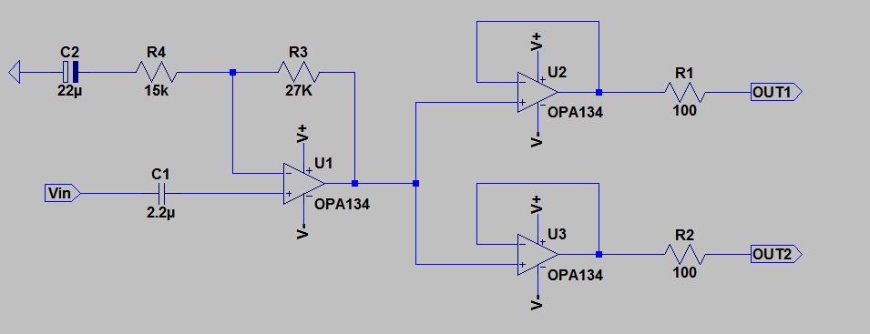

Basic error on the first opamp. No DC bias reference on the non inverting input needs and input resistor to ground the value of which will define Rin)
Input filters are generally regarded as a good thing although actual real world use has to be taken into account. In other words is it in a "noisy" environment and/or is it being fed from a source that could have noise/hash present.
Unity gain buffers are fine as they are... big question is whether or not they do "sound" better running away from unity gain. I don't as yet have a definitive answer to that but its worth a try.

the problem is that the circuit is for a friend of mine and has a lot of unused ne5532 and we think of using 6 of them for a stereo version. i remember most of your advice you gave me in my other threads.

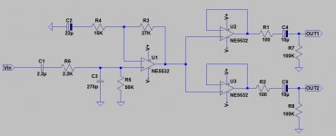

So... A better improve over the last one. is attached below.. what do you say?....other wise we can use a tl074 and a tl072 to make a stereo version...

The resistor is very non critical. 1k, 10k, anything in between. All will work.
Both TL072 and NE5532 are good for audio. The NE5532 has better output capability so would be a better choice for the filter, the FET based TL072 has better imunity to rf and would be good for the input stages. Mixing opamp types is no problem, use them according to their strengths. 20% tolerance on caps for a fliter like this isn't an issue in practice. Its not as if you are making a high Q notch filter or anything like that.
Just one thought, and it depends how far you have gone into constructing all this, would be to make the first two stages inverting and to use a proper "virtual earth" mixer for summing the channels.
