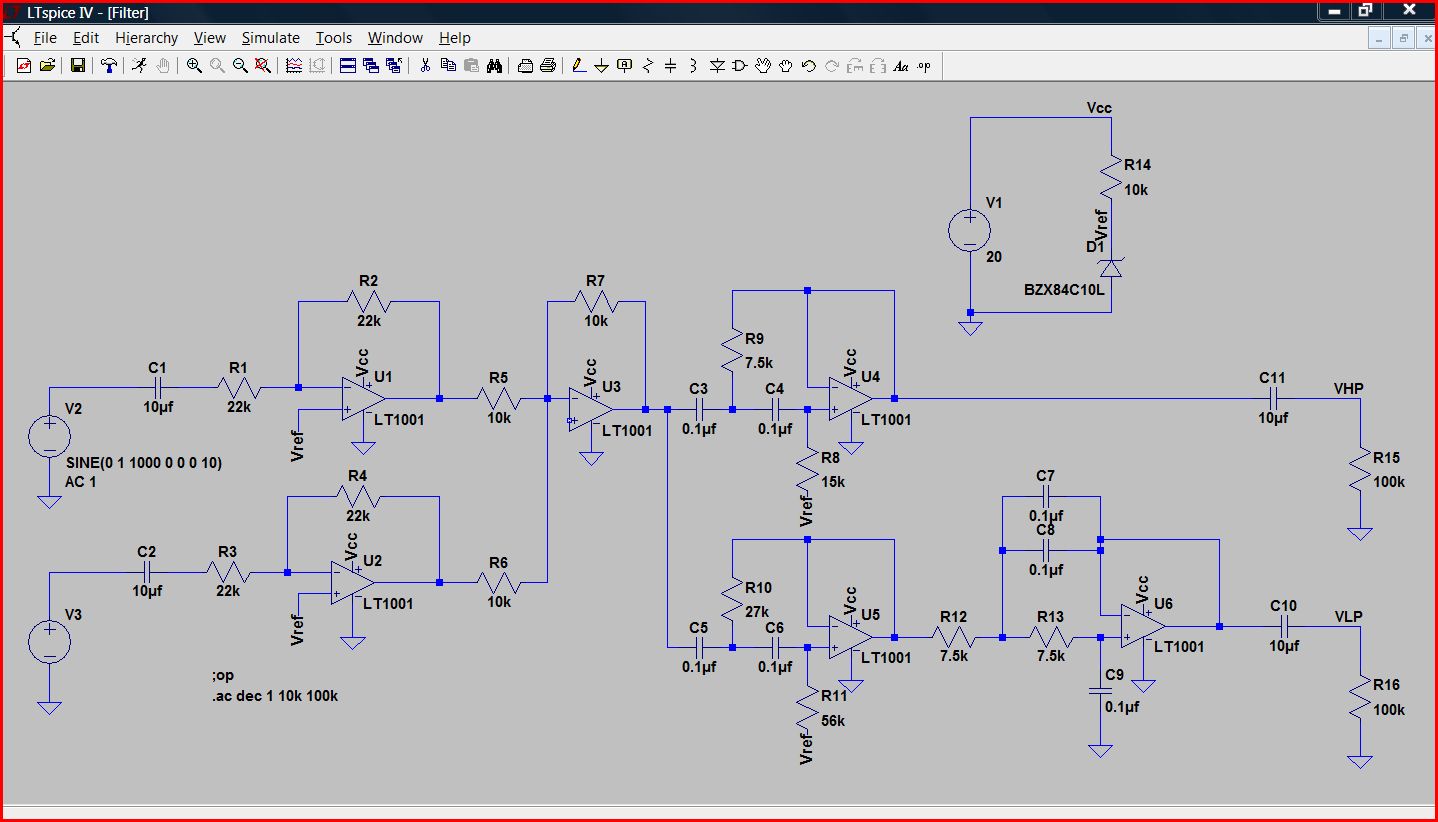

i worked a little bit on the diagram.
it should show what i did last night.

That looks OK. The cap is fine. Take your audio ground from your V0 line.
does that mean that i should leave it like it is?
(english language is difficult to me)
(I might redraw your circuit using inverting configuration.
inverting configuration?
because the adder inverts the signal once and so it has to be done once more in an output stage?
And are you sure a HP filter followed by a LP filter is what you want ?)

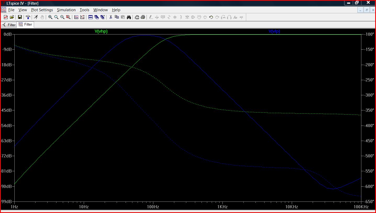

high out:
everything above 150Hz.
low out:
between 40Hz and 150Hz.

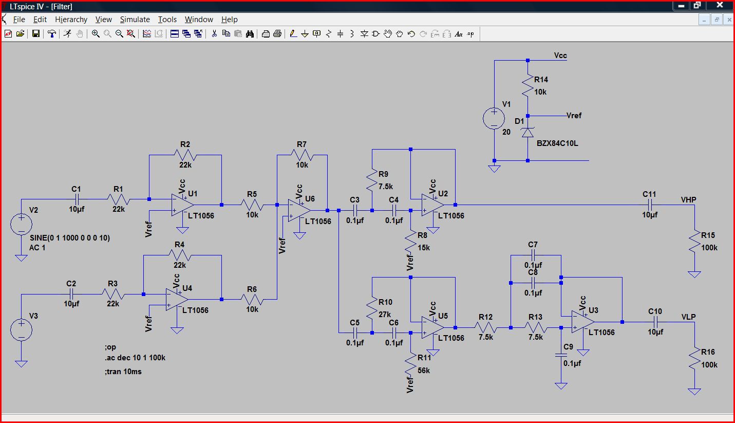

Inverting... your new diagram isn't correct. Look at the opamp inputs of the adder. If we change the adder to "inverting" which is better for performance, then we need to change the input stages to inverting too.

Here is the response and full circuit of your original concept. High pass in green and low pass in blue. Note all the grounds and all the Vref points. Also note that it is now inverting at the input and adder. Note also the opamp - and + inputs.
