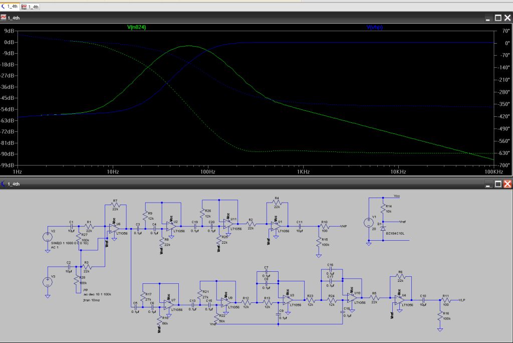

I've no quick answer to your filter problem, you would need to start from the begininning and analyse the response of each section and make sure it conforms to your own spec for what you want.
i´m at the damn university again and the pc doesn´t allow me to install ltspice.
i took a "measurement" from each section.
the very last amplifier in the high-signal way corrected a similar effect at the high-out.
i remember that the crazyness in the low-path started with lpf-stages.
i will post pictures tonight.

the green line is taken after the last lpf section.
the blue line is from the low-out.
something strange happens around u4.

Can you post the .asc of your circuit?
C9 & C10 should be connected to Vref instead of ground, as should all of the resistors signal grounds (R27 & R 28) except before the input DC blocking capacitor and after the output dc blocking capacitor.

Any node that would normally be connected to ground using a bipolar supply should be connected to Vref using a single ended supply.
You can also tie the Vref with the input and output signals ground points providing your circuits V- supply is isolated from the next devices V- that is a common ground.
Else connect the input and output signals as assumed in your schematic if the above condition is not met.
As the DC is blocked by the input and output capacitors and will only pass AC through to the next amplifying stage.
Remember that this is the same thing as a Power Amplifier that has an Output Capacitor and run off of a Single ended supply. 😉
The more opamp's that you use be sure that your Vref source has a low enough impedance to acommadate all of the extra opamp stages for +/- swings on the virtual ground (Vref).

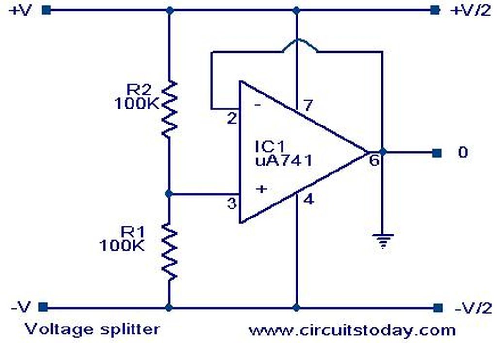

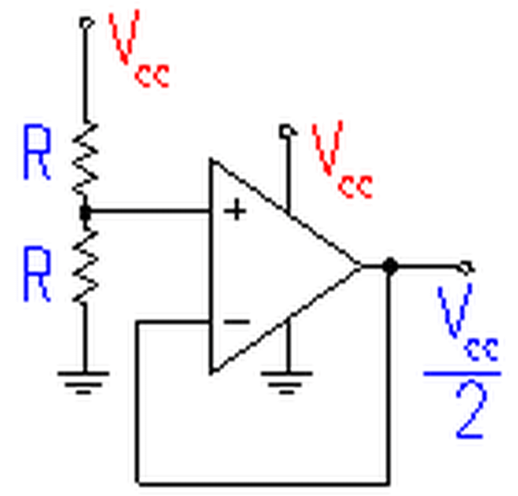

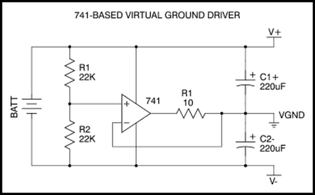

Here is a page that explains the technique I am talking about,
Single Supply Op Amp Design
You can use a high value of resistors to divide your powersupply in half to create your Vref such as 100K to 1 meg each as shown in the schematic.
This will allow a very very minimal amount of extra drain current from the supply.
Since your circuit uses an odd number of opamp's (as drawn) you will have one left over that you can configure the extra one as a unity gain amplifier to feed your virtual ground system with a low impedance Source/sink Vref.
You can/may have to add a small decoupling capacitor in parallel with the bottom resistor to help with noise.
But this circuit will only draw as much current as needed be by the demand of the virtual grounded components with the exception of whatever the Idle current of the opamp stage is at about 1.4ma.
Else you would be have to be drawing an extra 5ma or so if not more all of the time using just resistors for or Vref bias circuit.
As two 1K's in series would make a constant 9ma of current draw were the Opamp will supply that only if it is needed.
And will be only for short intervals on very high peaks of signal swing when needed.
This also solves the common mode issue I described earlier as the battery voltage starts to droop. 😉
The second picture shows a 741 but any opamp you are using will work the same.
You don't need the resistor unless the opamp shows some sort of instability.
jer 🙂
i don´t understand every bit of this.
-odd number of opamps
-> i have also a few tl071 in stock
-extra one as a unity gain amplifier to feed your virtual ground system with a low impedance Source/sink Vref
-> you mean the circuit you have posted?
In the circuit you have posted for one channel, it uses 9 opamp stages this leaves one opamp stage left over assuming you are using a dual opamps.
Else for stereo you can use just a single TL071 for your virtual ground driver if you wish.
jer 🙂
