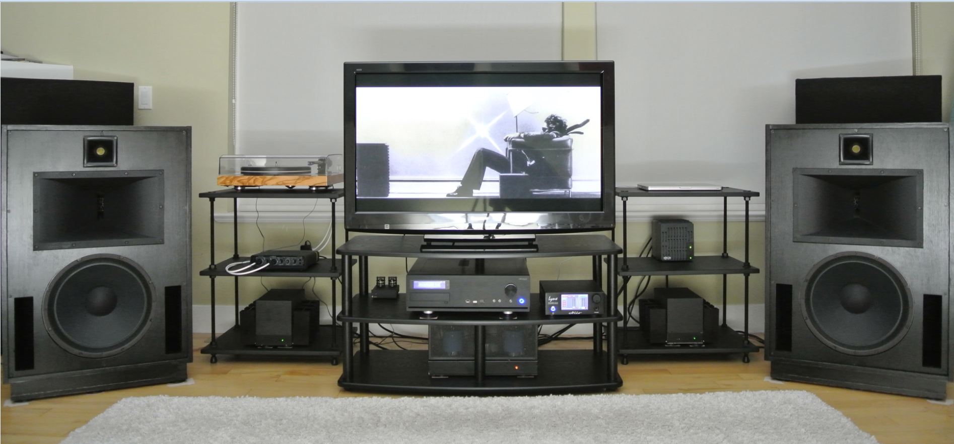

Attached is a (corny) photo of my finished Cornscala's without grills - I do have the grills.

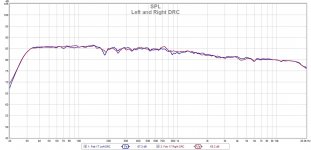

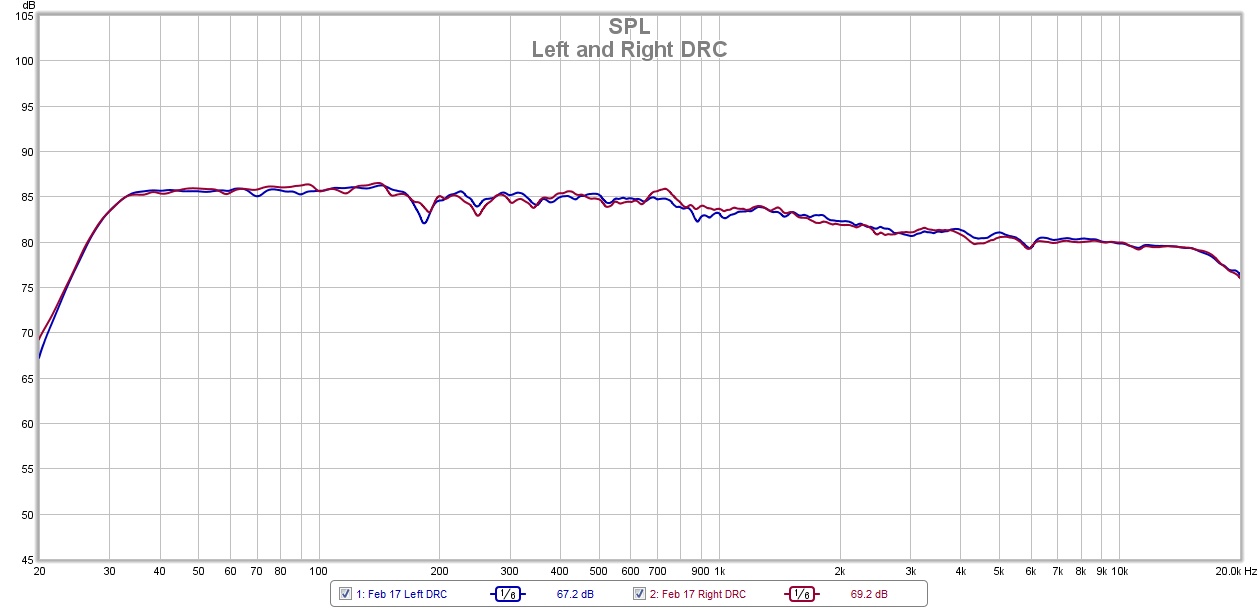

I did a fair bit of research as well, which led me to the Cornscala's. Attached is the frequency response at the listening position
This is using Audiolense Digital Room Correction software. My target response is -3 dB at 32 Hz, flat to and hinge at 1 kHz, with a straight line to -6 dB at 20 kHz.
I am happy with the SQ. The last bit for me is choosing the HF compression driver.
