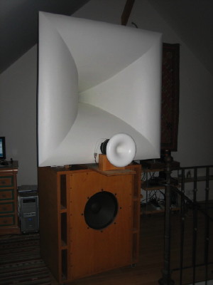

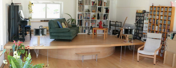

This is overall a pretty good design. (..though the placement in-room is horrible.)
It's a large Iwata flare horn (probably 250 Hz). This is quite a bit different than the Autotech "Iwata" versions with the JMLC revisions. (..less directive than the JMLC versions until the top octave to two octaves depending on the horn size and driver exit size). The super tweeter should dramatically improve on the dispersion aspect in those top two octaves (..but note the problem below).
The midbass bins are likely either 16 ohms in parallel (for the +6 db gain) with baffle step compensation, or it's a ".5" design with the bottom woofer providing baffle step compensation. Figure it's flat in-room to about 50 Hz, with not much spl below 30 Hz. IF correct, it's not a "full range" design - but rather one that needs some subwoofers. IF it extends lower in freq. then it's trading lower mid-band efficiency for lower freq. extension (..which generally is not a good compromise).
The Iwata lifted up off of the midbass bins is very good (..keeping the horn from coupling to the baffle which reduces general spaciousness and depth in particular).
The only potential problem is with driver offset when comparing acoustic center - most notably with the super tweeter (which in that regard is far to forward of the horn). (..this is NOT a problem with digital delay however.)

Do you know the size of that front loaded horn?
Looking at the photo, hard to tell bu looks like they double the size of my current speakers. seems I wouldn't be allowed to have those babies on he living room.

It is the same size as the salon table, 120cm I guess. And the woofers are big to when they are 15" then it is 35cm diameter.Do you know the size of that front loaded horn?

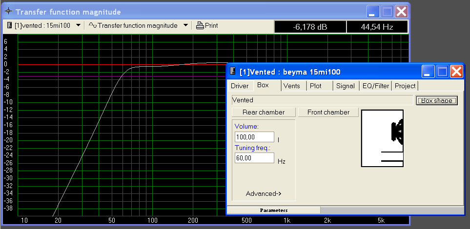

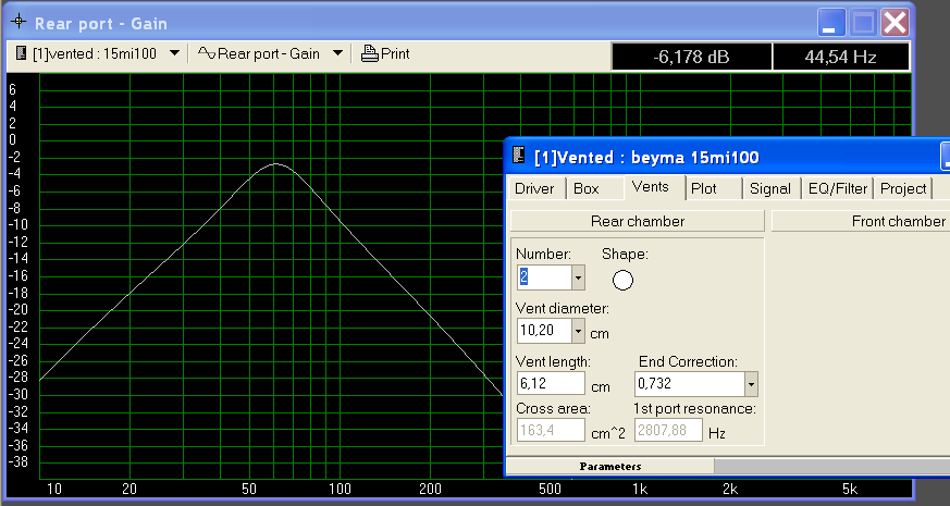

High sensitivity low cutoff <40Hz = big bas reflex box 100-250 liter
Small basreflex box <100liter and High sensitivity = high cutoff frequency >50Hz
A other option as a Basreflex would be tapped horn with small subbas speaker. Onken is also a basreflex tuning.
A very small sub is made with a ripole only efficiency will bee not so high. But the smallest you can build to have high power use two 18".
In one of the first post I did show the 15mb606 100dB 1W and cutoff about 40Hz. That is about the physical limit foor a 15" BR..

Beyma 15MI100 (designed midrange 15") 90liter with stuffing 100dB wmtr. 5W input =107dB max
http://profesional.beyma.com/pdf/15MI100E.pdf

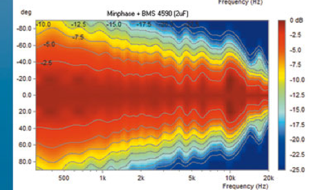

A good horn is short imo. Good dispersion with bms 4590

That horn driver combination has only half the dispersion at 15K as at 1K.A good horn is short imo. Good dispersion with bms 4590
If you consider that good dispersion, what does a bad dispersion look like 😕?
