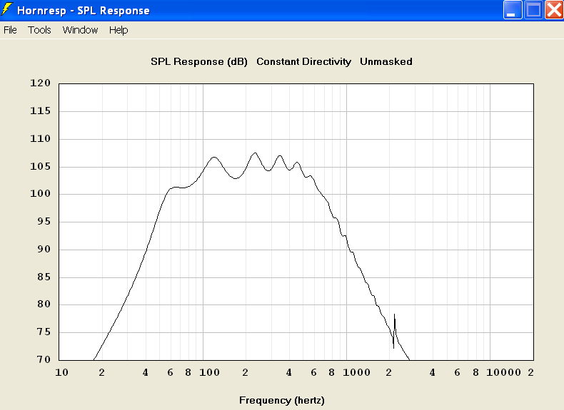

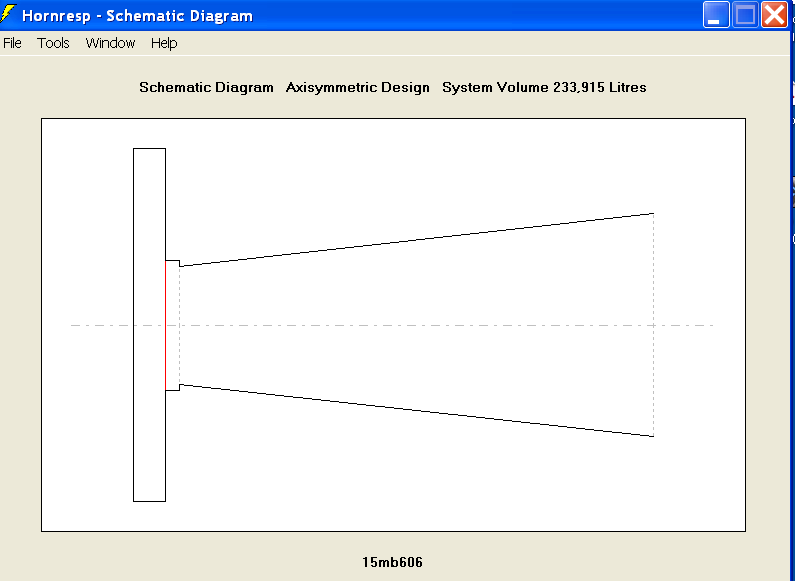

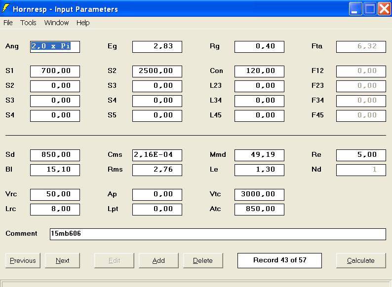

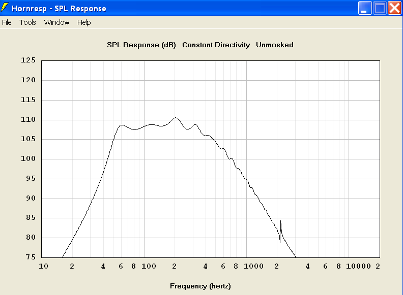

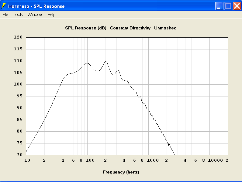

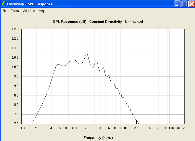

Here a symulation with a closed backside it works fine probably the best solution and most compact.
2pi
1pi
2pi
1pi

2pi with 35 liter backside enclosure to reach more flat response in the 2pi radiation down to 56Hz 104dB 1W meter.
I would tune the raising character down so it the sensitivity raises to lower frequencies.
So maximum spl with 5W 110dB 1meter

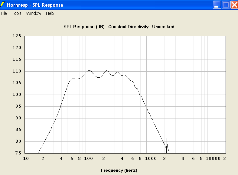

Better closed tuning bigger throat area.

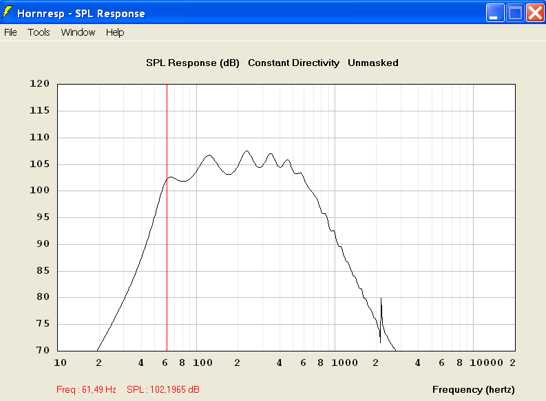

2pi response. 104dB 1wmtr down to 52 Hz. Build your own low cost la scala with a fine quality 15 driver.

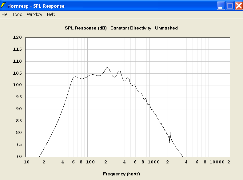

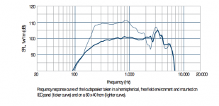

no, 18" is not just 18"
I havent heard it, but quite sure the 18" Faital 18FH500 have better midrange
and there may be others
but ofcourse big woofers with nice midrange are not many 😛
normally a woofer with better midrange would be 15"

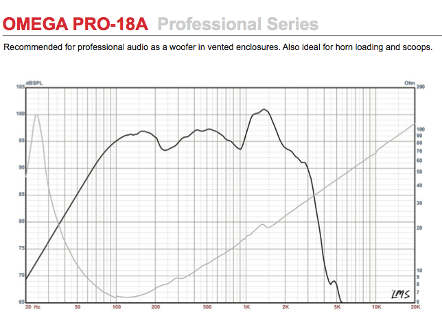

2) Using first order crossovers, the six dB peak the Eminence Omega 18a has around 1500 Hz would be clearly audible.
If you are using only a coil for a crossover, the peaky response might actually be worse than it looks on the graph.
There are some 18" that sound OK in the midrange, but most good two way designs use 15" cones, as an 18" beams at a lower frequency than a 15", requiring a crossover too low for a 1.75" diaphragm driver to sound good.

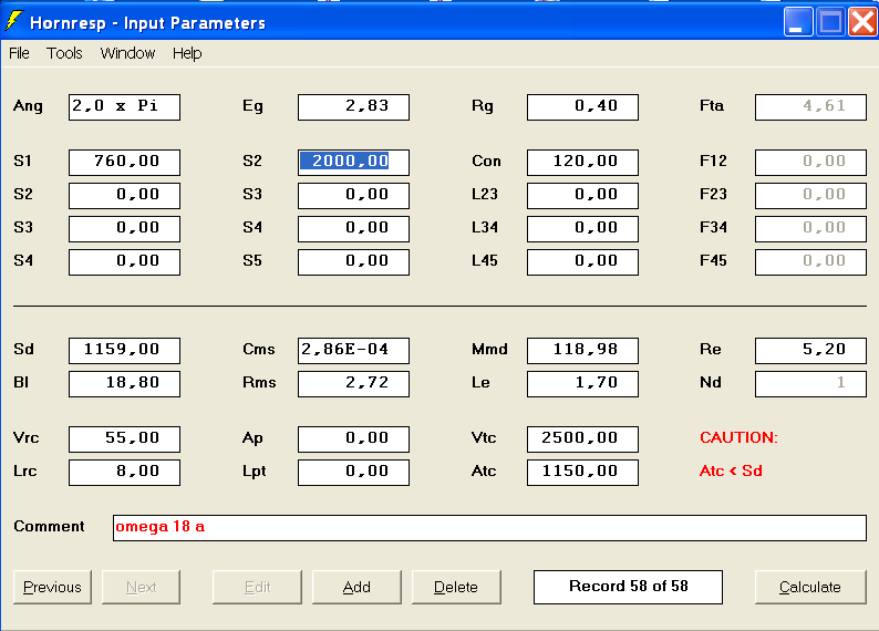

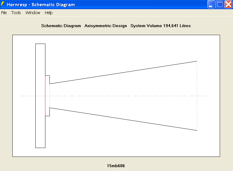

High efficient sub with omega 18A 3way 100dB system
This will make filtering much easier normal second order 3 way. XO 250Hz and 1500Hz. The mid range and seos wave guide will make a very small monitor speaker and a big frontloaded horn sub.
101dB in 2pi down to -3dB 45Hz!
This is great to combine with a dedicated high efficient midrange.

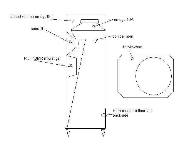

Design of the box 101dB 45-20000Hz 2pi. I call it " The super la scala ".
Filter idea for sub 1 order low 100Hz
Midrange 1 order high 200Hz and second order low 1000Hz
High second order high 1000Hz

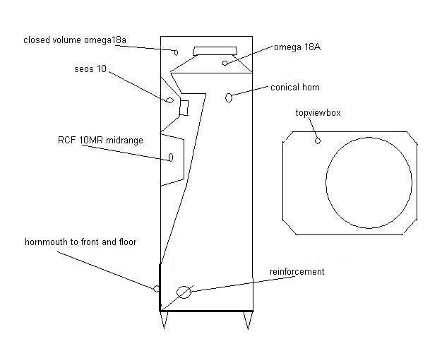

How to hide a mega front horn.
A 1,4 meter high front horn 45cmX55cm. With midrange and seos 10 wave guide. Closed volume omega18 must be reduced to 55 liter.
Horn mouth to the front it will help to reach the 1,2 meter horn length easier.

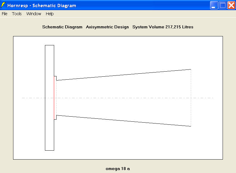

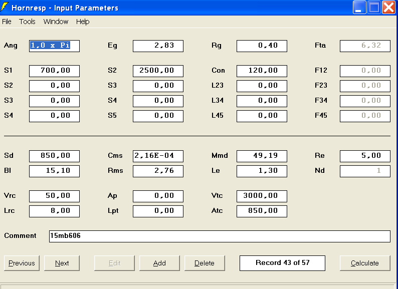

1pi output of the mega sub front horn. with the first order 100hz filter it will make 106dB 1 meter! -3dB 40Hz! 102dB. That is the output box placed near backwall.
With a 5W amplifier this will make a mighty 112dB at 1 meter.

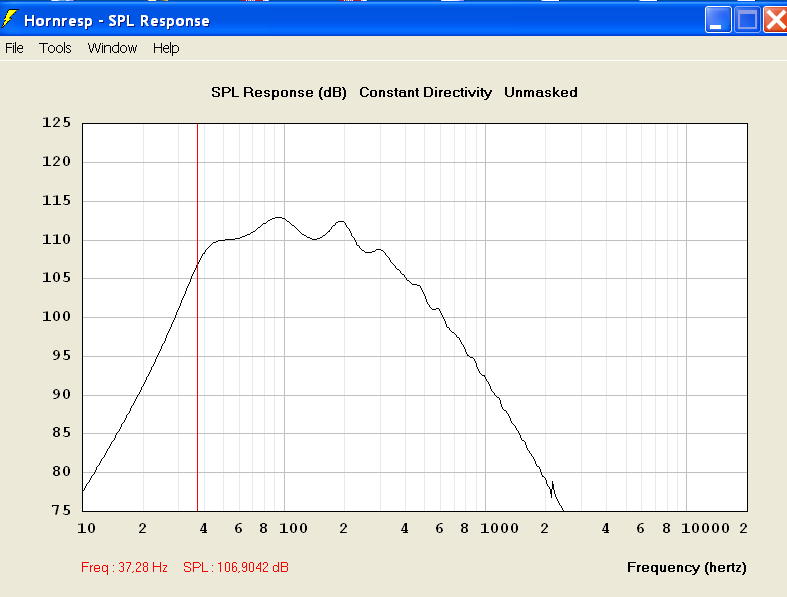

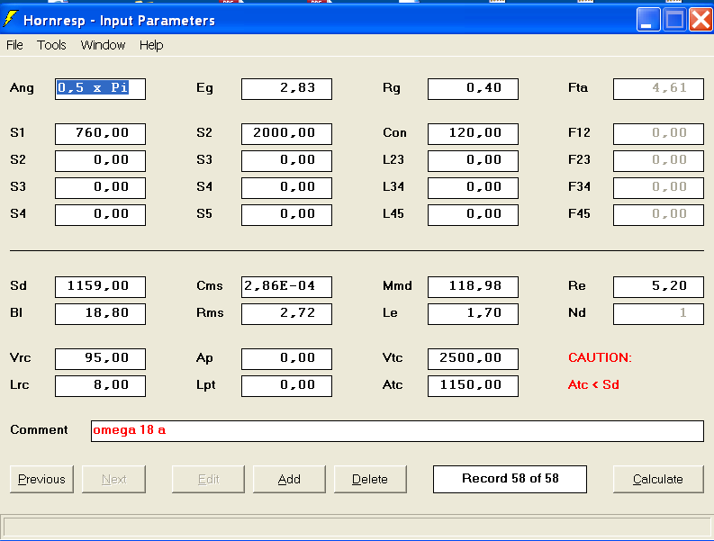

Omega 18A sub horn placed in the corner ½ pi. With first order low filter 110dB -3dB 37Hz 1 meter. -10dB 30Hz 100dB 1Wmtr Like?
When you build the front horn like I did design, the corner placement is easy.
??looks clever Helmuth, but make it twice as big(wider) 😀
Then it will not meet the simulation.
Horn mouth 2000 square cm = 45X45 cm, it is a smart horn design with low horn coloration and very high efficiency and relative compact. And without a faulty super tweeter.
Who does better? -3dB 37Hz and 110dB 1wmtr.
Even the wood work will be easy witch ads to be a smart design.
