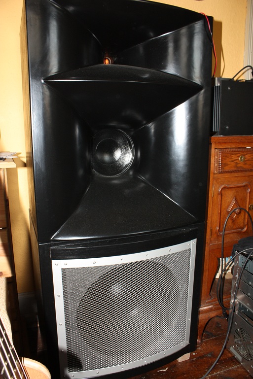

I built this for my bass
I have no idea what the heck Im doing, but I think it at least looks ok
and since its only for bass guitar, it probably already too good for that
whatever, just an experiment I wanted to try
but maybe imagine the mid horn could be a big tweeter horn instead 😉

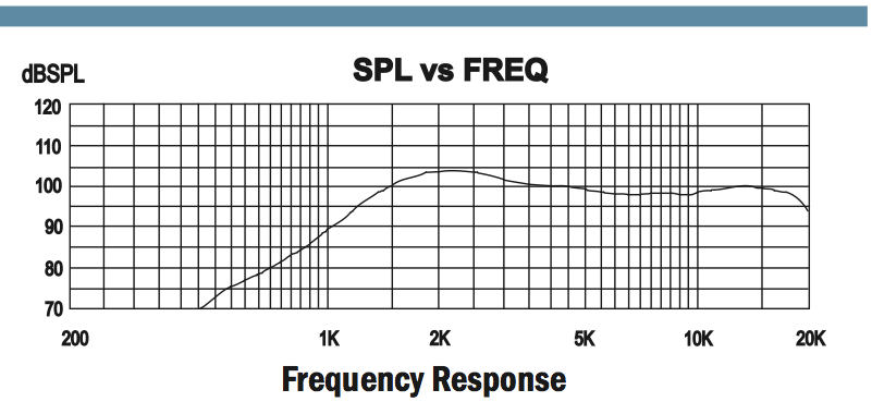

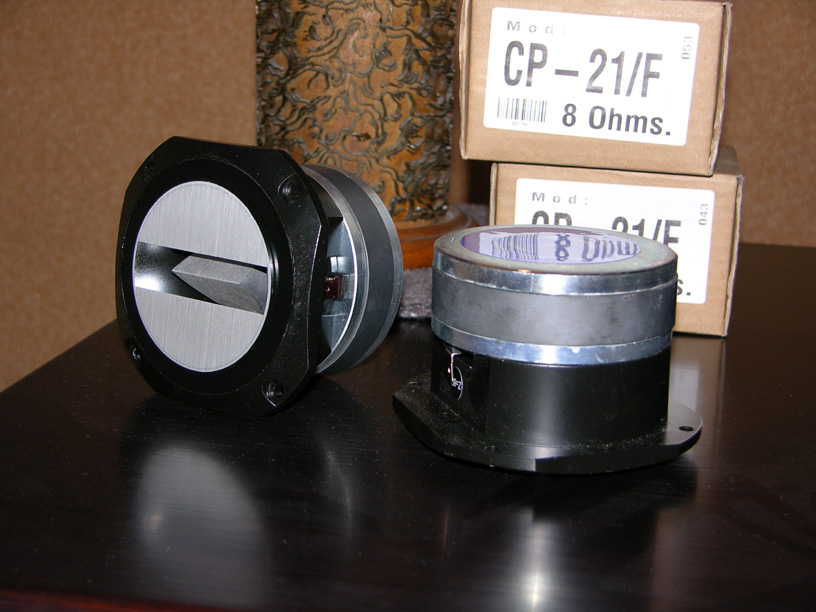

To make a everest copy.
You can look on ebay or so for a 2" JBL 2380A biradial horn.
http://www.fullcompass.com/common/files/7942-2380a.pdf
A altenative for a jbl 2405 slotted tweeter.
http://profesional.beyma.com/ingles/pdf/CP21F.pdf
http://www.bcspeakers.com/CPD/product_pdf.php?id=0000000037
Or this horn tweeter.
http://profesional.beyma.com/ingles/pdf/CP25.pdf

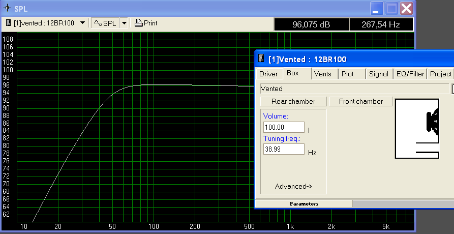

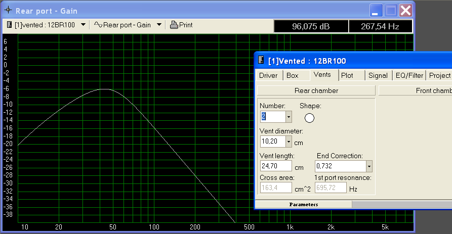

nice studio woofer to make jbl everest 55000dd double woofer look.
http://profesional.beyma.com/pdf/12B100-RE.pdf
Beyma Speakers - Beyma 12B100R speaker - Beyma 12B100R 300 watt 12" woofer for all hi-fi and studio monitor bass speakers. Beyma 12B100R and other Beyma 12" speakers here.
simulation of two drivers in one box.
