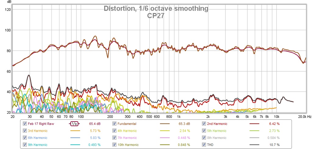

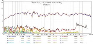

Hi Helmuth, I think Mr. Crites makes some pretty good xovers with Sonicaps... Or at least in my research, I have not come across anyone complaining about them.

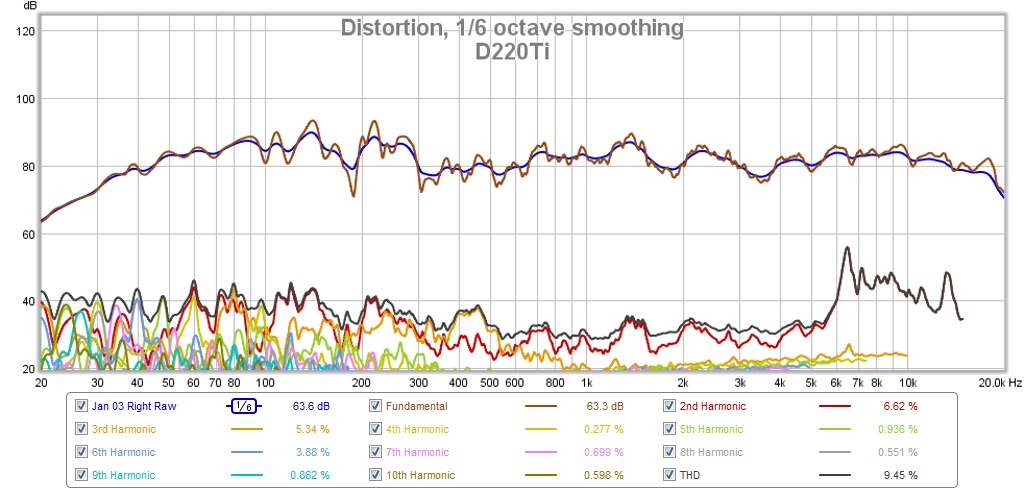

My comment is based on the 1" Selenium D220Ti, which sounds harsh to my ears and measures higher distortion than the CP27 driver that I just put in my system and changed nothing else.
Attached are two distortion measurements with the only change being the 1" compression drivers. As mentioned, they xover at 5 kHz. There is a big rise in distortion at 6 kHz on the D220Ti compared to the CP27. It is quite audible.
Maybe I got a bad batch of 220Ti, or this is the way they are, I don't know...
I am looking forward to installing the BMS 4540ND to see what they sound like and measure.
Cheers!
When they distort the cause is clear
Cheers!

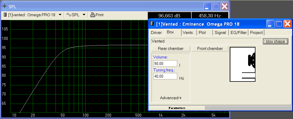

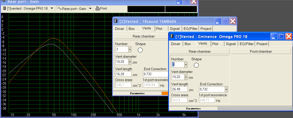

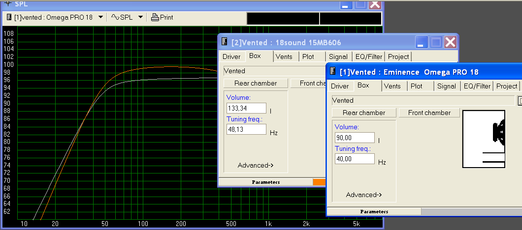

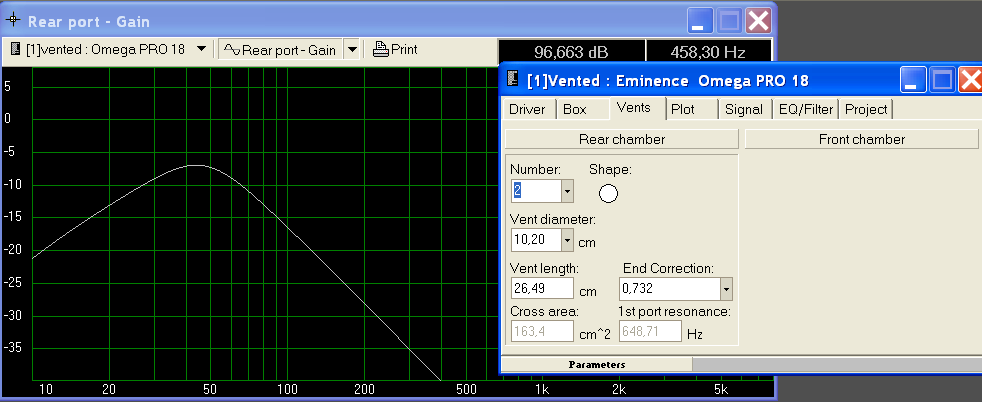

1. Use my Eminence Omega 18A Pro in a Bass reflex config. front vented.
2. Put the horns outside the enclosure, probably this reduces coupling, but in really I think it will look better and can make it modular, so will be easier to change components.
3. I will look for the tweeter later, It could be the 2405.
4. So the Job now is to define what wooden horn and what compression driver should I use.
Note1: Eminence Omega 18A pro, doesnt have 100db. And my understanding is that a BR only will give more bass extension. At the moment I will think on attenuating more the highs, until I get a better bass. But I still would like to think in options for the bass, to start planning ahead.
Note2: I have a pair of 41hz SS 20W and 100W amplifier, another option would be use that for the woofer. I m just afraid of loosing phase integrity when using two amplifiers.
Please let me know any concerns about this thinking.

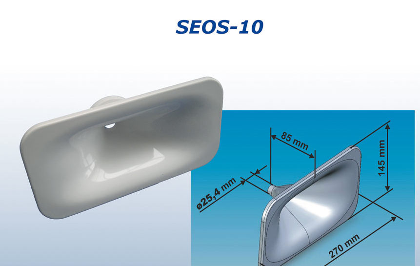

I meant a tweeter horn
one of the smaller lecleach look real good
and the cheapest Faital Pro 1" CD is very good

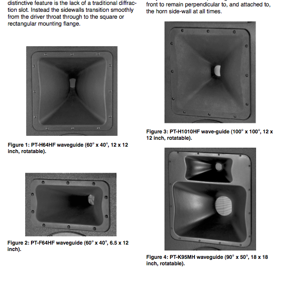

I recommend flat/shallow waveguide
much less complicated
your worst problem with a big midrange horn might be smooth transistion to the tweeter horn
you need something that matches in size and shape, and should look like they belong together

pick your tweeter horn(anyone you like)
and then build a simple wooden waveguide for the Beta8 or whatever driver, so that its magnet alligns with tweeter horn throat(approxiametly)
and you have something to play with for while 😉
Yep, I know I am difficult and going around circles, but I am really biased towards a Bin Bass (Bass reflex for instance) and a Horn that can do all the work.
Helmuth proposed that at the start of the tread, but then I started arguying about highs dispersion. and we started adding more drivers.
When I talked about JBL 2405, to improve dispersion, we start talking about combing filtering.
I like the original 2 way proposal. And if I want to add a tweeter later, seems like combing filtering shouldnt be an issue at arround 10khz.
For me, adding a paralel tweeter with a cap, doesn't look like adding another way to the XO....
The other important thing to remember is that I need speakers for a 71A tube amplifier, that is 0.7W rms.
So I need >100db of sensitivity.
I think I can start experimenting with my current OB bass bin (Omega18) and change that later.
I will use my DAC and a small SS to power the bass.
That will give 0.7W for Mid and Bass.
So I should be basicallly looking just for a good Mid/High Horn that can matches a 15inch/18inch driver.
And also, a nice waveguide for this.

A front-loaded bas horn like la scala will make 100-106dB 1wmtr possible and even 110dB in a corner that even with your current omega 18 that does surprisingly well in the simulation. Will make it hard to go 2 way it will become a 3 Way.
