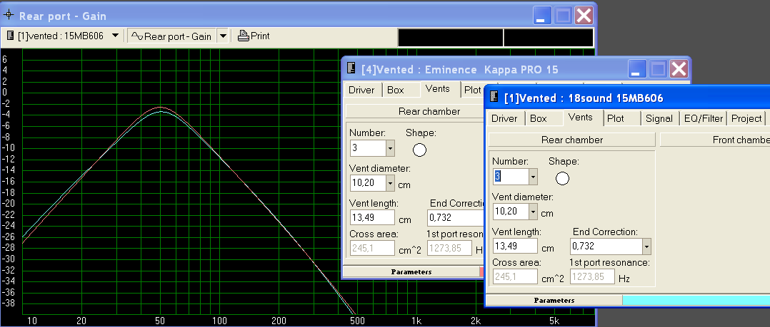

Basreflex Eminence kappapro 15A 160,-
99-100dB 1wmtr
Eminence Kappa Pro-15A 15" Cast Frame Driver 290-422
Speaker Detail | Eminence Speaker

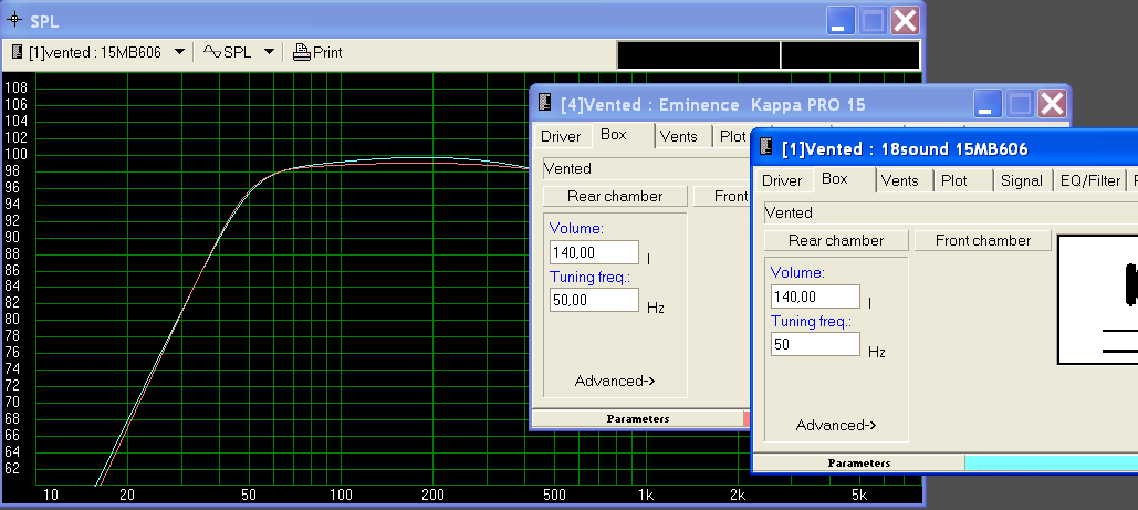

Here simulation compared to the 18sound 15mb606 about exact the same drivers for what data is concerned. The eminence will have a better price performance.
So how about this woofer Charley 140liter =120liter with stuffing. Box inside about 40cm X 45cm X 70cm.
$160,- piece. 40Hz -3dB!
$340,- left for horn and HF driver.
There are not to many real 100dB woofers most have a 100db peak at 1kHz and are sold as 100dB woofers.
Note: rear-port gain ads to the direct radiating cone response.

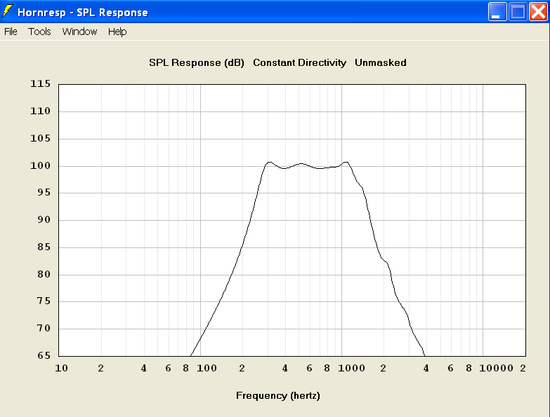

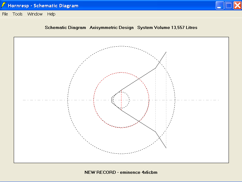

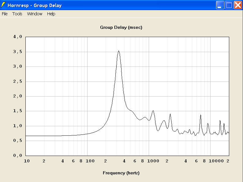

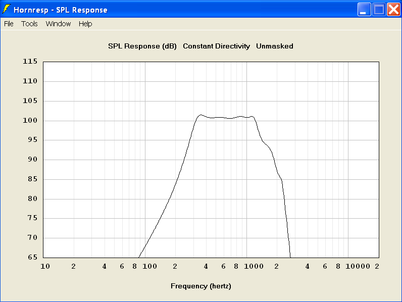

The mids need to be modeled as offset drivers, your schematic isn't showing that.......
Yes I know I did not know how, due your commend I know. "OD"😀
Response 4pi
