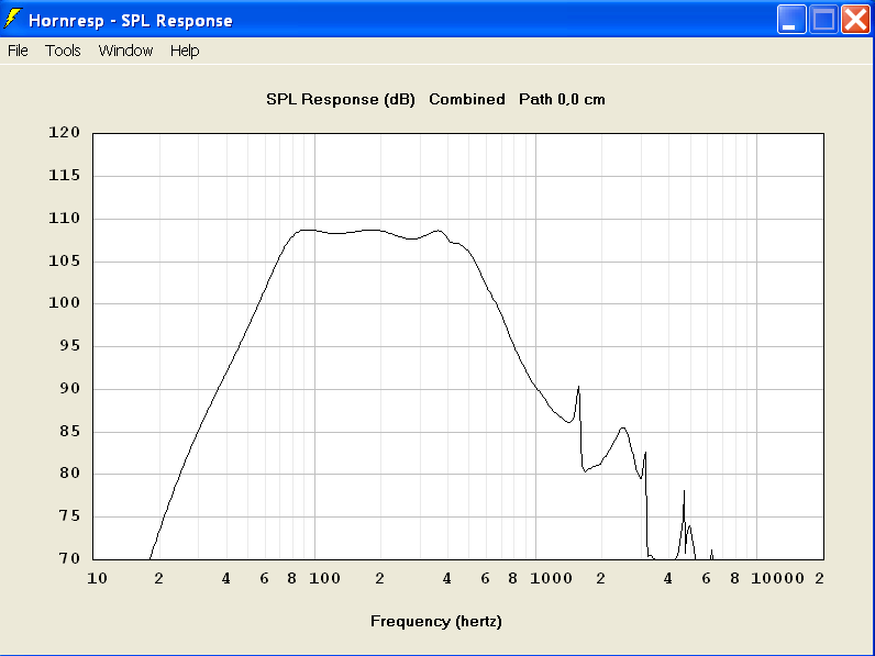

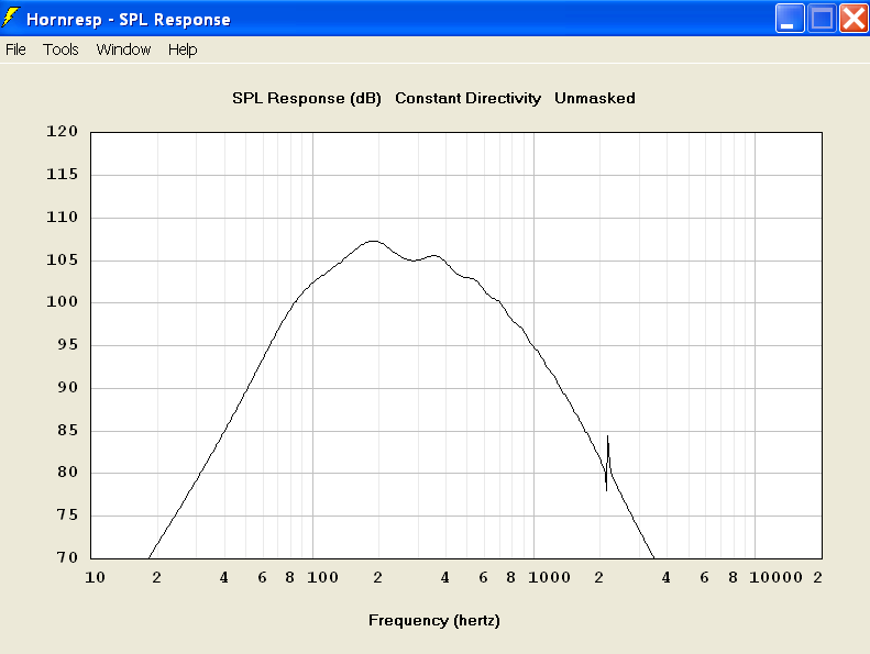

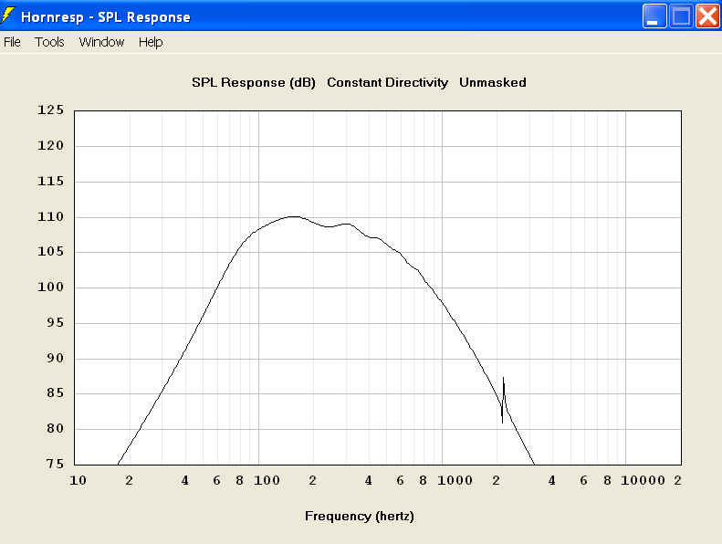

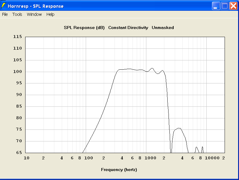

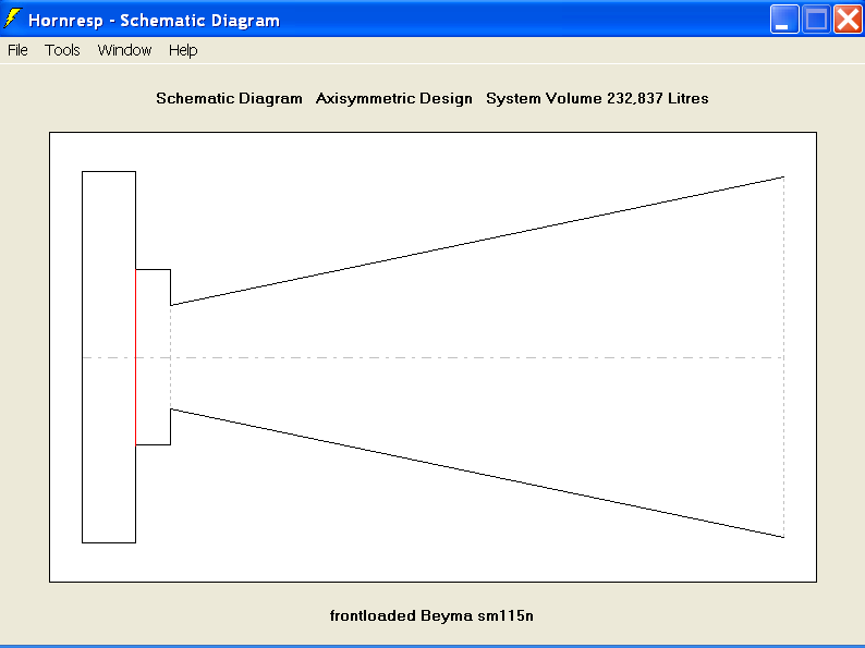

Design: Horn High Sensitivity Speakers

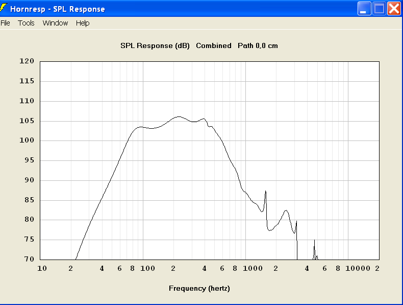

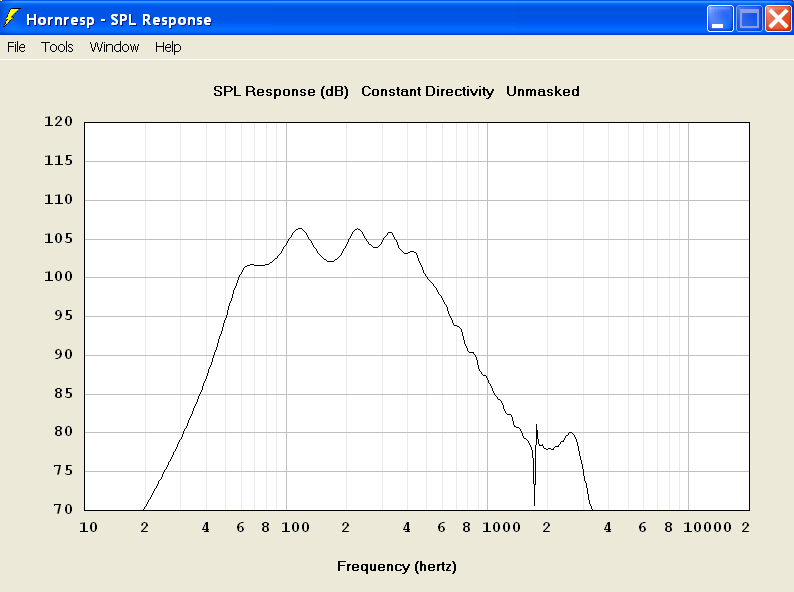

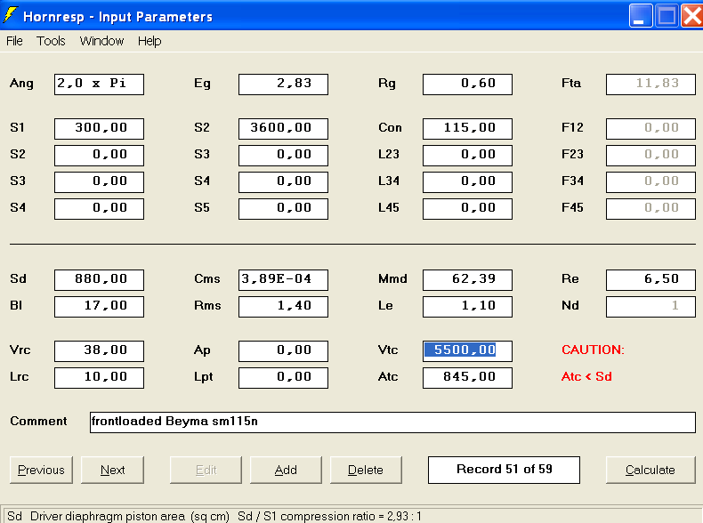

Frontloaded bas horn. lowcost. beyma sm115n
2pi halfspace. 103dB 1Wmtr
Inside size 40X50X120cm.

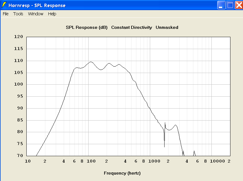

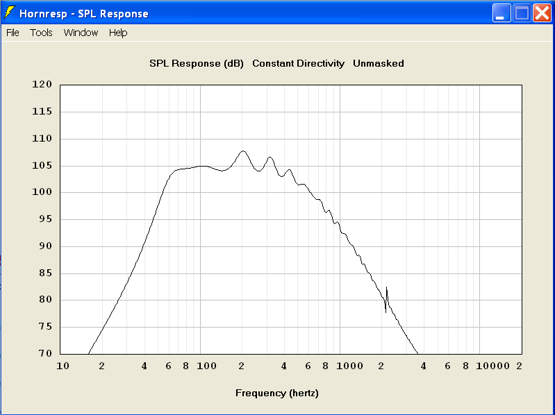

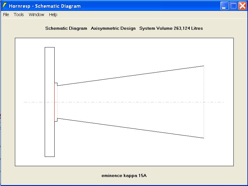

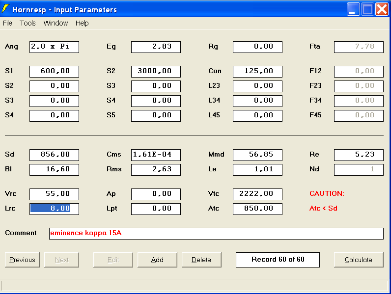

To reduce volume of the box here with short midrange horn on the eminence kappapro15A.
system volume 124liter.
Spl for 2pi and second 1pi.

the kappapro is a nice driver to play with in simulation, now made a simple conical horn on it with bas-reflex loading.
to make some thing like these.
attachment.php
images
images

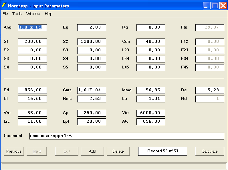

SPL output for 2pi and 1pi placement 1pi. And reasonable size 128 liter 4,5 cubic feet.
Combined response port next to horn mouth.

why vented BR if it still needs a sub ?
To increase efficiency and bandwith. 105 dB 1wmtr 1 driver is very nice. 20% efficiency if i am not mistaken. A hifi speaker can not even make a 0,5% efficiency.
It wil make a perfect high efficient 2 way with a midhigh horn 500Hz-20kHz where time alignment is right.
It is not to bulky big can look very good with a tractrix horn on top.
Now only a tapped sub horn is needed.
wouldn't closed/apperiodic make integration with a sub easier ?
I believe I already showed that solution.

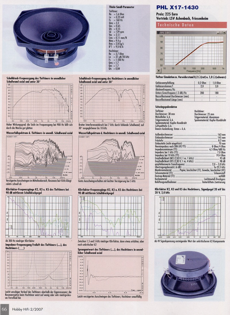

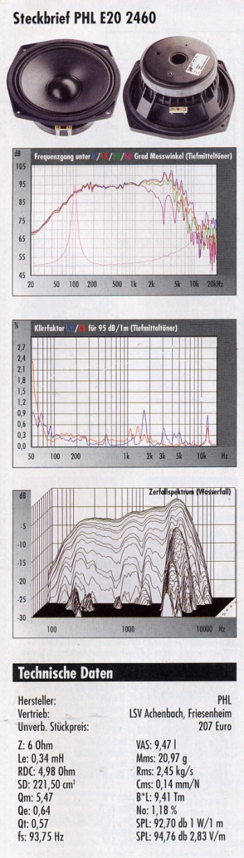

It's a shame PHL never publish any graphs of their drivers. I mean, look at their datasheets layout they even have an empty place for the graph but they dont publish ! 😀
I think they have lost many DIYers buying their drivers because of this.
- Elias
Your right elias.

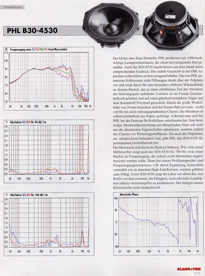

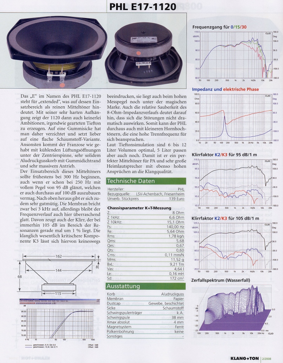

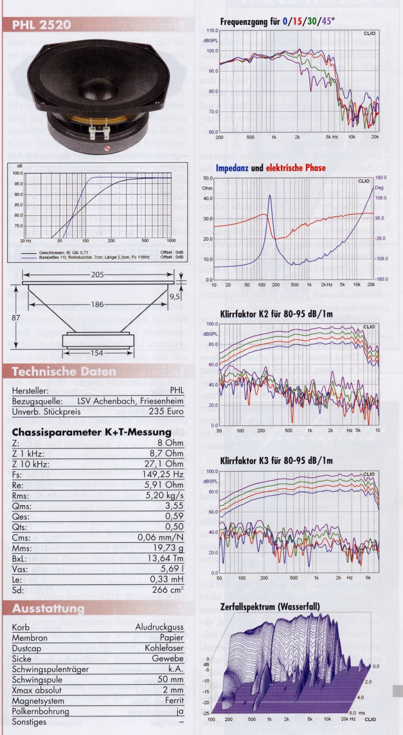

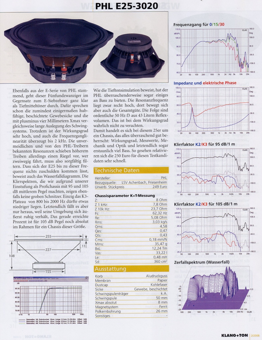

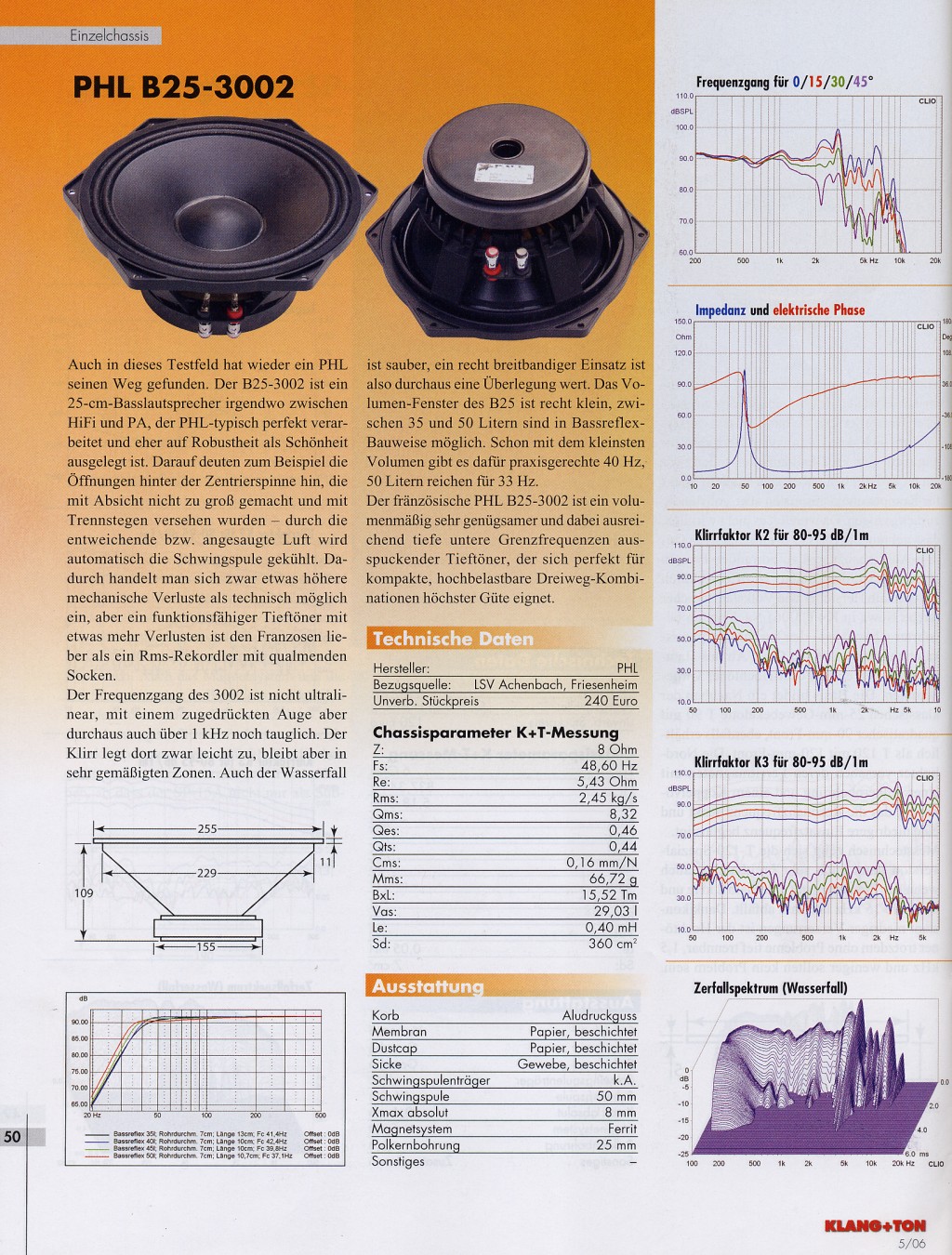

PHL drivers.
