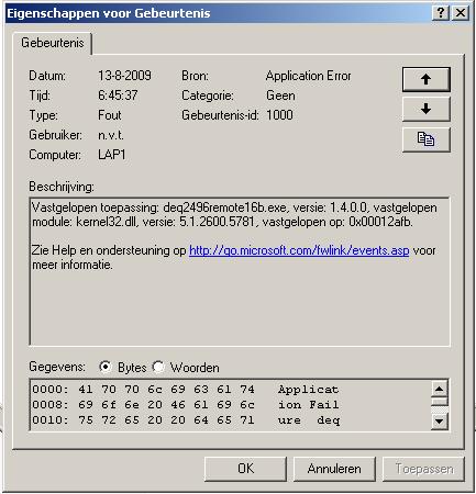

Thanks for your quick reply. Seems nothing special to get it running..
I use a USB to MIDI converter; it is recognised as a "samengesteld USB apparaat" and it functions well in combination with MIDI-OX for firmware update to the BERINGER
When I do a search with the remote software I get this (see: 6724_appcompat.txt).
When I also chose to log MIDI, I get this (DEQ remote.jpg).
Does this give you any clue ? Your help is much appreciated.
Grtz !

My DEQ2496 firmware is version 2.4. On DEQ2496 utiity menu 2 midi setup, I set them all 'ON'. On Seoman's remote control program, click 'midisettings' and if your computer can detect your midi interface connecting between DEQ2496 and computer, it should show "device found".

Yes, looks simple...however, not overhere....
I hope Seoman is willing to have a closer look.
