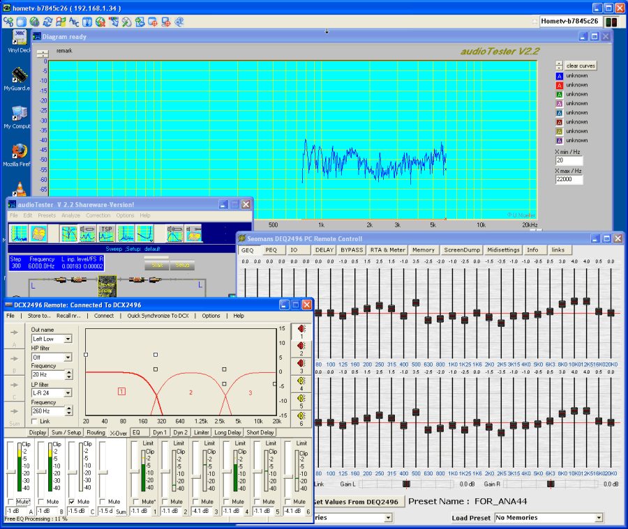

Hard at work
All accessed remotely via VNC so I can take control from my laptop or relax in another room and only the neighbours have to suffer the test tones 😀
