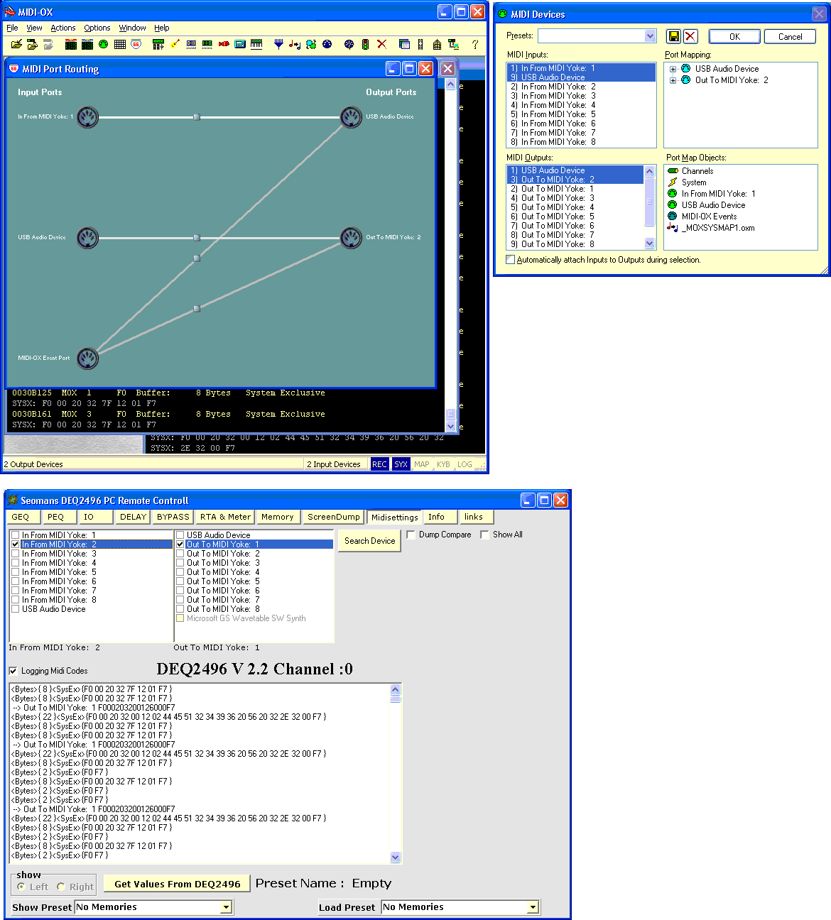

This looks to be an excellent program, very nice interface and just what I'm looking for. Only one problem, I'm struggling to get it working 🙁 As mentioned above there are problems with the latest versions of windows and yes, I have XP sp3.
Undaunted by such trivia I've found ways to manually poke and prod several functions into co-operation. seoman if you are still around you may find the following information useful, please note I've not used MIDI before so some of the following may be the result of my ignorance.
Software:
DEQ2496RemoteNew1.4
Midi-Ox 7.0.0.365
MIDI Yoke NT 1.75
Configuration:
By mapping the MIDI signals through the MIDI Yoke virtual devices I can monitor communications from DEQ2496Remote to see what is going on...
... and manually insert messages to try and get the correct behaviour.
Findings:
All the dynamic information from button presses etc on the Deq appear to work without any problems. The trouble appears to be in the message sent from Remote1.4, eg

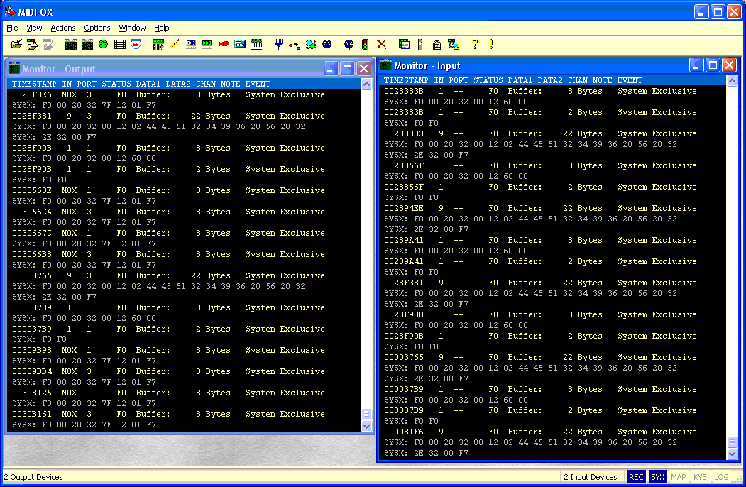

Search device shows
--> Out To MIDI Yoke: 1 F00020327f1201F7
in Remote1.4
In the midi-ox monitor I see
002573E3 1 -- F0 Buffer: 2 Bytes System Exclusive
SYSX: F0 F0
002573E3 1 -- F0 Buffer: 7 Bytes System Exclusive
SYSX: F0 00 20 32 7F 12 01
SYSX: F0 F0
no F7 !

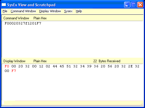

When I manually enter the message F00020327f1201F7 in the SysEx View->Command Window and select Send SysEx I get the following
0059945E MOX 1 F0 Buffer: 8 Bytes System Exclusive
SYSX: F0 00 20 32 7F 12 01 F7
0059949A MOX 3 F0 Buffer: 8 Bytes System Exclusive
... still no reply. But if I Send SysEx a second time
005AC5EA MOX 1 F0 Buffer: 8 Bytes System Exclusive
005AC626 MOX 3 F0 Buffer: 8 Bytes System Exclusive
002A9745 9 3 F0 Buffer: 22 Bytes System Exclusive
SYSX: F0 00 20 32 00 12 02 44 45 51 32 34 39 36 20 56 20 32
SYSX: 2E 32 00 F7
002A9718 1 1 F0 Buffer: 8 Bytes System Exclusive
SYSX: F0 00 20 32 00 12 60 00
002A9718 1 1 F0 Buffer: 2 Bytes System Exclusive
SYSX: F0 F0
... Magic 🙂 This always works on the second attempt, in fact if I send F00020327f1201F7 F00020327f1201F7 , as a single message I get one reply for each send.

... sending the message F0002032001276F7 manually does not always work on the first attempt but sending it a second time appears to be successful - in the last test I just tried it took 3 attempts 🙄
Ok, what does all this mean ?
1) I think your program is working mostly as it should but for some reason under XP the last byte you send is going missing, I've seen similar things happen in more general serial communications. A quick and nasty fix would be to send an extra F7 at the end of each message.
2) I have no explanation why it should sometimes take 2 or 3 messages before some data is returned. A fix for this may be to wait 1/2 a second after sending and if no data has been returned then repeat the message. You could maybe repeat this wait and retry the sequence 2 or 3 times before giving up. This is trick that is often used in communications to avoid problems with line noise and other potentially nasty issues.
3) The command Application.ProcessMessages in Delphi can solve a multitude of timing problems.
SYSX: F0 F0
no F7 !
SYSX: 2E 32 00 F7
SYSX: F0 F0
