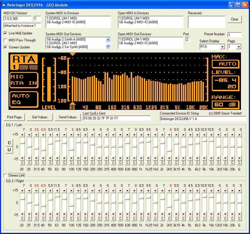

DEQ-2496 Remote
Ha!
just saw this thread
I am doing similar thing in VB6.0
Attached screen dump of work so far (using MIDI-OX as COM interface)
Very Impressed with DEQ2496, have one in the car as an A/D converter, soon getting DCX2496 for active crossover
I wanted to be able to 'tune' the car without getting in/out all the time
