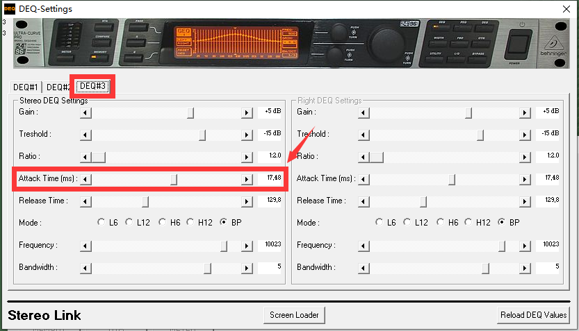

Is it only on DEQ#3 or also in DEQ#1 or #2? Which firrmware is installed in your DEQ2496? Kind regardsThis place is often invalid after I adjust it, but there is no change after reload DEQ values
I verified the problem in Firmware 2.5. It seems to affect ONLY the Stereo-Link Mode (Attack Time/Release Time/Frequency) in Dual Mono everything is working fine. I try to figure out why it is not working. Thanks.Is it only on DEQ#3 or also in DEQ#1 or #2? Which firrmware is installed in your DEQ2496? Kind regards
