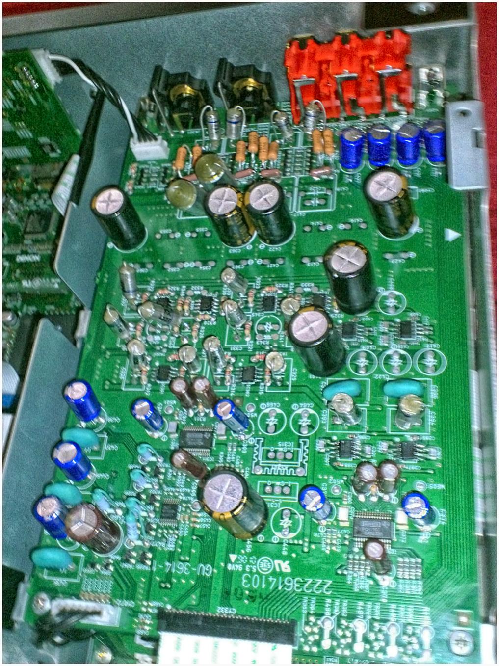

Hi
I am now beginning to plan for the mod of the PSU
Of 3910
I start at the bridge diodes
This model of the diode that is now in the DENON -EM01AT (V1)
I think I will use those what you think
FAIRCHILD SEMICONDUCTOR
RHRP8120
8 A, 1200 V, Hyperfast Diode
DIODE,FAST,8A,1200V,2-TO220AC
More Details

I now begin the design of the PSU
I will use the Monfrad capacitors

This sketch of the PSU
1)
I need a recommendation diodes
Of the diode bridge
D901
D902
D903
D904
2)
I'm looking for a good capacitor
For the PSU
I usually order parts website
FARNELL
And by the way the mod thet i did on audio circuit
He improved the sound significantly
Level not believe it's the same device
I'm a guitarist and I usually listen to rock music
I have a CD of Steve Vai on SACD I'm addicted to it
With mod now he sounds all so realistic that it's scary
Was worth the effort solder 70 parts
And replace 10 OP AMPS
I hope that people here will use list of parts for the mod that I did
Because is improved sound disciplinary

this is the Audio circuit of my finish mod on the dvd denon 3910 😀

I only want it for Analog..I have a blue ray player that I never use..Andy Griffith,Gunsmoke,Bonanza,and Sponge Bob are not on blue ray lol.
Can you get me the model from there
I order parts from website
FARNELL
Cannot find it at Farnell's
LQA08TC600 Power Integrations | 596-1372-5-ND | DigiKey
You need 600V
Amperage depends on inrush current. Maybe 8A is a bit to much. Maybe you want to change the first capacitor behind the diode and change inrush current.
You need 600V
You need 600V
